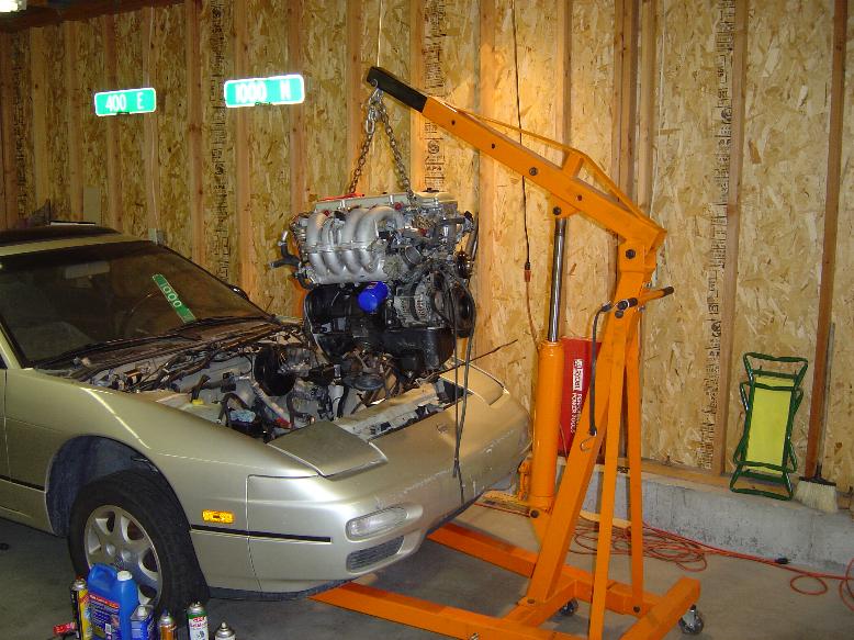

Now... the tranny is still in the car. Do I pull it, attach it to the engine, and slide both back in at the same time? Or do I pull the tranny & man handle it onto the block from under the car?
Yes... I know I need to pull the tranny. The debate is:
Mount the tranny to the engine & drop them both in from the engine bay?
or
Drop in the engine & man handle the tranny onto the engine from under the car?
I usually install the tranny under the car, after the engine is in, but I'm thinking I might try shoe horning them both in from the top.

i say leave the tranny in and jack the bell housing up to angle it with the engine when you lower the engine in the car.. its not that hard to do.. thats how ive always done it....

ya, I didn't remove the tranny in my Z when I swapped in the turbo engine. I installed it by myself.
If you have a leveler on the engine hoist then its easy to work the tranny and engine combo into the car... .well, and the L28 is quite a bit longer so in that case it makes a big difference.

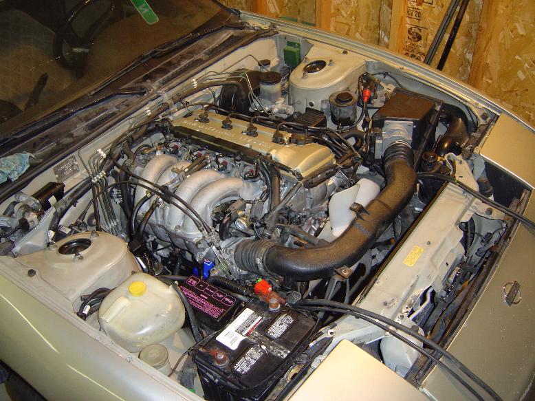

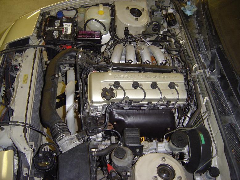

Attached Thumbnails Today's Project: 240sx-dsc00260.jpg   Today's Project: 240sx-dsc00261.jpg

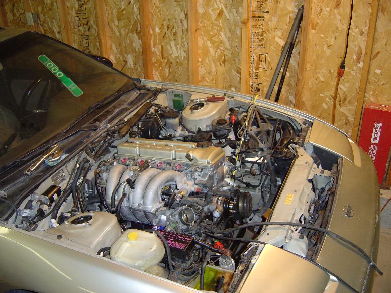

Old Oct 9, 2006 | 09:15 PM
  #33
OVERHAUL 99% complete

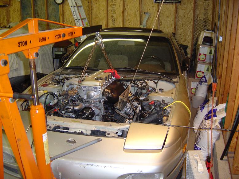

Day 9: Engine dropped in & bolted down... took 3 friggin hours to get the tranny splines into the clutch! I was beginning to think it would have been easier to pull the tranny, but like Bleach & Ice said to do, I left it in & mated the engine to it.
Day 10: Filled w/ oil, re-connected wiring harness, and started her up! No radiator yet... just a test fire. Here's a 2.79MB vid of the virgin starting: (RIGHT CLICK & SAVE AS) http://nismopick.define-touge.net/files/240sx.mpg
Just gotta drop in the radiator & wa-la!
Attached Thumbnails Today's Project: 240sx-dsc07702.jpg   Today's Project: 240sx-dsc07704.jpg   Today's Project: 240sx-dsc07705.jpg   Today's Project: 240sx-dsc07708.jpg   Today's Project: 240sx-dsc07709.jpg

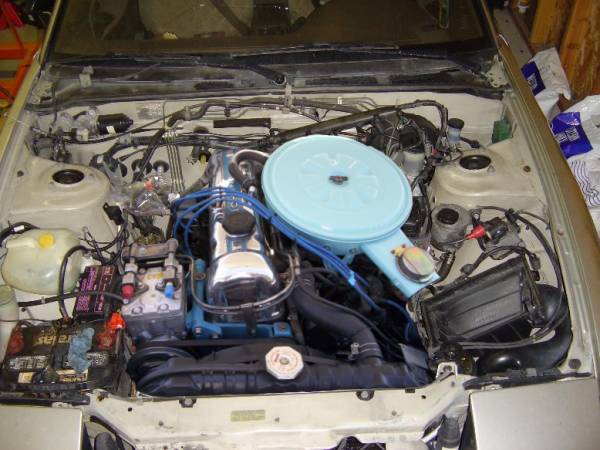

Ok Mr. Pick, while you were at work I went ahead and installed an L20b like I had suggested. Your bro will be so happy with that 94hp carbed engine. I'll put the KA to good use.
Attached Thumbnails Today's Project: 240sx-240sxenginebay.jpg
Old Oct 10, 2006 | 11:53 AM
  #38
Oh man! That engine looks much better! Who needs fuel injection anyway!
