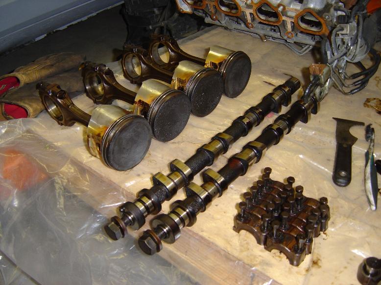

Day two & three... dismantling of the engine. Oil pan is off... no apparent damage to any of the rods. Timing cover is next.

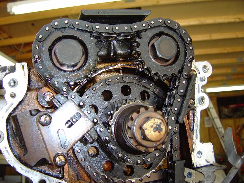

Day four... (I've attached today's pics so this thread doesn't become a mile long)
Timing cover off... Top "cam chain" is loose & the exhaust cam appears to be one tooth off???

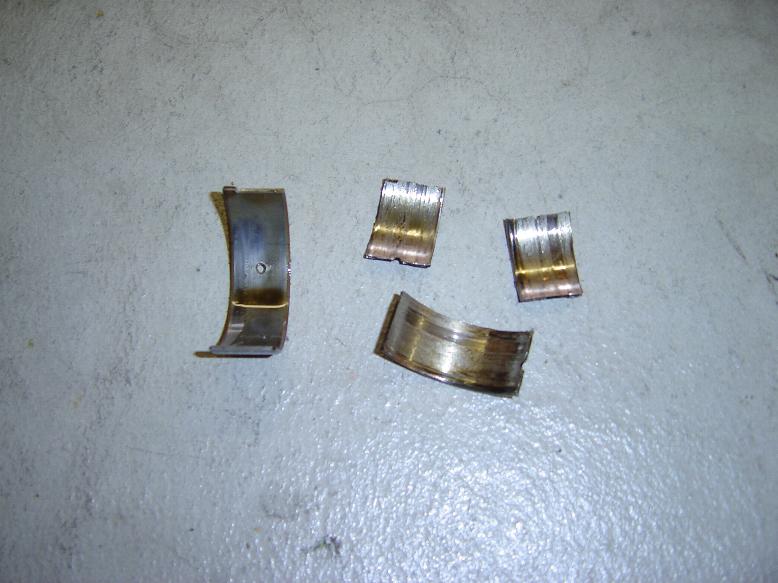

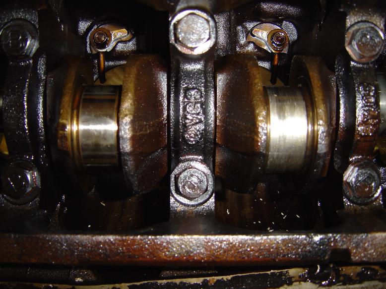

So... I continue on thinking the timing chain was flopping around causing the noise. Loosen the rod caps & remove pistons out the top. Removing piston #2 I find a wonderful surprise... A spun/broken rod bearing & crank journal scratched to hell.
Next step... trip to the machine shop.

so it looks like you are going to need an oversized bearing. and possibly a nother crank. My recomendation.
get a nother block that is not scored or scratched (cylinder walls and Journals) get a hold of another crank (I think my friend has one) replace all Bearings, Rod Bearings, Piston RIngs, Get a metal Head gasket, and have intake manifold along with the block Dipped in that acid tank (cleans out all carbon/ sludge deposits on all cambers) after everithing has been carefully inspected and Honed N polished to specs Put it all back together (with all new gaskets ofcourse). KA is supper easy you can't Mess up like SR20 or RB25 everithing comes with a mark from factory. so the re asembly should be straight forward. and should only take 4 hours if done carefully. there are 3 options for pistons too. you can get Single cam Pistons to Up the compression (N/A power) but you need them to get milled a little bit for valve clearance. OEM pistons cleaned and coated if keeping it stock for DD. or Get Some Wiseco or CP pistons for Turbo. the option is yours.

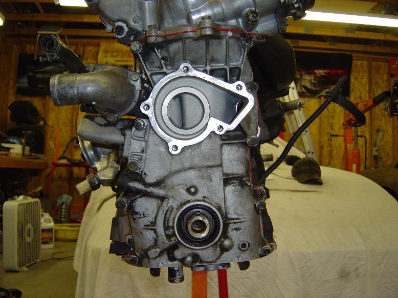

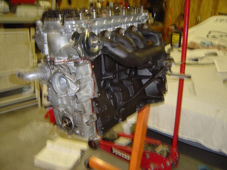

Old Sep 30, 2006 | 09:53 PM

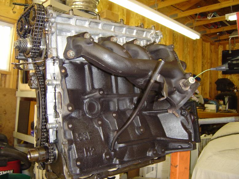

Day six & seven... (pics of day five on another camera)

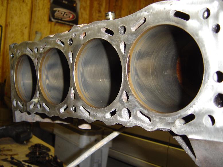

Block back from the shop (I'll post fresh block pics later).

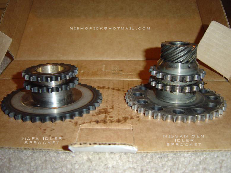

Found out that every parts supplier is STUPID. Napa sells a KA24DE timing chain set for $309... FOR THE ALTIMA, which doesn't have the distrib in the same spot, so the idler pulley is different. Napa doesn't have a 240sx timing chain kit. AutoZone wants $460 for theirs, and Nissan wants $600. Whad I do? Bought one on ebay for $155 shipped. Made by "ITM Engine Components" it's supposedly a good aftermarket.
So today... I'm installing the timing chain kit, and open my engine gasket kit to install timing chain cover... NO TIMING COVER GASKETS. Call AutoZone: "Oh yeah... $9.99 and we can have it from our main store in 2 hours." Go pick it up... They ordered a crank pulley seal. MORONS. Turns out AutoZone doesn't have timing cover gaskets for the 240sx in their computer system. Screw them & go to NAPA... NOPE.... Napa's computer says to use silicone! Nissan parts now closed for the weekend. F*ck that... Go home and silicone the cover on.
[/rant]
Here's some pics.

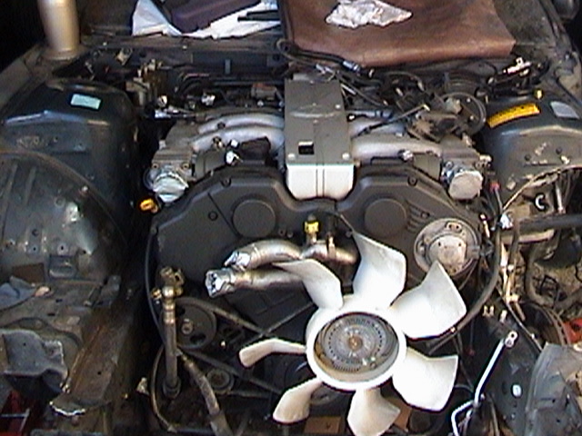

Here's a pic of my mod motor. Or maybe for sale. I want to put her in a little nissan hardbody truck. Or similiar.

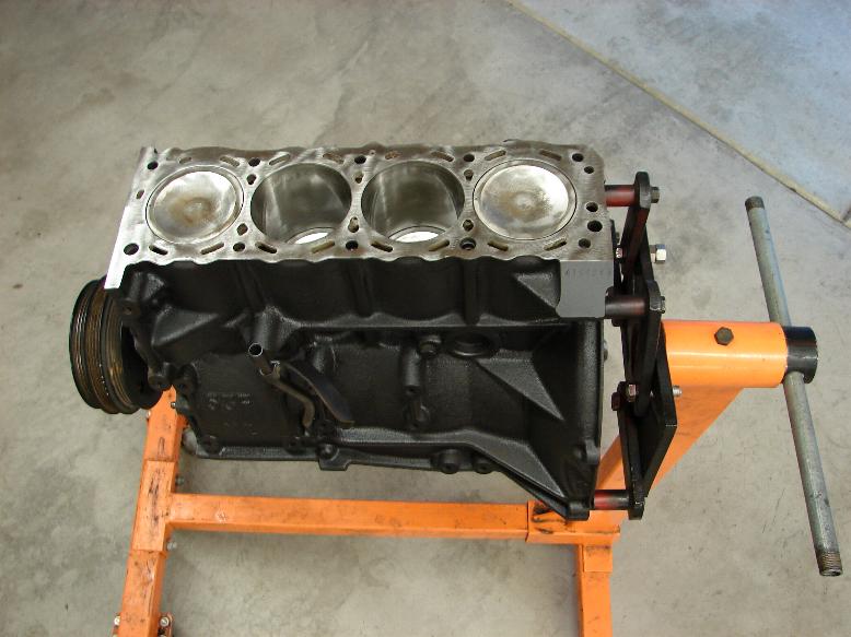

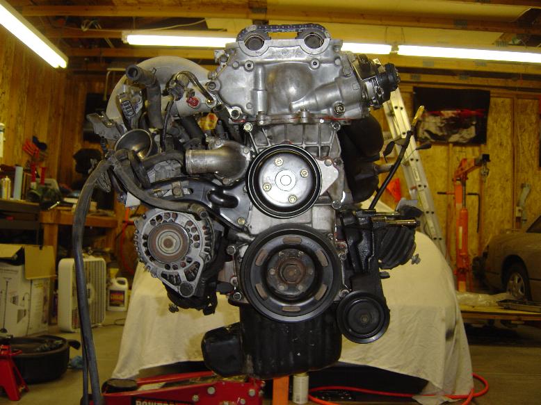

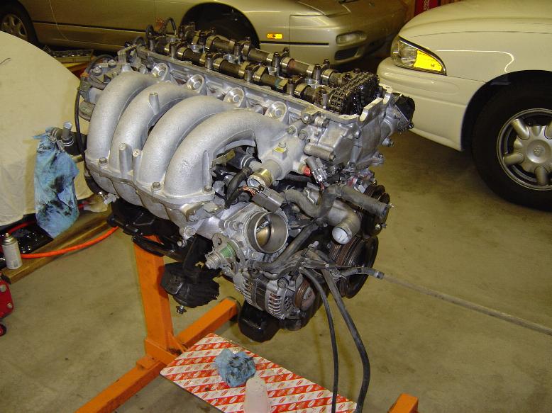

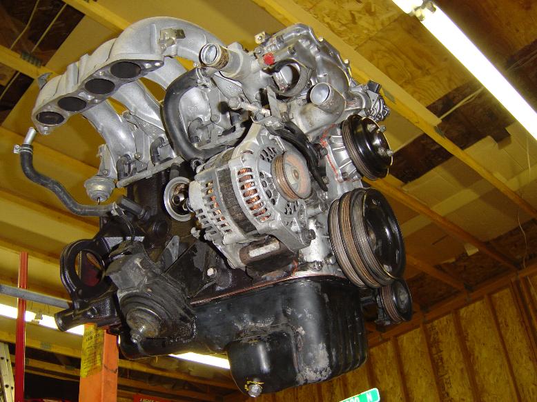

What day is it? Oh yeah... Day 8 of the project. I guess I'm just counting for my own sake... These are 4 hour days that I'm putting into this project.
Today I got all the accessories hooked back up... intake manifold back on.
Now... the tranny is still in the car. Do I pull it, attach it to the engine, and slide both back in at the same time? Or do I pull the tranny & man handle it onto the block from under the car?
I attached a pic of the engine just back from the machine shop.
