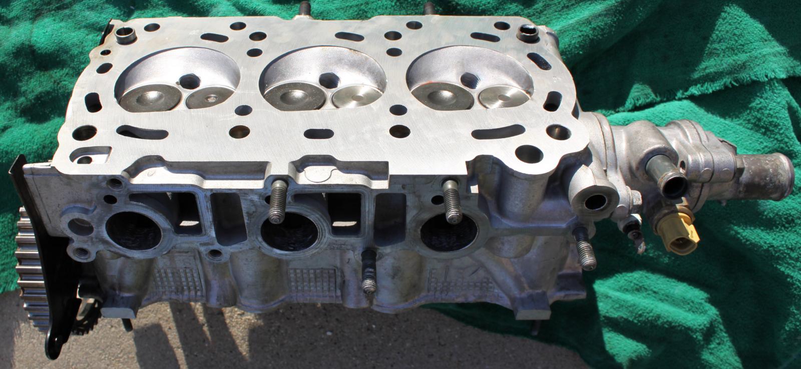

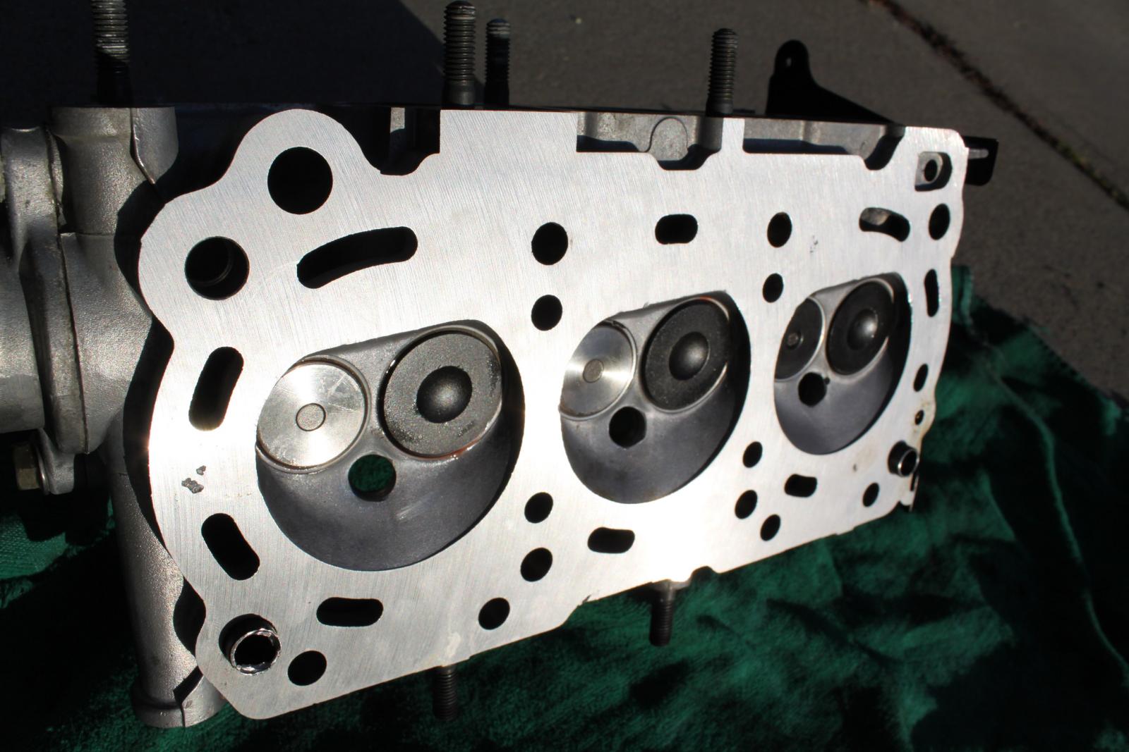

Head is back from the machine shop. He had to replace two exhaust valves. Apparently they had to be shipped in (I guess from Mars due to the delay!). Looks good! I'll start the install tomorrow night.

Very nice! All shiny now ready for another few 100,000 miles of daily driving

i thought you said it was 3 valve
Old Sep 14, 2009 | 07:32 AM
  #82
Nope...
Niku, yeah it's a 6 valve.
6 valves total.
I got the head bolted down on Saturday but didn't have time to finish it. This afternoon I'll put the timing belt on, exhaust mani, and start it up.
