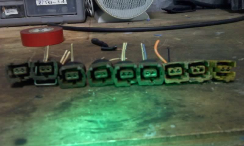

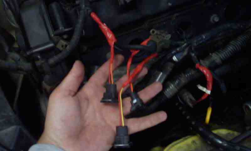

spent a bit more time and money just because i felt like it at the time. the z has been being neglected for too long now. GM style connectors for all the idle control valves were one way to make this happen.
they've since been re-wrapped in black. i marked male and female parts with paint pens to make assembly quick and easy and leave out the "ok this one's longer so it goes to the one farther away" almost guess type work. i had a bit of trouble with them when i first stuck one on and it wouldn't click. a little extra filing here and there, a ton of test fits, and they're now.... ooookkkkk.... but not perfect. i'm not sure why mine didn't work out like most people's do.
all my old connectors. soooo much green! i'm quite happy to have all that out of there.
