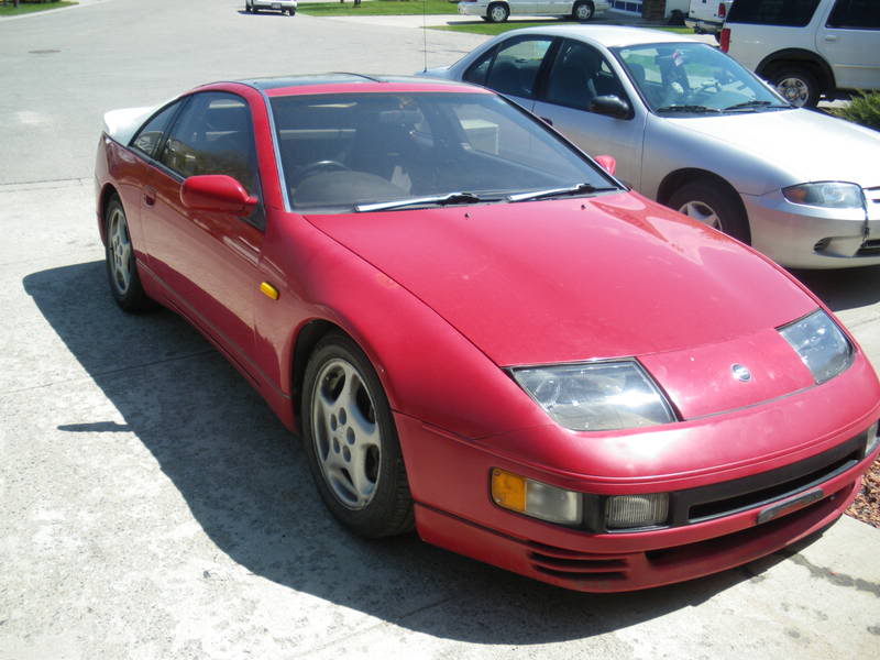

here is a picture, for 1400 CAD i am not complainging other than the white hatch the car is mint inside and out.
