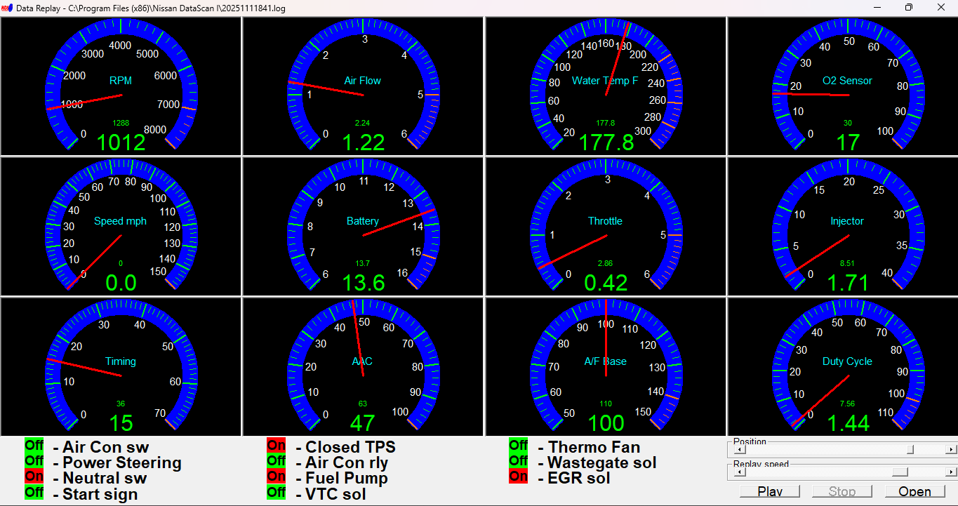

MAF plugged in readings while feathering the throttle to keep engine spinning.

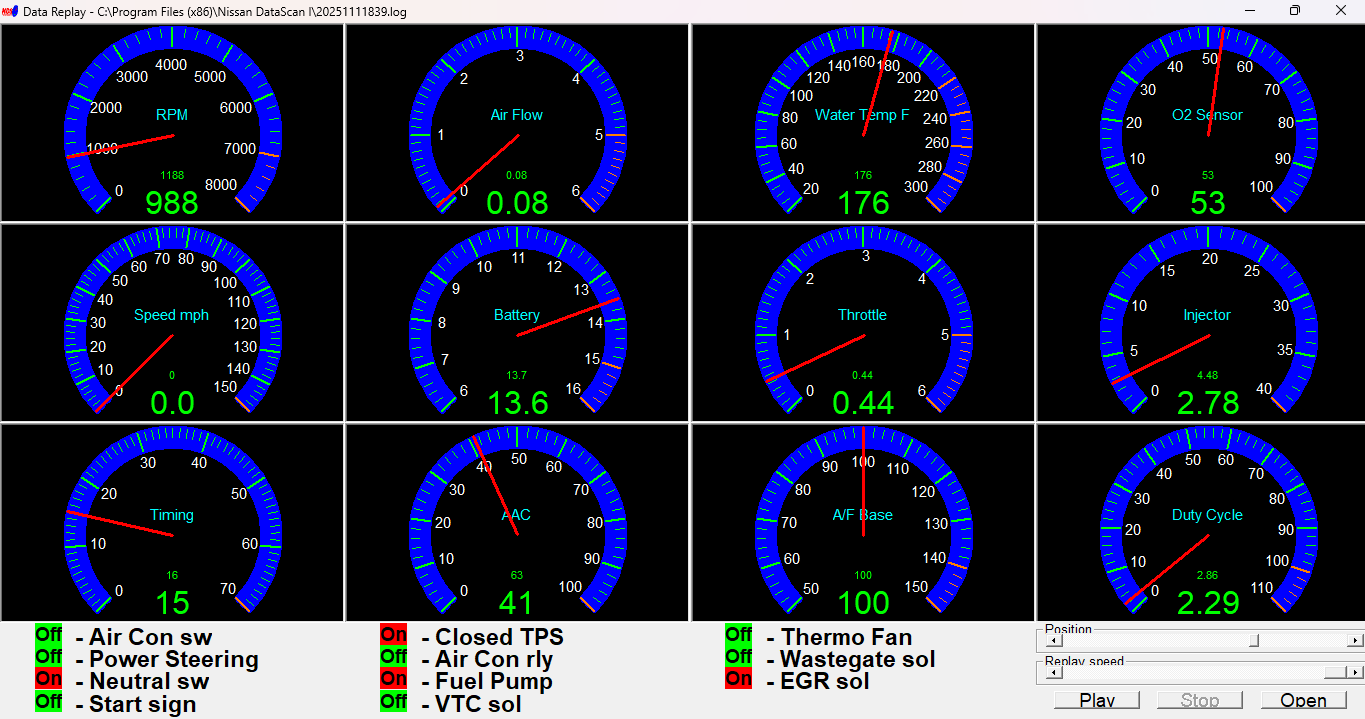

This pic is what the readings looked like when I idle it without the MAF plugged in.

I've top-bottomed the FSM for a 91 I found online to see if anything rings a bell. Should I break down and try another ECU? I opened up the ECU and did't see anything visibly broken. Looked really clean. I'm out of ideas for this thing. Any ideas are greatly appreciated.
