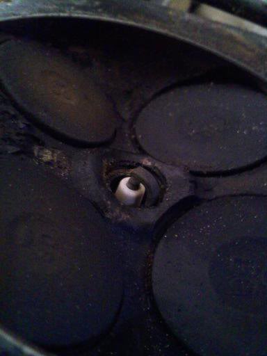

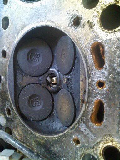

This is why you use the extended plug. these are off the shelf NGK's and are the short version of the vg30 plug.

Hoov thanks for posting the pics and saving me the time. I understand why people think the longer plug is better but with the short plug the flame kernel is still totally exposed to the combustion chamber except for the area of the ground electrode. The NA came before the TT and Nissan designed the ridge around the plug and chose the shorter plug. From what I understand the extended plug was designed for the TT to fix a detonation problem under boost not as a performance improvement.
If someone has dyno numbers proving the extended plug is better in a NA then I will whip out my CC and order a set.
Rockchucker is making 222rwhp on his NA and he is using the short NGK iridiums.
If it makes you feel warm and fuzzy to use the extended plug in a NA then go for it. I just don't think it's right to tell a new guy that he has to use the extended plug or his NA won't run right.
