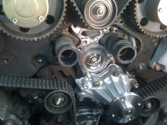

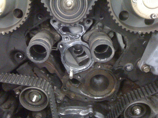

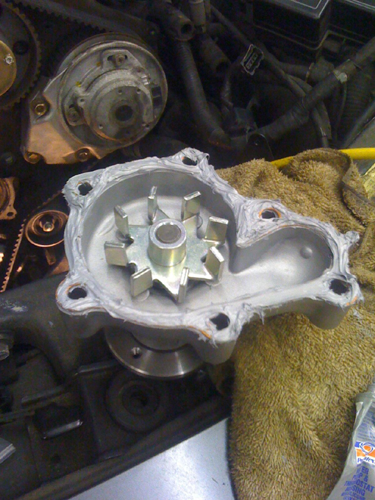

Ok, So i've completed all the work Water pump / Thermostat and 3 belts and no i've got some new problems. (crack in top of radiator and slow drip from water pump after removing the radiator to find the leak)
Please Go easy, im new to working on cars and the Z32 all together.
It's a 1993 2+2 - auto.
I've followed/consulted these forums and the online manual and twinturbo.net for answers. Maybe im searching wrong.
When i started her up (after being off battery for a few days) she ran pretty rough. I would say 50% more rougher then normal. Assuming its because she was sitting elevated up on jacks for a few days, fuel wasnt pressurized etc? Garage is a hair moist and cold also.
She fought to stay running and the new belts squeeled. So i tightened them all up. the dreaded squeel went away with little effort.
After running her and getting the coolant system 100% full and topped off i have 0 leaks and her temp stays solid @ 1/2 way. Where it always was in the past.
Now she idles around 750/1k give or take. Things that are new.
1. She dips (down alot "to like 500ish" then recovers) while idle. Normal i think but out of the norm for her.
2. When i hit the gas, she sounds like a diesel motor.
This is totally new. Just the sound to me is out the ordinary.
(i'm going to post a video for more troubleshooting wed. dec 17th)
It litterlly sounds like i'm driving a diesel motor when you put it in gear and get her going. (that's if she doesnt stall when the computer compensates).
If i put her in gear and she doesnt stall, i can coast and she is perfect. Sounds great and quiet. (i do have a TINY sputter out the exhaust but nothing out of the ordinary - i never payed a ton of attention to these things until now)
Now i only did the following:
1. Water pump
2. Thermostat
3. Belts (all 3 front - did not touch timing belt - looks excellent)

I checked the fans and everything looks clear and nothing is hitting inside the engine. I revved her a bit in park while me and my buddy poked around with a stethiscope and it sounds to be coming from somewhere near the lower rear part of the engine. Now i could be 100% wrong but i personally think it's now a timing issue.
Does the PTU/ECU forget engine timing after being discharged?
Do i have to "reset" any ECU modes or timing modes?
Thanks a ton everyone. I'm going to post up a video of the sound and hopefully someone can point me in the right direction.
