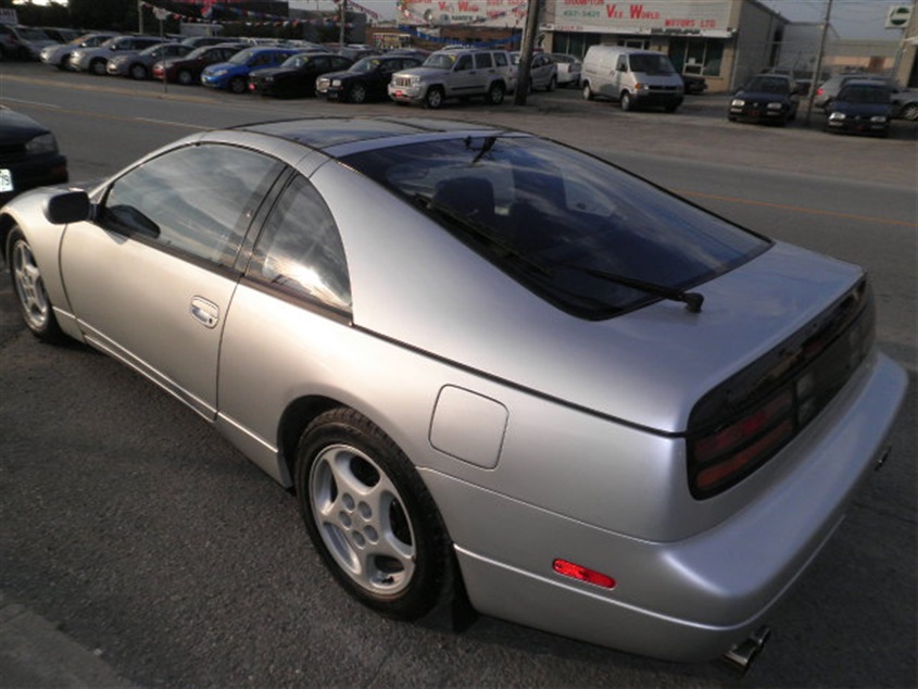

I was looking online and found a Z at a dealer for a decent price. It's not exactly what I had dreamed my Z would be, but it looks like a decent platform to start with.
1992 300ZX NA 2+2.
+ Clean
+ No rust that I can see
+ Leather
+ Price isn't bad for a daily
+ Carfax says: No accidents, no damage, no theft. Shows that the camshaft seals were replaced in 04.
- Automatic (I hate automatics) Though perhaps it hasn't been abused as badly as a manual? I would definitely swap out the slushbox for a manual if I get this one.
- Small dings on the hood and the roof rails (on the edges of the t-tops). Looks like hail damage.
- Carfax says it has more often than not failed emissions (sniffer test) since it was first tested in 1999. It passes the very next day though. Why would that be?

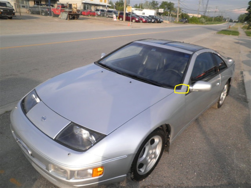

My biggest concern is the driver side front fender isn't aligned properly. The gaps along the hood are equal, and everything else lines up, but the fender bulges outward where it meets the door. Looking at it perpendicular, the gap between the door and the fender are good as well. Looking forward though, you can see right in to the door hinges. At the top, where it meets the a-pillar, it doesn't sit quite right either. I can push on the bottom of the fender where it meets the rocker panel, and it moves, almost back to perfect alignment. It feels as though someone took the fender off for some reason, and didn't bolt it back up properly.
Here are some pics of it. I didn't take them, so I apologize for the limited scope.

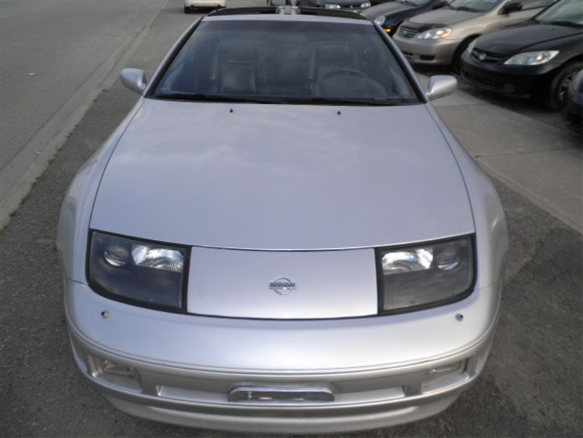

Here are a couple of pics of the fender issue:
All four corners of the hood line up.
This seam doesn't quite line up like the passenger side. There is a bevel. or grove in the a-pillar that the fender meets, but on the drivers side, it sits high, and it just doesn't look right.
The gap. The fender feels loose and can be pushed back in to sit flush by hand. Could someone have taken it off to get to a wire harness underneath, and not re-installed it properly?
Almost no gap on the passenger side:
Hopefully a few sharp eyed Zedders (Zee'rs?) can spot any red flags in those pics and give me a heads up.

Is the bottom of the fender secured to the body? Should be 2 bolts (if I recall correctly) holding the fender on at the bottom. Sometimes that lip gets crushed, which pushes the fender up and bows it out. I would look under there, if its not secured just bolt it back on. If the lip is crushed, you would have to try to straighten it out, and then try to bolt it back up. Good luck on your search, take your time.

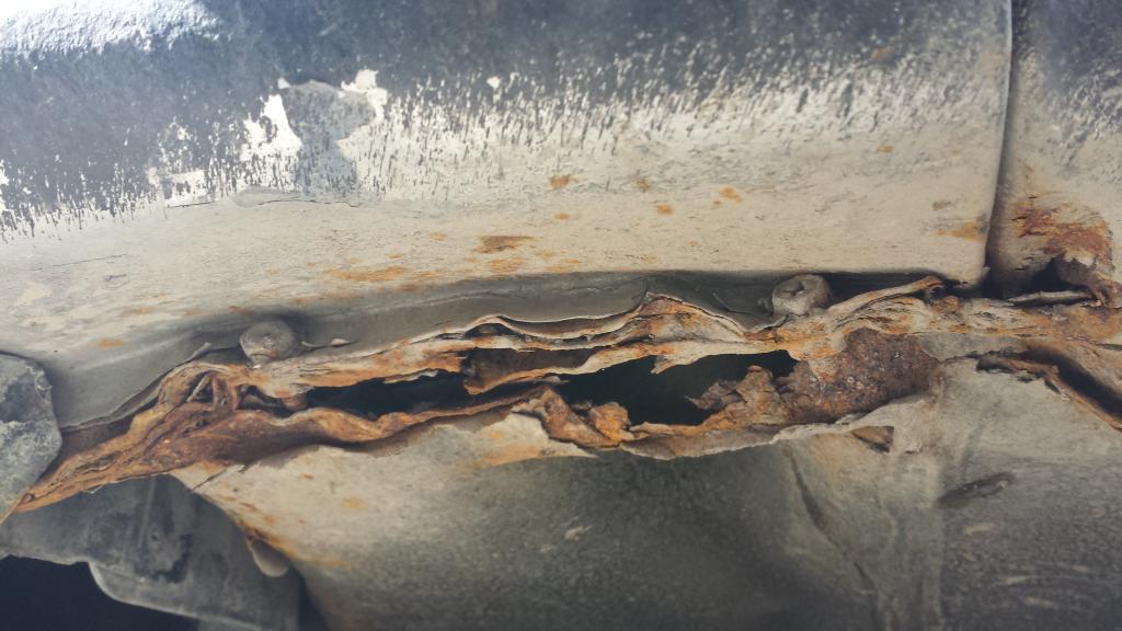

The fender problem was (as someone noted) a jacked up jacking job. They dinked it up pretty good.

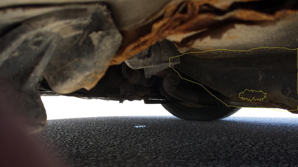

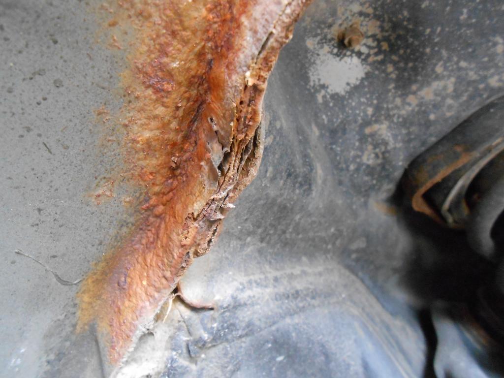

Here is a picture of what is left of the pinch weld on the drivers side.
My heart stopped when I saw it. The rust is really kind of scary, and the whole area looks pretty mangled. Thoughts?
Here is a different view of the same spot. It's not a great picture, but it also shows something dripping. The car had been running for approximately 15 minutes at that point, and I had parked it there long enough to get out, get on the ground and look underneath. Its a pretty good leak in my estimation.
Rear pinch weld... ....eep.
Apparently the brake lines blew a couple of months back, and they had them replaced. Obviously not oem... I don't like the looks of these at all. What is the availability of parts like this? I know for the Prelude, a lot of stuff is discontinued, and a total pain in the *** to get.

Few things pop to mind with certain noises and your alignment issues. First of all, those are some substantial rust holes, especially around the rear cross-member, this could explain your high speed drunk car, the whole cross-member could have play in it. Rust is always worse, the more you dig the more you find, and this rust is going into the structural part of the car!. The engine noise does sound like the belt, if they did one recently and didn't set the proper gap on the tensioner, this could be the issue, but that is unknown, and if you don't know that they changed it, you will have to do it (!!!interference engine!!!!).
4k is a decent price and I am sure you could haggle few hundred off, just remember, there is A LOT of work to be done, mechanically and body wise due to that rust. I honestly would pass. If you can afford to find a cleaner one, might be a few thousand more, but at least you wouldn't have to do a frame up restoration. My .02
^Thank you. I appreciate the benefit of your experience with these cars, and you taking the time to steer a new guy in the right direction.
I think I will pass on the silver one. That rust looked pretty scary to me, and, to be honest, the dealer telling me he hasn't been able to sell it for three years is also kind of spooky. Surely some n00b (like me) would have bought it before. He did have it listed for 6k though. Either way, shes been a wall flower for three years, and I find it suspicious that no one has asked her to dance in that time. I think people are having a look up her skirt and want no part of it.

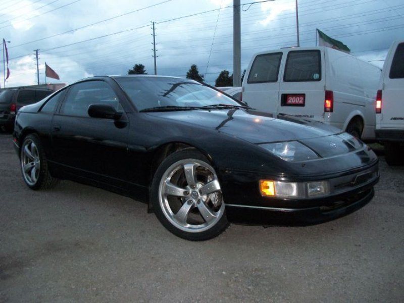

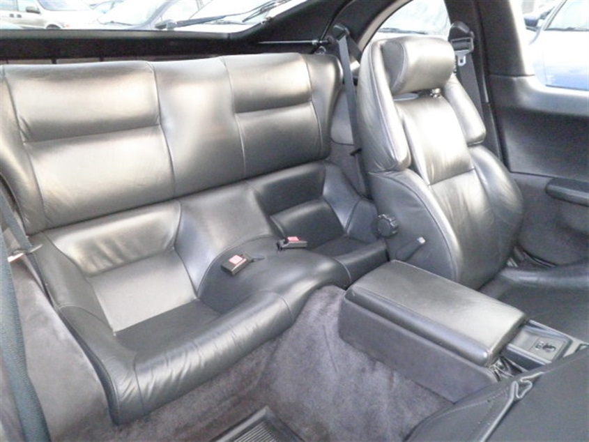

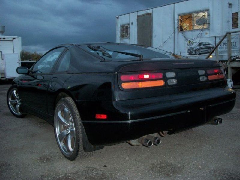

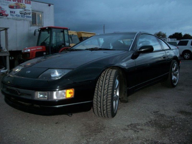

I was going to go see this one today, but it's really cold today and the roads aren't great after the snow we had yesterday. Maybe I'll go tomorrow.
For Sale By: Dealer
Year: 1993
Trim: SPORT CAR :facepalm:
Make : Nissan
Model: 300ZX
Kilometers : 176000 (109361 miles)
Body Type: Coupe (2 door)
Transmission: Automatic (seems we only ever bought automatics, and convertibles up here) :facepalm:
Drivetrain: Rear-wheel drive (RWD)
Fuel Type: Gasoline

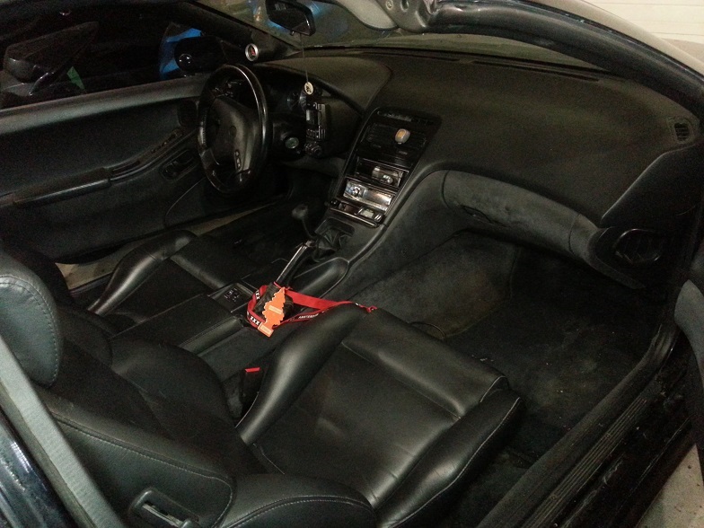

The description says it comes with new tires, certified and emissions tested. $6490CDN or $5100US.
What is up with the ends of the dash? It looks like the ends are missing.
Is there something missing from this door? An armrest or something? The seam between the top and bottom looks cheesy and unfinished.
From the pictures the outside looks okay. The interior looks as though someone was redoing the fuzzy part of the dash and hashed it up. Or they took the pictures before the job was done.
Thoughts on this one?

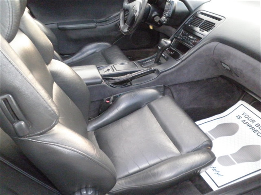

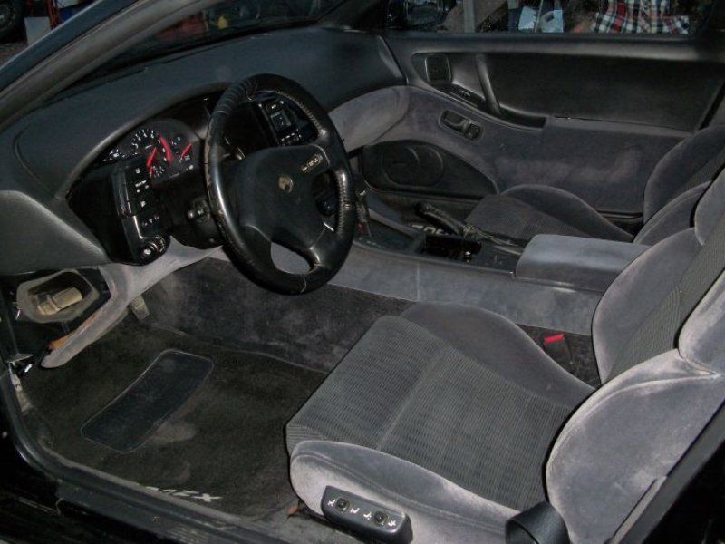

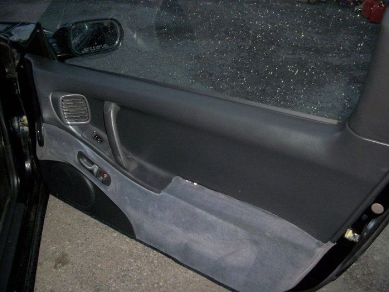

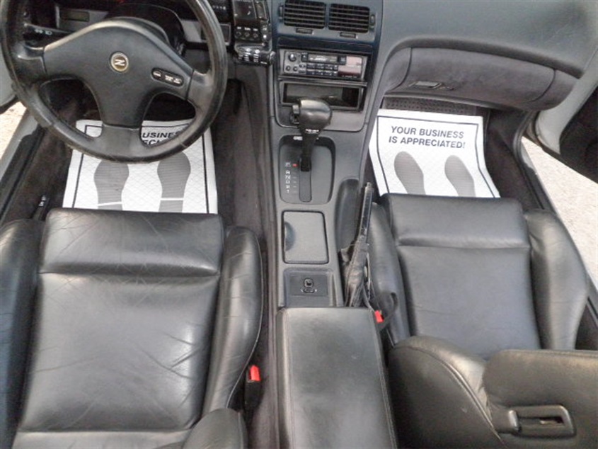

I was going to ask about the steering wheel, but I didn't want to come off as wanting a CSI investigation on the car lol. "We swabbed the wheel and found the DNA of X number of people, indicating that the number of owners is a lie!"
Seriously though, the wheel does look a little worn, and I wondered if that amount of wear is consistent with a 174000km/109000mile Z?

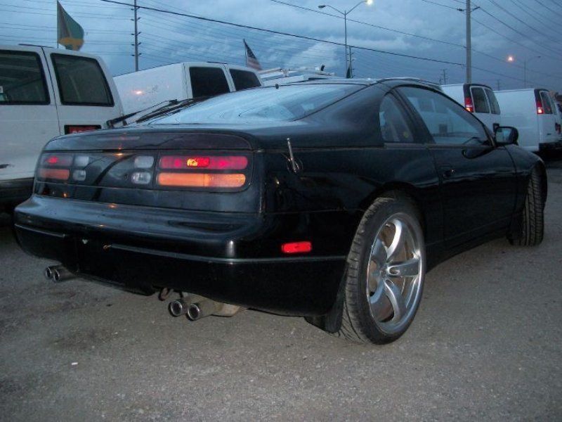

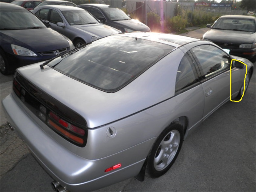

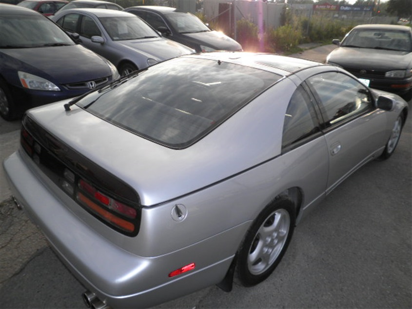

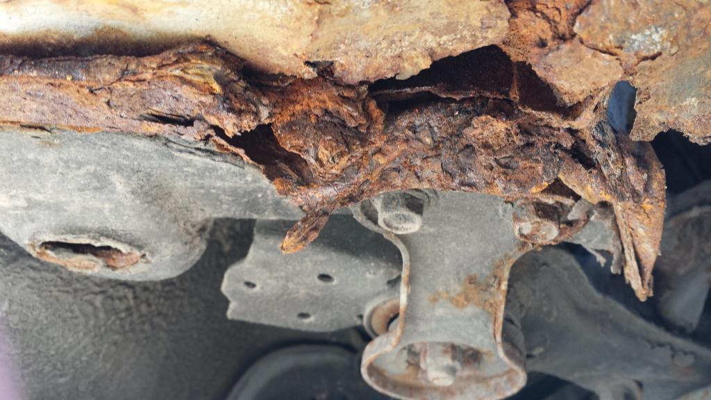

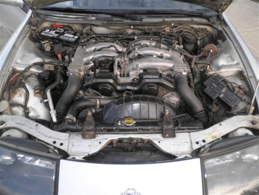

I went out there today to have a look at that '93. Their site has two z's, one is the black one I went to see, and the other, for the same price is a white RHD TT. They'll never sell it. When I get there, theres three Z's! Two white and one black. The extra one was manual, stock wheels, tan leather, NA, with pretty big exhaust tips. Heres where the car buying experience gets weird again... apparently, that car is not for sale. It's sitting there between two cars that are for sale, with no plates. Is not sold, its just not for sale. Why? "Personal use." WTF. Are all car dealers like this these days? In the old days they'd sell the picture of their wife on their desk to make a buck. Now they want to keep cars for their own personal use.

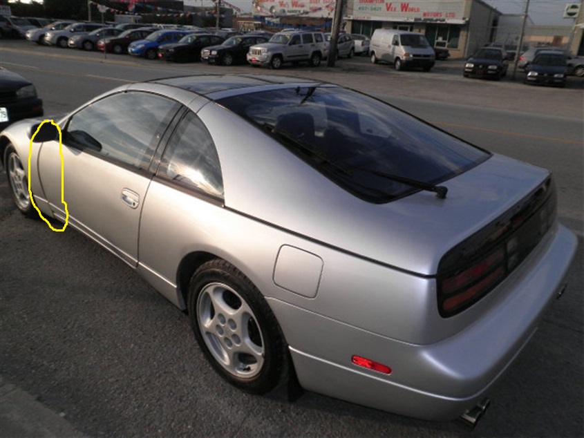

Back over to the black one. The body was pretty good. No rust. Someone dinked up the passenger fender by jacking it up wrong. The interior was really clean. Some rough edges, but nothing that couldn't be fixed. Started right up, and idled so smooth and quiet, I had to check to see that it was still running. The engine bay was pretty clean, but I noticed two spots of rust that looked a little ominous. I'll use a picture of the other car to show where it was.
On the drivers side it was a small spot that they tried to cover with some gummy rust inhibitor, but I spotted it right away.
On the passenger side it was worse. It looked as though layers of metal had separated, and it was flaky. Like this:

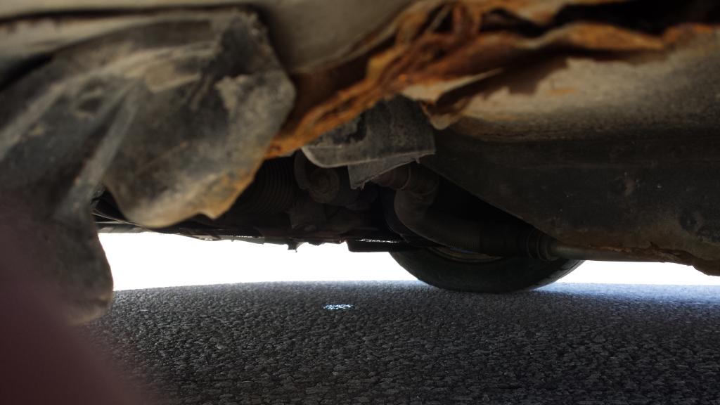

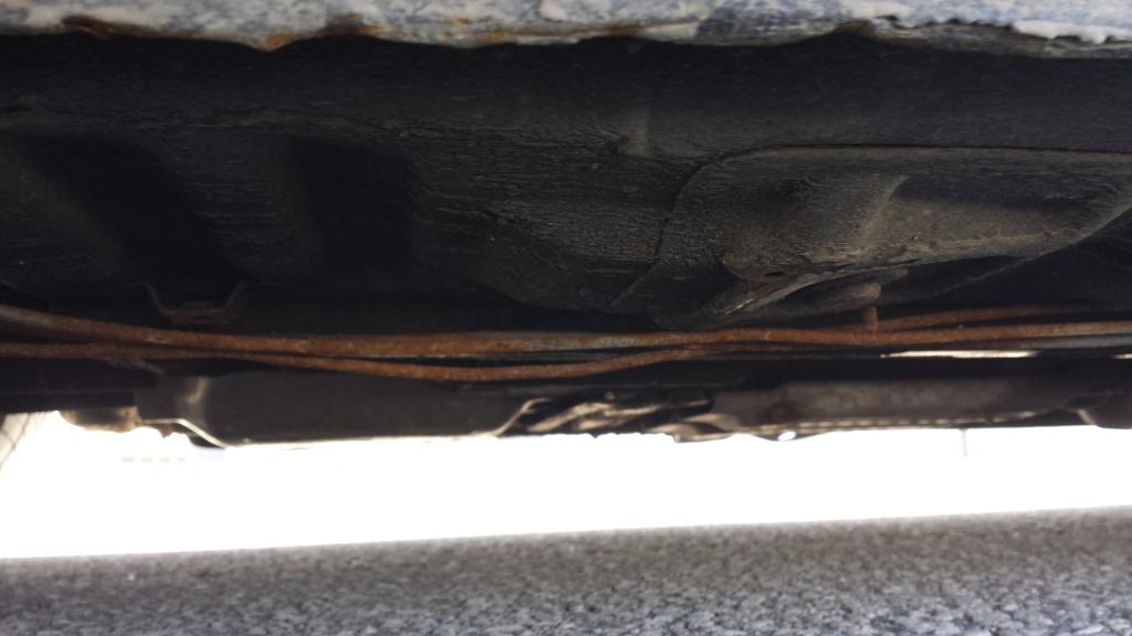

After seeing that I looked underneath. Again, a picture from the other car (I didn't waste time taking pictures of this one)
The area outlined in yellow looked like black tree bark, or a tree covered with undercoating. I reached underneath, and pulled a piece of it right off (the jaggy yellow part).
No sale!
No sale!
