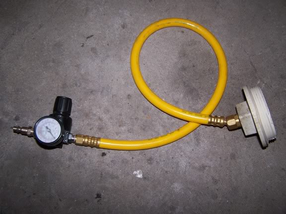

Well if you think you have vacuum leaks. You should test for leaks. You can pressurize the system, and check if you hold pressure. You need an adapter to attach where the MAF goes. This is a really thorough guide on how to test and find leaks.
Boost Leak Guide
You can make your own tester pretty easily, do you have access to an air compressor? I made one out of a PVC cap long time ago, worked like a charm.

Thank you, I'll give that a go, I know most of my problem is in the factory intake piping I'll start there and in the mean time also try your suggestion so I can find them all at once,

Yup, happy hunting! Don't get carried away with pressures, I would regulate air at the compressor and at the intake, so 2 regulators. Not much PSI like the article says, you don't want to blow out seals.

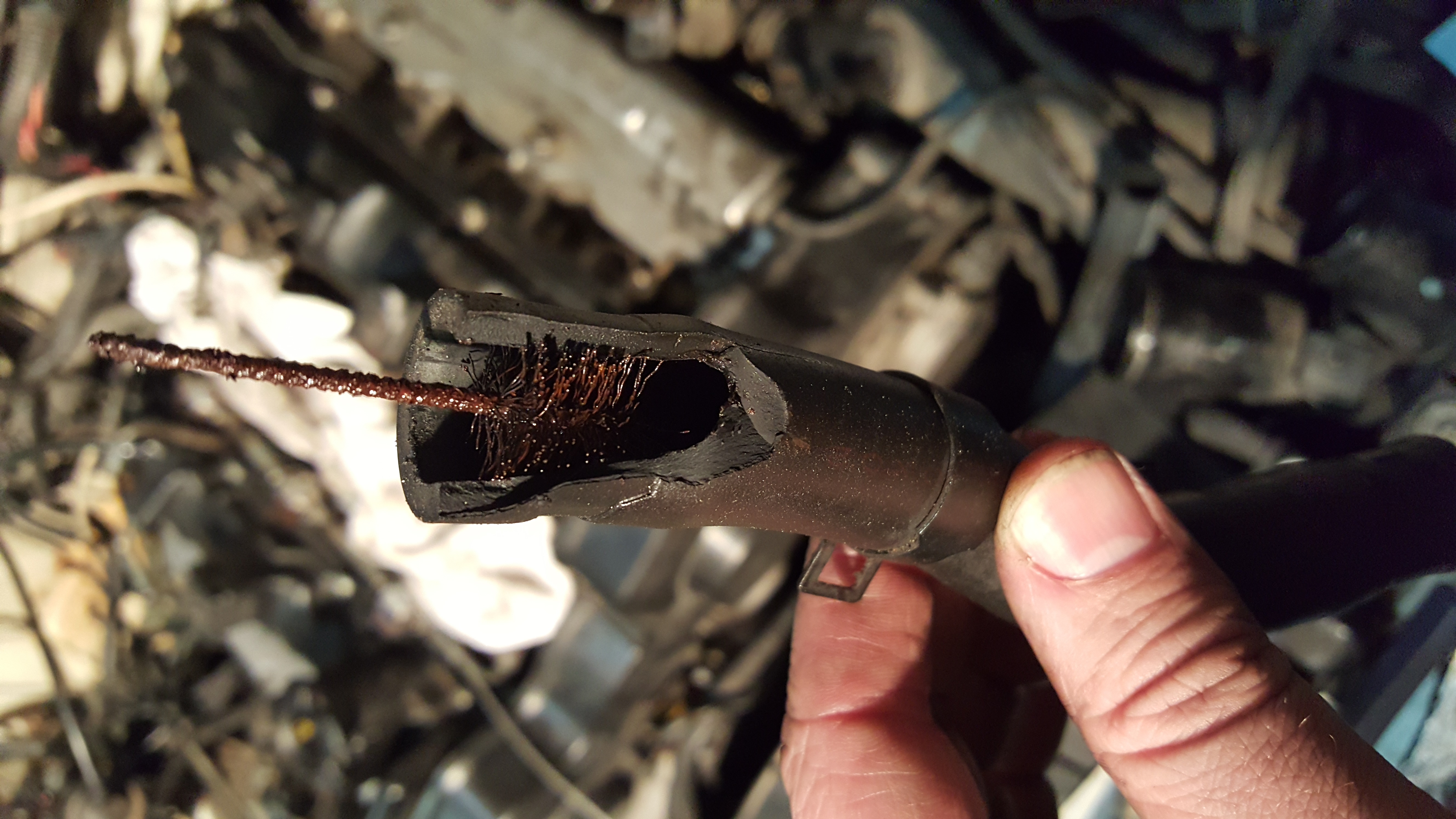

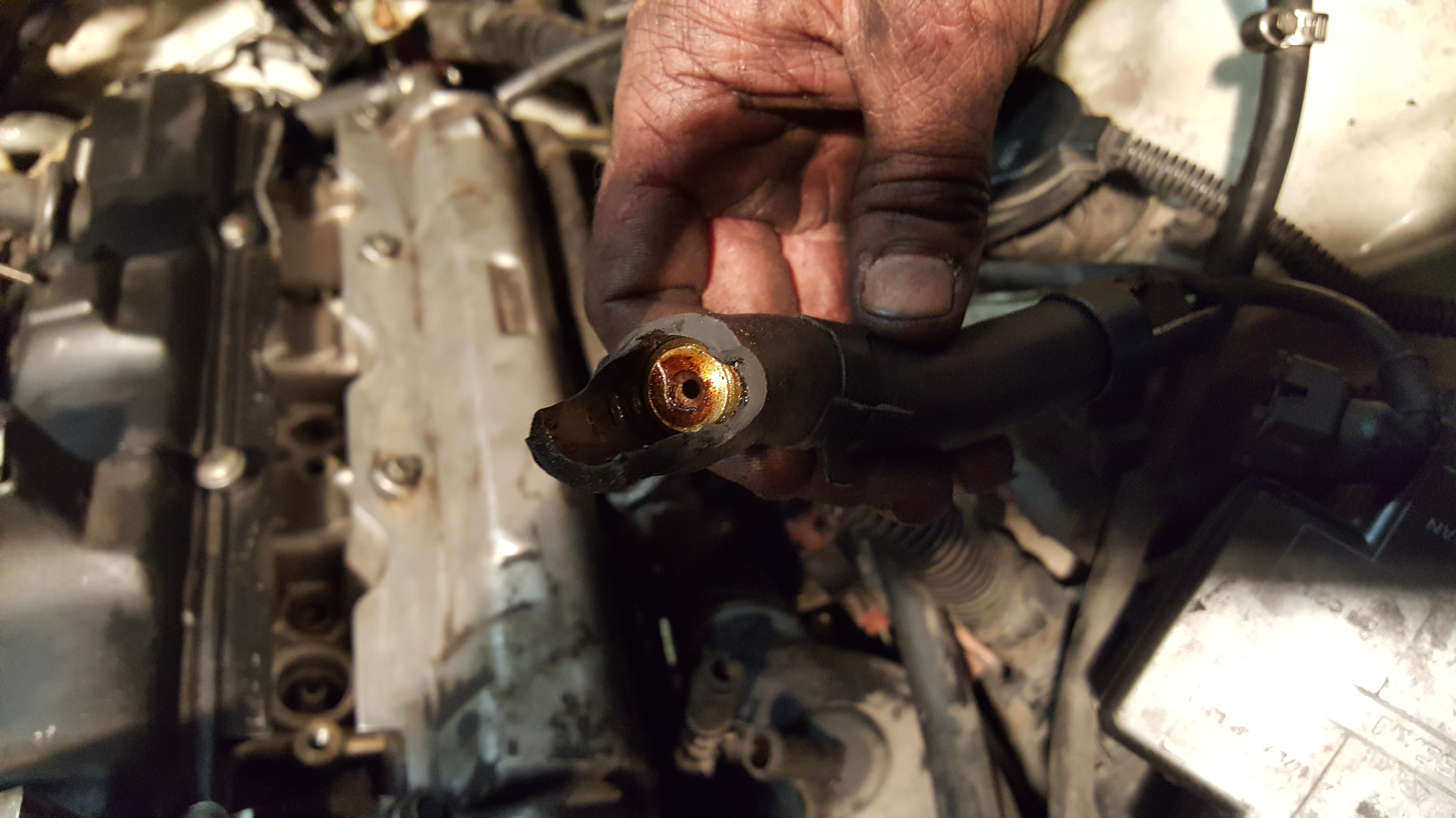

yeah i starts and runs here and there, its supper touchy iv got the new pipping coming im hoping it will be here this week but with the holidays its anyone's guess. i did the smog test and the smoke came from pretty much where i expected, so i think im dead in the water tell the parts show up, so after replacing all new vacuum lines i found a little pip cleaner looking thing and two little brass circle things are these important to the vacuum in the car ?

The replacement hoses should have the restrictor and flame arrester in them. For sure don't run the car without that restrictor. This is in the PCV hose right?

one was on the drivers side pvc, and the other was on the main rear passenger vacuum line from the rear smaller line into the bigger top intake manifold, i didnt get factory vacuum lines just bought all new lines from my dealership, iv put them in line from where i took them out, in exception of the weird wire brush cleaner,
