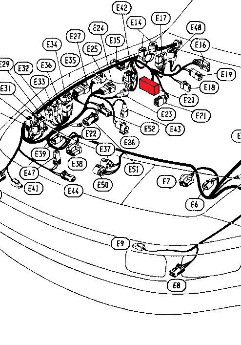

Fusible Location
Here is a diagram from fsm, I colored the fusible link box red.

Originally Posted by PredatorZ
Do you have a copy of your FSM, you can get them free online.
Have you checked your Fusible Links ? Sounds like one of them has blown, it is a slow burn style fuse, most of your major systems are protected by them to prevent major damage to your harness.
The fusible links all look good to me, and I've swapped them to see if the problems would go away/be affected and no good, I had a guy with a multimiter check it out and he said there was no power at all going to the power windows slot of the fusible link box.
