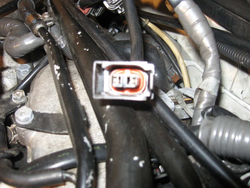

o and i did notice there is a connector right behind the plenum on the driver side that isnt plugged into anything ill take a picture and put it up

That looks like an injector connector to me.
If its in the back of the motor why dont you look for the part on the motor that doesnt have something connected to it?

the ptu already had the recall done. All the injector wires are plugged in and there arent any other connectors hanging loose. could it be a spare for an accessorie?

It wouldn't be hangin loose, it would be a sensor like the iac or something in the back

That connector is not used on the Z32. (Little known fact - car companies will make general parts that fit on several models with different features, to keep costs down... :gasp: )
Regarding testing the PTU, disconnect it, clean all connectors, reconnect, see what happens.
