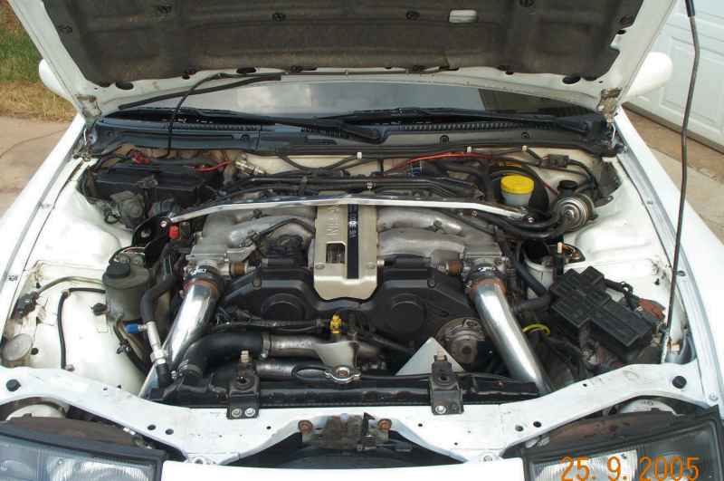

BTW - I went to our local Z-Club meeting last night. There was a guy that had a front strut bar installed on his '93 convertible. I checked it out. He only ground off one bracket on the passanger side, bent the remaining brackets out of the way, did some grinding on those brakets where they attach to the body, and then mounted them on top of the braket flanges. He also had to grind a little of the top of the front ears of the strut mounts to clear the bottom of the hood, but did good. This is what I am going to do as well. I bought a side grinder and some wheels for it to help with the modifications to facilitate the strut bar installation.

Remove the bracket on the passenger side the holds the AC line since it's not necessary and can be zip tied in alternate locations. Remove the bracket on the the drivers side since all it hold is the engine bay light switch. Install a washer over the passenger side strut stud that is closest to the power steering reservoir bracket. The washer should be about the same thickness as the PS bracket.
When it's all said and done, don't be surprised if it still doesn't fit. There aren't many front strut bars that fit right on these cars. Carbing is one of very few.

Update!
I installed the front Strut Bar this past weekend. Thought that I would post some pics to show the installation. I cut and ground off the hose braket on the the passanger side. I bented the power steering pump bracket out of the way, and routed a slot in the bracket that holds the vacuum 'gizmo'. I re-routed the throttle cable, replaced the fuel lines and re-routed them slightly, and bent the bracket for the hood security switch. I also cleaned up the engine compartment, as you can tell from the previous pictures to the ones shown here.
Thanks for the help! (Once again)
