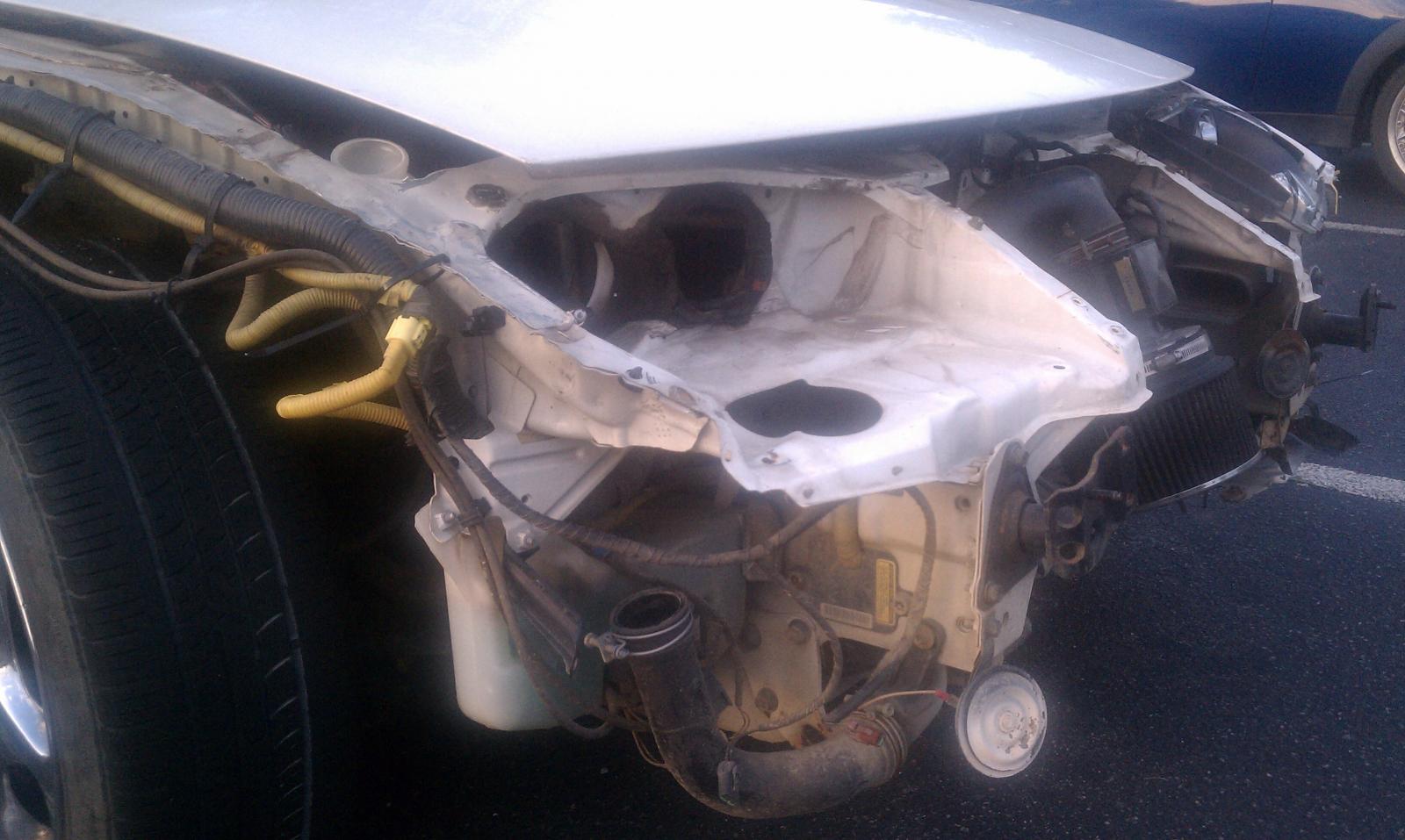

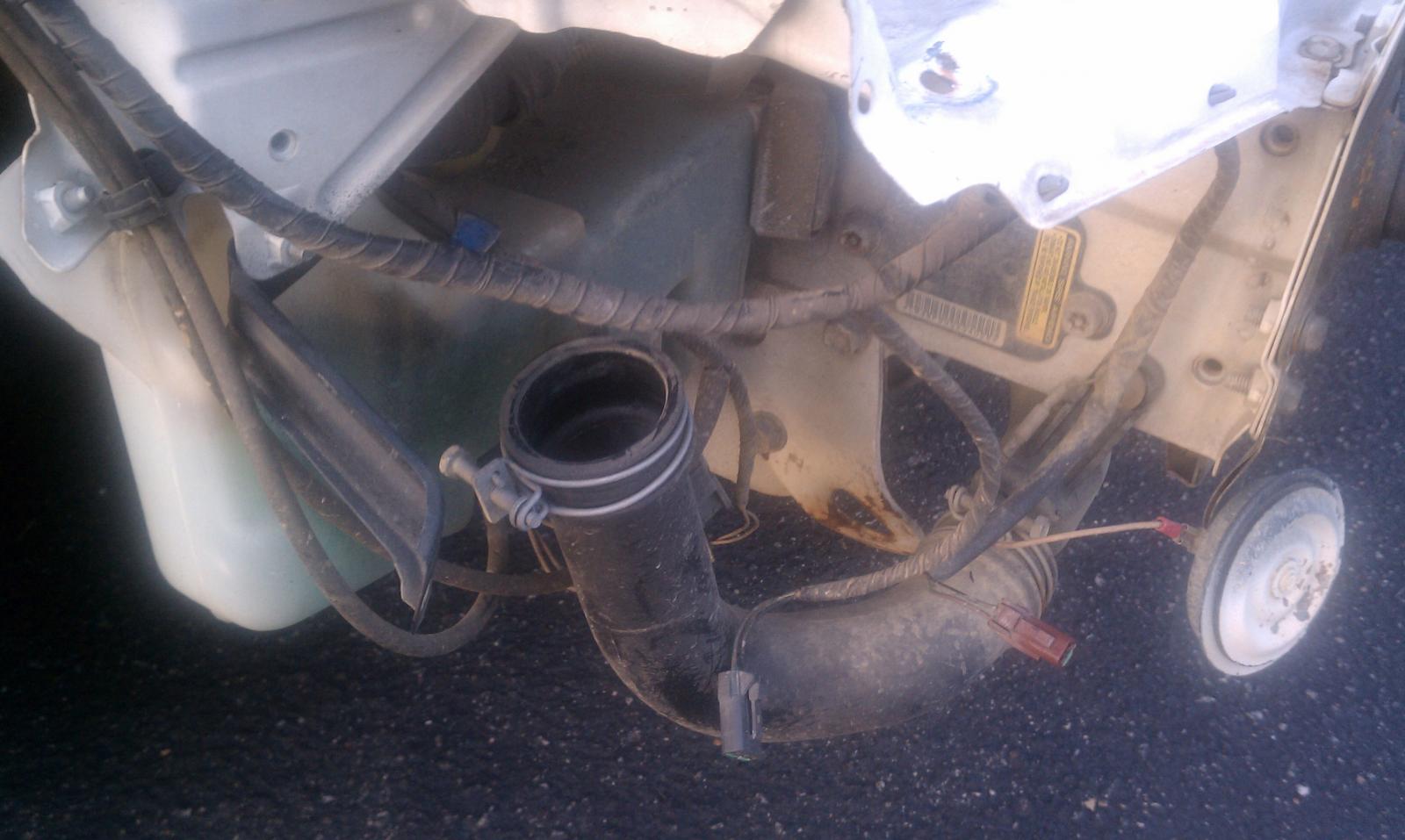

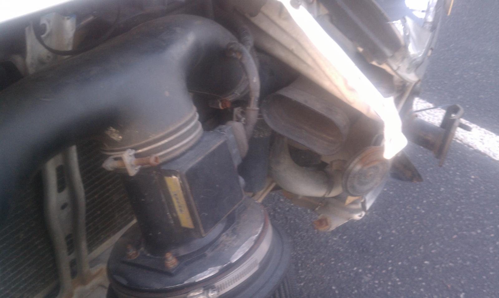

Hey guys and gals ,
I'm working on a 93 300zx 2+2 n/a and before i but the side fenders and bumper on the car I wanted to if there was anything important about this one hose that's on the left hand side just under the passenger side head light? I'll be uploading pictures as soon as a computer is handy . Thanks for all the help

Well the one under the headlight was connects to the factory air box and there should be another one on the other side. The other pipe that is on your pass. side also connect to that air pipe that is missing. You should be fine with out them since you do not have the factory air box. Just have to make sure air is not being sucked in without passing through your filter first.
