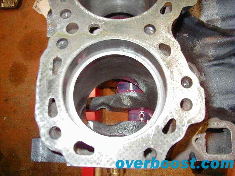

How different are they? If I could get some pictures from similar angles and distances it'd be great. I haven't seen too many pictures of the bottom of VG heads just laying around on the internet though. Or an overlay of gaskets or something. This would be so much easier to play around with if I had a good Z junkyard near to look at things.

Here's some pics from Google Images:
Left pic: VG30 Block
Center pic: VG30DE (VG30DETT) block
Right pic: VG30DETT head
If you are serious about it... just get a VG30 head gasket & lay it on top of a VG30DE head gasket & look at the differences.
EDIT... here's a good page about VG engines: http://members.tripod.com/~grannys/2N6VG30.html
Attached Thumbnails DOHC head swap?-vg30-shortblock.jpeg   DOHC head swap?-vg30dett-short.jpg   DOHC head swap?-vg30dett-headbottom.jpg
