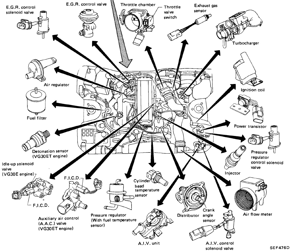

After reviewing all your posts, I see no mention of checking the TPS or air regulator, or checking a/f ratio when the problem is happening. I suggest doing so (all 3 things).
Also, have you tried another turbo ECU? When I upgraded my 280ZXT to the Z31T ecu / maf, I remember reading online (ZBum's web site???) that the 84T ecu was notorious for having cold start idle problems.

TPS has continuity, just replaced the MAF then ran ECU diagnostic on it, both led's blink at an idle and thru RPM spectrum up to 2,000 RPM's however they do blink at about a 5 second interval (together) so they stay on for about 5 seconds blink off for maybe 2 seconds then come back on for about 5 seconds, the pace does not change at any RPM between 650 RPM thr 2,000 RPM. When you mention the Air reg. do you mean the A.A.C ?
Old Oct 27, 2010 | 07:22 AM
  #33
No... when I say "air regulator" I mean AIR REGULATOR.
Click:
Attached Thumbnails calling all z aficianados so far no fixes offered-z31efi.jpg
