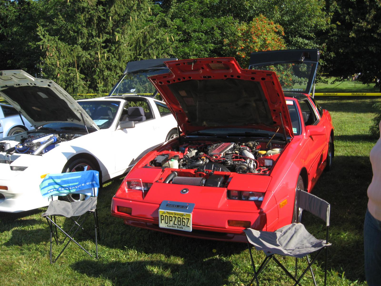

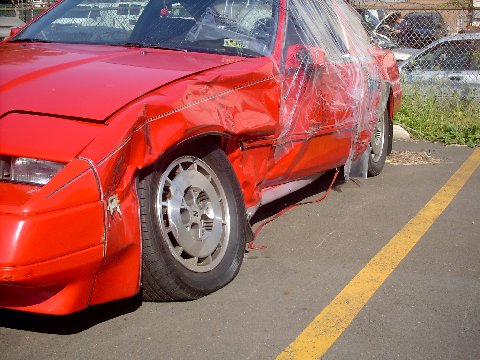

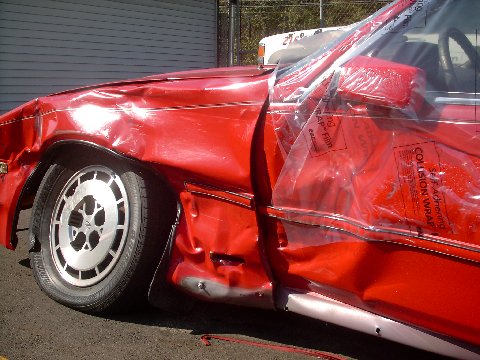

In the sense that I want it to not let me down while going to Nashville or Canada. I have attached some before and after photos as examples. If I need to start a new thread on this let me know. Short history. My Dad bought it new when he retired, he kept it clean. Got totaled, he rebuilt it. He passed 2 yrs. ago and I kept it. I did sub frame bushings, springs, struts, had all suspension elements at least verified for wear that had not been replaced. Full exhaust(MSA ceramic coated headers, 2.5" stainless from there all the way back. Local fab/ friend who builds this stuff). I knew about the weak history of the A/T so I took it to Level 10 and Pat bullet proofed it. I have questions about single shaft vs. 2 piece that's in it. I'm happy with it although the A/T unit in the rear may be acting up not sure how to trouble shoot it. Interior is clean and original except for drivers seat repair. 116k doesn't drip.
Sorry I got carried away. Nothing radical but clean. Thanks for the grounding tips.
