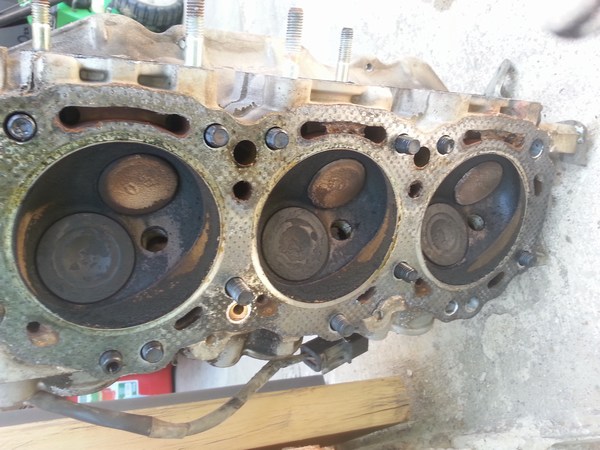

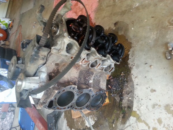

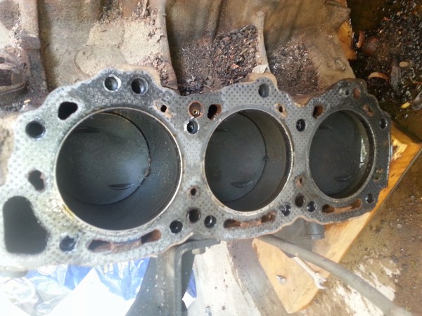

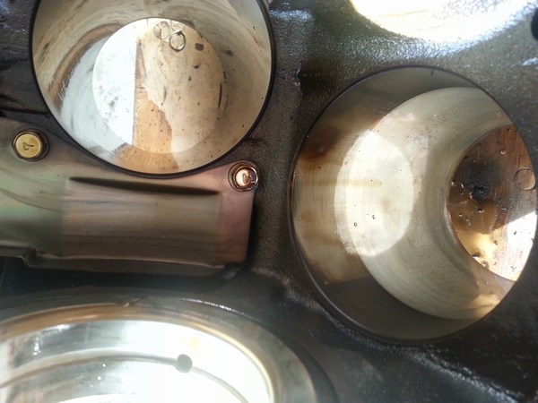

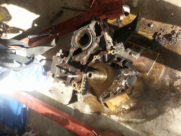

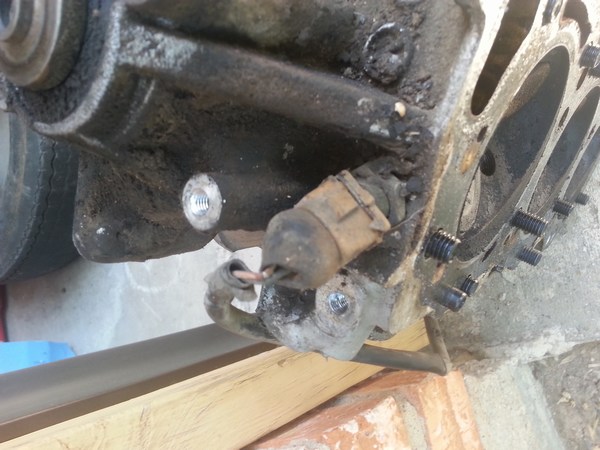

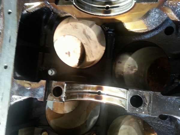

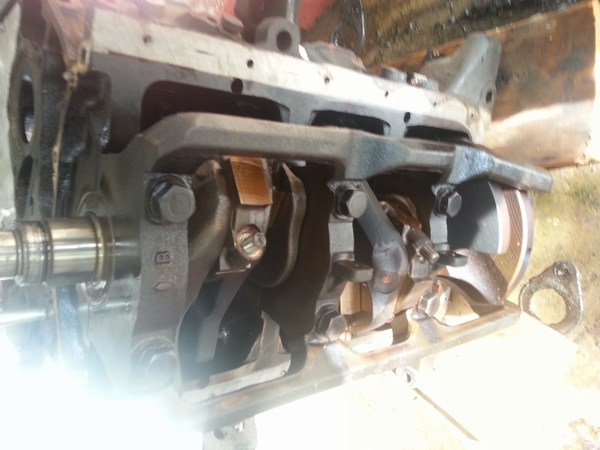

Pics as promised...
So here are the last pics of the motor teardown before it goes to the machine shop. I did run into a snag and had to get mid-evil on the crankshaft timing gear. It is NOT as hard to remove as some people claim it is. Mine was frozen on there pretty well... I used some engine cleaner (spray), a rubber mallet (to beat on it to get the fluid down the shaft and keyway), a flathead screwdriver, and a good old fashioned gear puller.
Well, since this part of the project is waiting on the machine shop (the full gasket set is here, waiting on rebuild...) I need to make sure I don't need oversize rings/bearings... as soon as the machine shop lets me know, I'll order those and then we can start the rebuild.
SOOO While that is going down I will be going thru the wiring harness wire by wire on the workbench and replacing things as necessary...
Also ordered a full replacement kit of polyurethane bushings for the entire car. I am also making new hardlines for the fuel, clutch system, and the brakes. Nothing wild just bending new tubing so I don't have to worry about 28 year old tubing. Already replaced the rubber lines at fuel tank side, waiting on filler neck gasket to continue there. However I will be forced to take another break the 10th thru the 13th as I have to go jump. (Paratrooper, U.S. Army)
So keep tuned for fun updates and of course more pictures. The welding on the frame and interior should be starting tomorrow.
