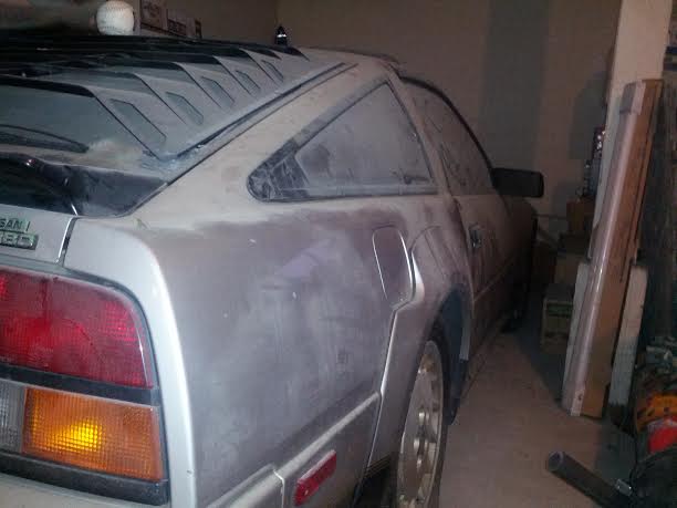

Where can I buy a rebuild kit? Just got my grandpa's 300 ZX 50th AE edition, 5-speed manual! I just want to pull the engine and redo everything so I am worry free!
Attached Thumbnails rebuild kit-dusty-z31-2.jpg   rebuild kit-dusty-z31.jpg   rebuild kit-z31-turbo-engine.jpg   rebuild kit-50th-ae-badge.jpg

depends on what you think redoing everything entails. First thing you need is a bucket full of money. Change the timing belt #1. pulling the engine gets you a new clutch. here is some not reallly expensive things to do that will improve the car significantly:
Get your battery load tested. Be sure you have clean, tight corrosion free terminals on both ends of your battery cables. Be sure the ground (negative) cable goes to a bolt into the frame before going to the starter. grounding through the starter is not a reliable connection. Z's don't like low voltage. causes the electronics to act funny. it is possible to have enough amps to crank but not enough voltage to run the electronics. If you have one size fit all cheapo clamp on terminals they are a problem waiting to happen.
Clean the connectors for the maf or afm, ecu and tps. Deoxit by CAIG is probably the best connector cleaner on the market. spray with CorrosionX after cleaning and before putting together this will help prevent any further corrosion.
Replace outer tie rod ends, and ball joints. replace the bushings with poly (don't forget to lube them as directed unless you like squeaky things). New shocks. all those things will make you think you are driving a different car. doing them piece meal is a waste you won't see a great improvement until you do the complete job. Rear bushings nice too but more work and you won't notice as great an improvement. Rear shocks also because if the fronts are gone so are the rears. if car squats when you jump on the gas the rears are gone. If you have the electro adjustable shocks they are DEFINITELY GONE.
If you are doing a turbo car shocks (electro adjust I think may be only on the turbos) then you need the adapter plates to fit modern shocks to the car. Easiest way is find an n/a at the junkyard and take the mounting plates. They may be available thru NAPA (listed) but I had the n/a plates.
Courtesy parts good place to get timing belt kit. Other parts Black Dragon and MSA. Junkyards will be your friend. Boost controller quick and easy horses improvement.

Well The car has been sitting for 10 plus years and my Grandpa can't remember what happened to it, so I figured I would just rebuild it...or should I just change the fluids and belts etc and see if it starts up?
Old Dec 30, 2013 | 12:10 AM
rogerz's Avatar
Grumpy & Helpful
Posts: 1,415
From: Mill Creek WA
what you just said above is the smartest. You should do the timing belt because if that goes you incur a lot of engine work. then do the things I suggested. If you get it running you will discover what needs to be done rather than just shotgunning it. My experience is that the car in general holds up pretty well but there are a lot of small things that need some care. You will need the fsm - free download from xenon. If you don't have some mechanical ability the car will eat up money.

My Grandpa finally remembered why the car initially ended up sitting. He said the clutch went out and the battery died. He had 5 kids so his priorities changed and the car just ended up sitting (which is good for me ).
So I know I still need to change the fluids and belts, but does this change anything?
I figure I will pull the transmission along with the master cylinder.
Am I missing anything else?
Old Jan 12, 2014 | 02:34 PM
ken99's Avatar
Joined: Sep 2012
Posts: 233
From: Montana
Unless grandpa divulged more info than you shared, I'd diagnose the clutch problem a little more before dropping the transmission. The car has a hydraulic clutch. I'd bled the system and test the integrity of the master cylinder, slave cylinder and modulator (mounted on passenger side frame rail) first. You will need to perform this service anyway. Reman parts are relatively cheap if replacements are needed. Once the hydraulics check out and the clutch is still bad, then you can dig deeper.

More or less. What I discussed is all part of the clutch system perse. I merely suggest checking the external, hydraulic portions of the clutch first. If grandpa's problem can be solved without dropping the tranny (at least for now), wouldn't it be worth the time spent looking at the hydraulics?
