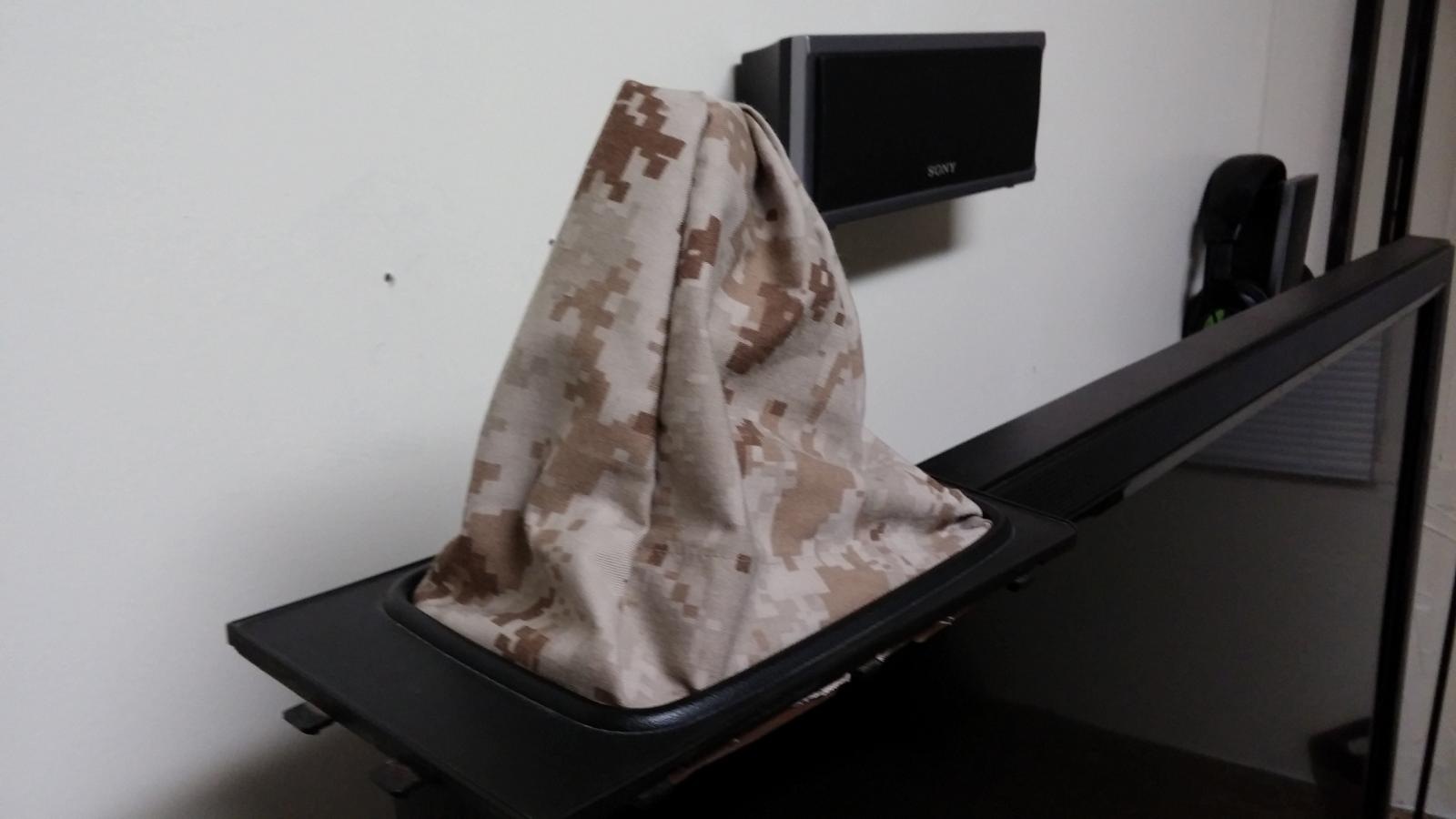

Old May 19, 2015 | 08:01 AM
Fortitude57's Avatar
Joined: May 2015
Posts: 17
From: Upstate, New York
Ok. Did some work to the car over the weekend. Attached some pictures. Still finishing up the other speaker cover. Will post a picture when its installed.
So I am starting to receive all my parts... I want to do the Timing belt myself and although I feel I am very mechanically inclined (USMC Op/Mechanic and personal builds) I am nervous to do the timing belt.
Is this a difficult job to do? Anything I should know before hand? Bought the Bates Kit. Includes: Tensioner, Belt, Water Pump and the gaskets. Anything else I need?
Thanks ladies and gents.
Attached Thumbnails New to the Z world!-new-image.jpg   New to the Z world!-new-image1.jpg
