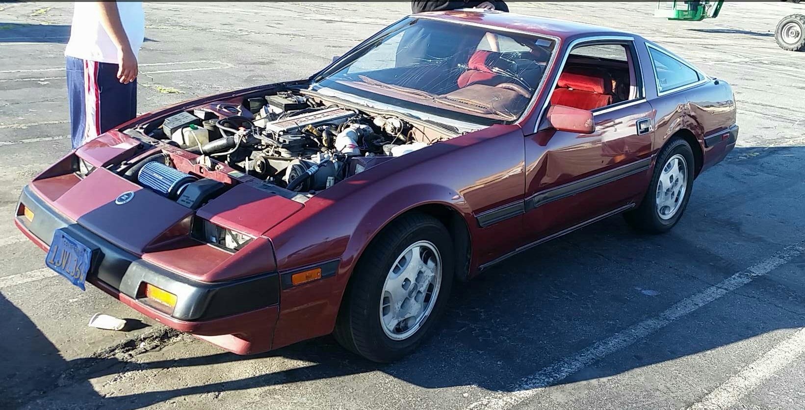

Ok, so i just bought a 300zx for $400. although its so cheap the engine fires up instantaneously every time, it shifts extremely well and it handles amazingly. the only down side is it didnt come with a hood, the windshield is cracked really badly, the fuel pump relay gives out every 2 minutes, but fires right up again, and i think there is a vacuum leak because power steering barely works and the brakes work but are ridiculously spongy. it feels softer than the clutch. ive already ordered the relay, hood, windshield, and bushings all around. It drives like a dream which baffled all of us. all the electronics work like new, everything fits right in its place and except for a small tear the inside is really good considering its 30 years old. so the car hasnt been in major accidents but there are so many minor dents and dings all over the car. but those can be worked out easily. with how well everything works i feel like i got it for a steal. but i could be wrong? what should i look out for, or aside from a tune up, what else should i look out for in these? as well as i do plan on it becoming a drift car so mods?

In case you haven't figured it out yet you have a n/a 84 or 85 Z31 given away by the fact of the four lug wheels.
