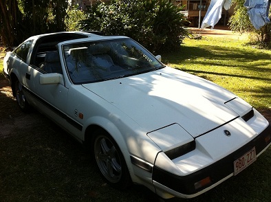

my z31 is getting hot since i flushed the radiator so i am thinking its a air pocket i have no thermostat i took it out .i looked for the bleed valve and it don't have 1 so how do i get the air out ?????
Attached Thumbnails how do i get air bubbles out of my vg30e ?? it has no bleed valve-h-40-.jpg
