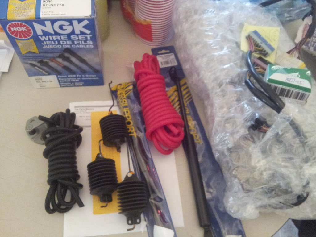

I got a bunch of parts in today that I need to find time to install.
Still waiting on spark plugs. Once those come in the first thing I will be doing is changing them and the wires out.

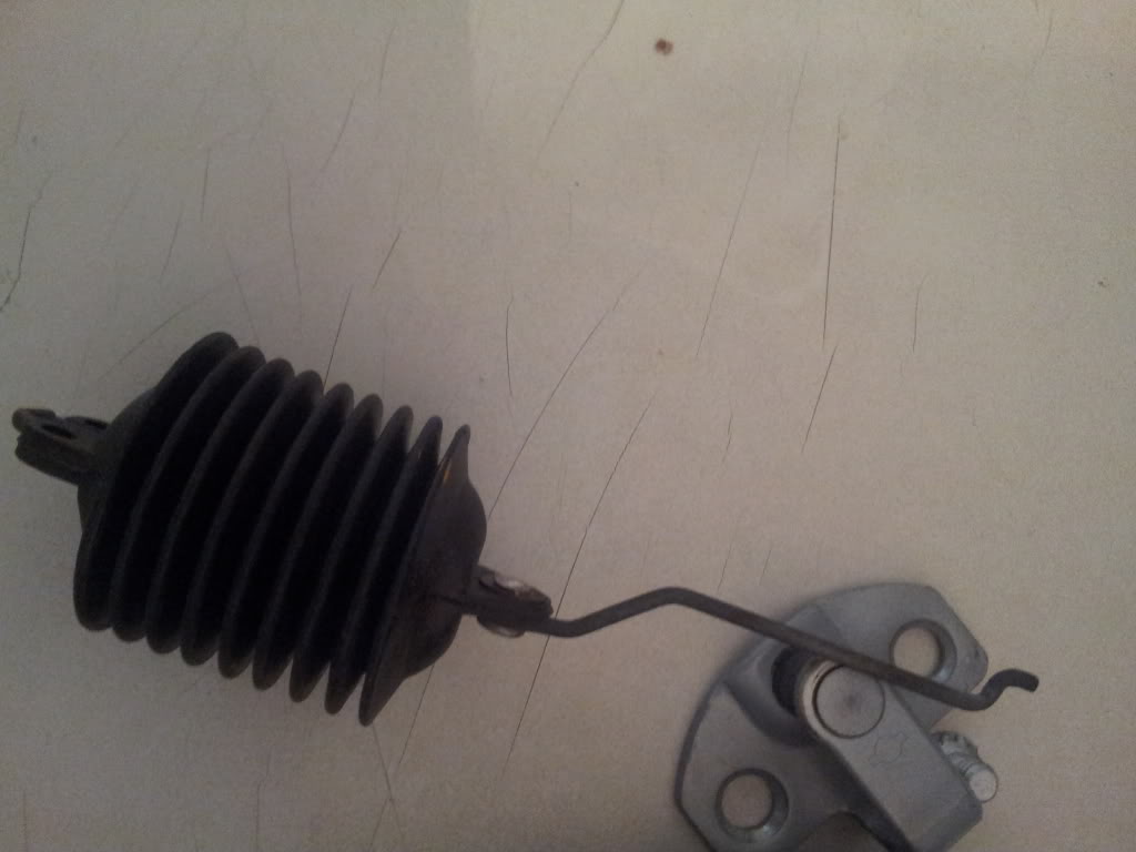

Also, this actuator
needs to be installed. It controls the face door vent for the AC. As of right now, my AC does not blow cold and only blows through the defrost vents. I have heard this is a vac leak issue. That is why I changed the vac lines in the engine compartment, but that didn't fix the issue. I hear these things like to rupture and that could be the cause. However getting to it has become a problem. If you look up under the steering wheel towards the center of the car, this actuator is the highest up. I can barely stick my hand in there to get to the screw holding it in place, and cannot see where the other side goes to at all. Any advice on how to do this without tearing everything out would be appreciated.

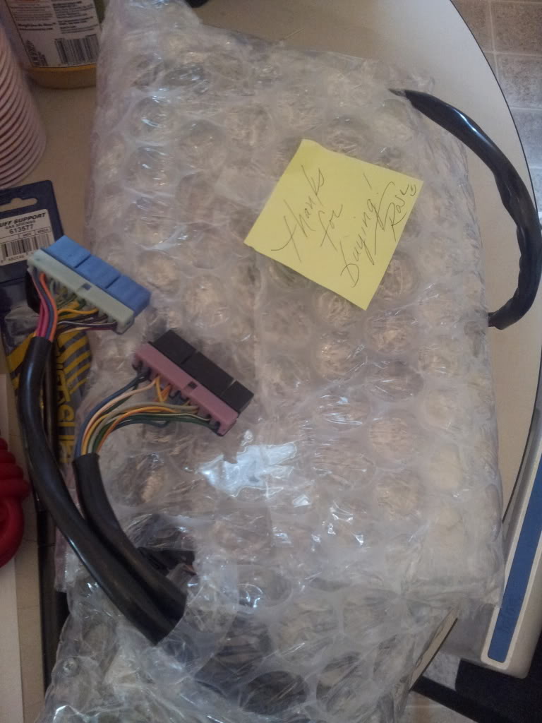

Next, I have a digital dash replacement.

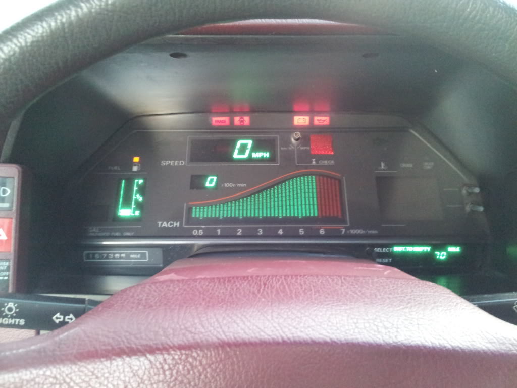

My current dash does not show the turn signals or the water temp.

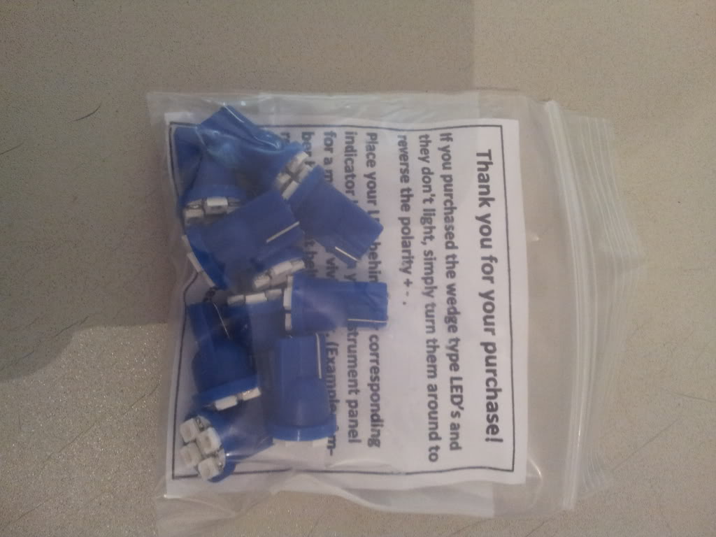

I probably rushed into buying this dash, based on my further research that the power supply could cause such issues. I was under the impression that if the power supply was bad I would be having much more severe symptoms. But, I guess I shall see. Eventually, I will take the new one apart to install these blue bulbs
that are supposed to be an exact fit for the dash. Has anyone used these before and know if they are an exact fit? I would also like to use them for the center dash gauge cluster (oil and voltmeter) as those are completely out.

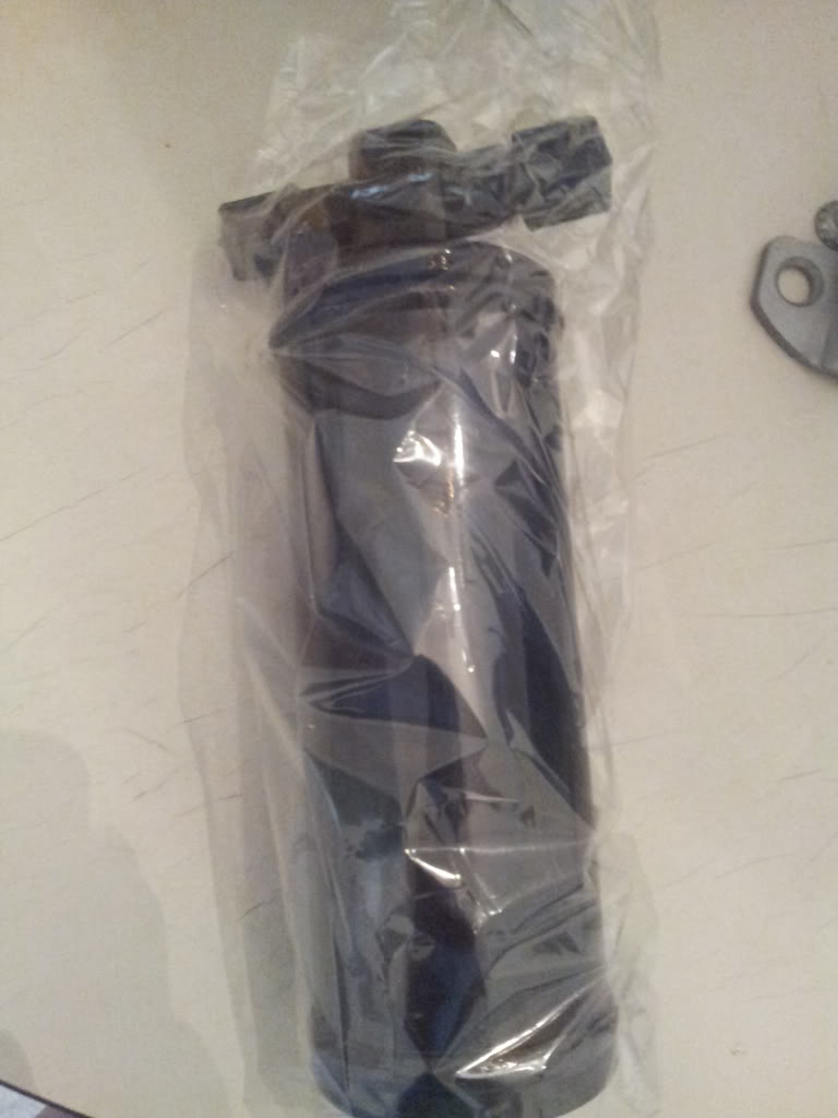

Also, at some point soon I will be converting the AC from R12. I have someone that has a vacuum that can take it out. Have a conversion kit ordered and have the new accumulator ready to go on.
I also will be replacing the hood struts at some point, and using those vac hoses in the picture above to replace all vac lines in the engine compartment.

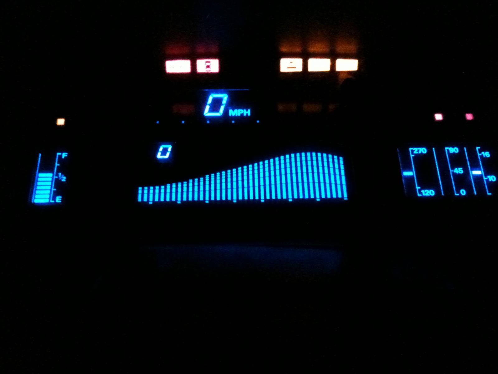

( I also saw something on some site about how to change the color of the lights. Someone had a blue dash that looked amazing. I may have to try that on the new one before I install it.)
By changing the color of the lights, do you mean the actual gauges or the background? I have experimented with the gauges myself and this is what I came up with. I ended up just sticking with the blue color.
Attached Thumbnails Happy New Z31 Owner. Now to fix some things...-img_0147.jpg   Happy New Z31 Owner. Now to fix some things...-img_1698.jpg   Happy New Z31 Owner. Now to fix some things...-img_1699.jpg

Hey the reason why your ac may only be blowing out the defrost is because of the floor vent switch is wrong, try underneath the steering heel you will see a floor vent switch, I had the exact same problem and that fixed it, hopefully it works.

With some changing of the vacuum lines I got the face vents to work but they stop working when accelerating. I'm thinking that is the vacuum pump where the vacuum lines in the engine compartment come from. Problem is finding a reasonably priced replacement that is guaranteed to work...
