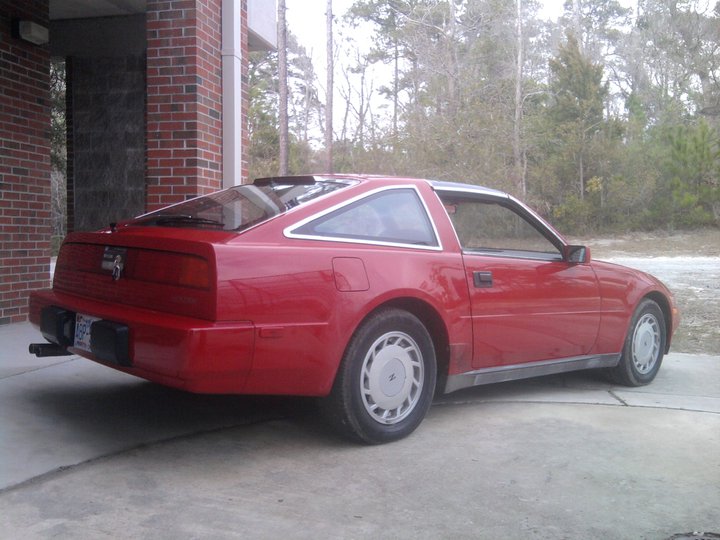

Just bought my first 300zx.
All I know about cars is the research and reading I've done the last 2 months while searching for a good Z, and the Haynes the old owner passed on to me. Here's the most recent history that I know of, do yall see any obvious maintanance needs?
She's an Aztec red 1988 n/a auto. T-Top with 95k miles.
Previous owner has all the records still, but i took notes in a sit down with him. (He's either an honest, lovable old man or a crafty sonovagun. The cars condition speaks for itself though.)
Fuel system replaced at 40k miles.
Timing belt replaced at 35k miles.
Monroe struts and shocks put in at 30k miles. (lifetime warrenty, no paperrwork though)
Transmission flushed and differential fluid replaced. (not sure when)
New brake pads at 80k miles.
Windshield wiper pump replaced at 58k miles.
Radiator replaced at 60k miles.
All vaccuum hoses replaced. (not sure when, hot air blast on acceleration issue led to this.)
Most recent tuneup done at 86k miles.
-Wires, plugs, hoses, battery replaced.
All rubber seals/dash board cover vasolined every year.
Alternator replaced last month.
10k miles on tires.
Catalytic converter is busted.
On its 3rd set of mufflers.
Interior is all stock and near perfect aside from a missing ceiling liner in the back, non stock stick on rear view mirror.
I replaced the blown out speakers but left the old radio/tapedeck.
Aftermarket CD changer is in there, feeding through a radio station, stock parts left in tact.
Engine runs smooth but idles at 500 rpm and has been stalling in park.

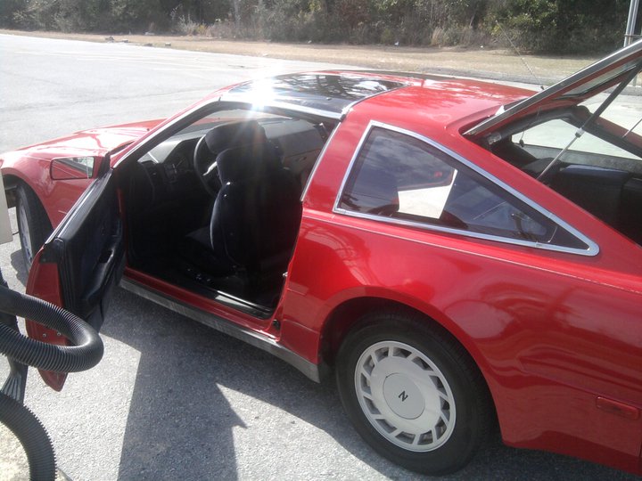

don't know what you mean by wrong thread? you are in the z31 forum which is where you belong. the z32 was from 90-96.
seems like a lot of maintenance done for a car with only 95,000 on the clock. I'm assuming you understand that 95K equates to 95,000. Or is that supposed to be 195,000. pretty sure the 88's had a 6 digit odometer. if they had to do all that I would say that poor car been rode hard and put up wet more than once. If all that stuff HAD to be done I think the car would have more like 250,000 miles on it. anyway good luck on it. you probably want to download the fsm from xenon website. Do a google search you will find it. The two z31 I owned were pretty durable. 85t and 86t. buddy got a 88T with like 150K on it and he hasn't had any problems to speak of. You might want to try doing a carfax on it and see if the mileage is true. not hard to set back the odometer if you know a little mechanics. to go from 195K to 95K you only have to change the first digit. In my opinion a Z31 with only 95,000 on it and at least minimal care should have had nothing done to it but a new timing belt and tires.
Thanks. I carfaxed it before I bought it; there's an Exceeds Mechanical limits tag from 1989, clocking it in at 10k miles.
