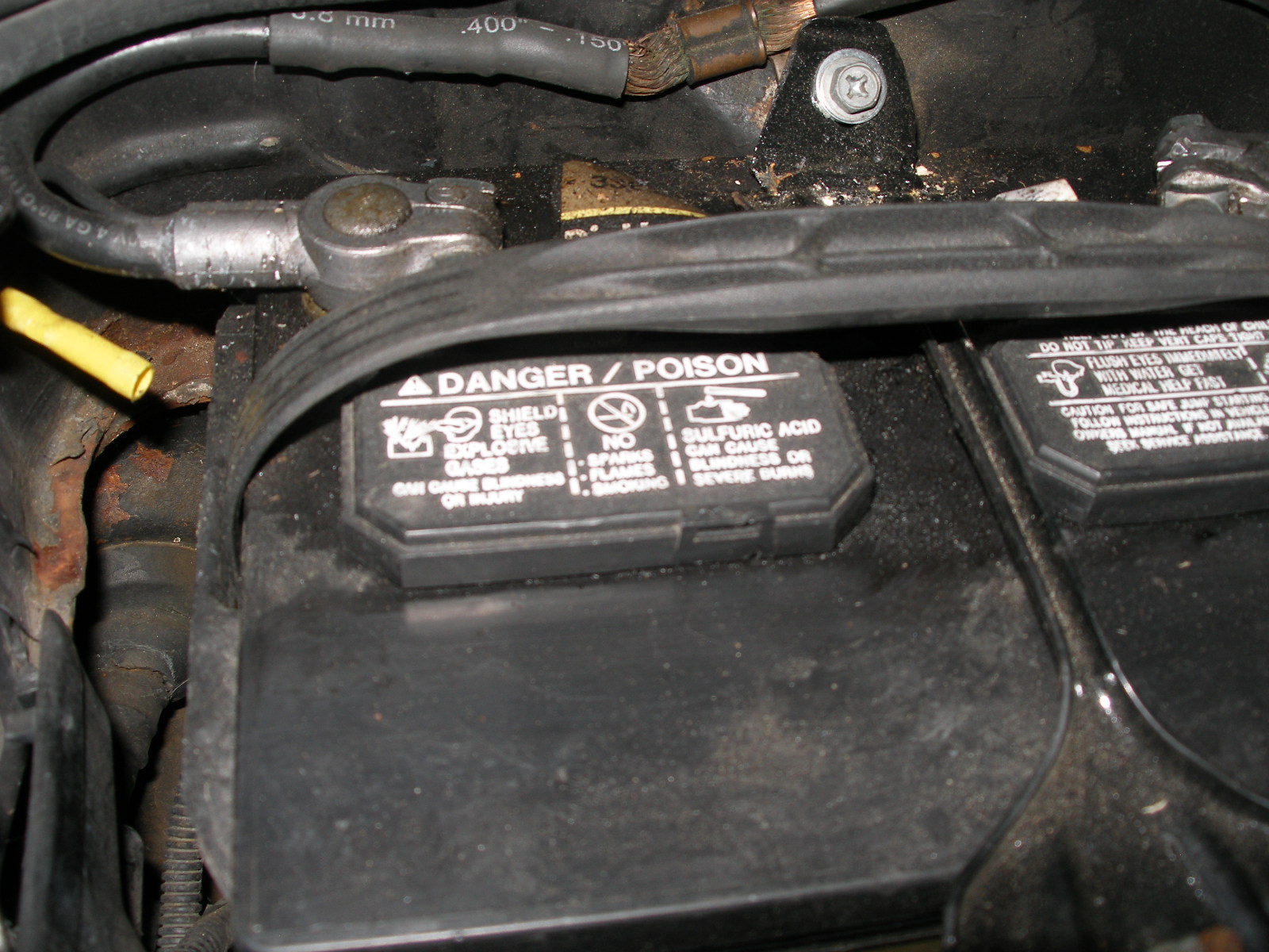

yes poor grounding to the frame will cause you lots of problems. the cable should go from the battery terminal to a ground on the frame and then to the starter. grounding thru the tranny/starter is not reliable for the electronics. the original cable had a copper piece with a hole in it crimped to the ground cable see pic this was the reliable and proper ground. If PO replaced with cable direct to starter this could be your problem.
