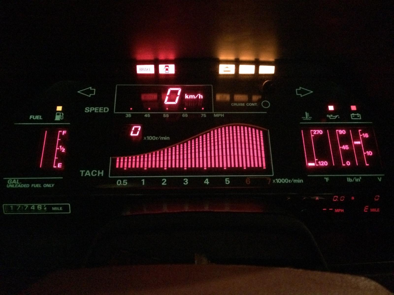

Well, here it is! I took the whole dash apart, and replaced all the green filters with red ones. This is MUCH easier on my eyes at night. I couldn't get the outline on the pods red, but that's something not remotely easy to do, plus I like how the green and red look together!
It took about 6 hours total with blood and sweat to get the desired result, however, had I known exactly how much to use, it would have only taken 2 hours.
Here is a link to the filter I bought. One layer will achieve the look I have in the pictures. Matches the red interior PERFECTLY! http://www.ebay.com/itm/331458175643?_trksid=p2057872.m2749.l2649&ssPageName=STRK%3AMEBIDX%3AIT

Looks great man, did you leave the factory green filters in too?, or did you lay the red right ontop of the lcd?

Took the green ones out. It would have been way too dark, or I would have had to use lighter reds. Not sure how that would have looked
