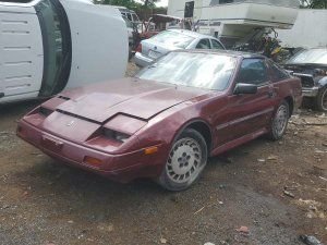

Question '86 gl 300zx no crank no start issue
DE car
Hey all, I am new to this forum and after a whole day and a half of searching for my issue, i have yet to find a forum post that "hits the nail on the head" so to speak.
SO, I have an '86 300zx turbo A/T and im having a no crank no start issue. I believe it may be the fuel pump, as When i turn the car to the on position, I cant hear it the fuel pump at all.
But what makes me believe something else is the problem as well or instead, is that when i turn the key all the way as if to start the car, it does not crank but the lights turn off like normal.
What I know about the car:
-Yes, it was a junker, but the only reason I got it was because it was in really good condition, inside and out(little to no rust even in spare tire wells)
-Im still trying to get in contact with the last owner through the junk yard, but the car looked well maintained (no cracked or brittle hoses, or belts)
-Fluids looked used but none showed any indication of damage like metal specks or excessively black oil.
- And before buying it, I was able to start it with starting fluid and fogging oil, and i started up with no hesitation, and sounded great.
- And all electronics work well, even the nagging woman.
What I have done:
-I checked all my fuses, relays, and fusible links. all good
-I tried replacing the battery. no change
-Ive checked all my grounds. all good
-And ive tested the starter. all good
-I've also checked the fsms (no haynes or chilton I havent recieved mine yet) from xenonzcar and I haven't checked the ECCS codes, as I read on this forum that they are largely useless.
I know that the car wont run with the bad fuel pump, but shouldnt it at least crank if the issue is the fuel pump?
Anyways, I'd appreciate it if anyone on here could point me in the right direction and Im sorry bout the long post but Im trying not to be as concise and clear as possible.
-Thanks Manny
