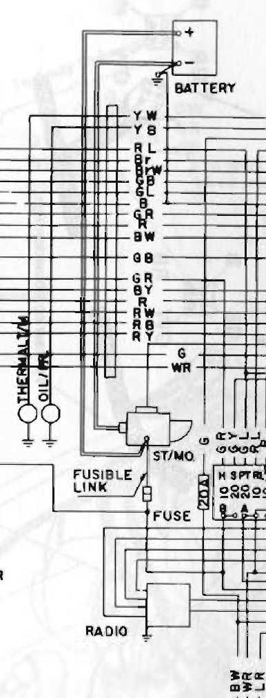

First, download a copy of the FSM from XenonS30.
Next, check your http://en.wikipedia.org/wiki/Fusible_link. It's the wire coming off of your starter. If it is bad, you need to replace it with another fusible link. Do not use regular wire.
Also, how old is your battery? Check the voltage with a voltmeter while someone is cranking the starter. A bad battery can have 12+ VDC while not under load and drop to zero with load.

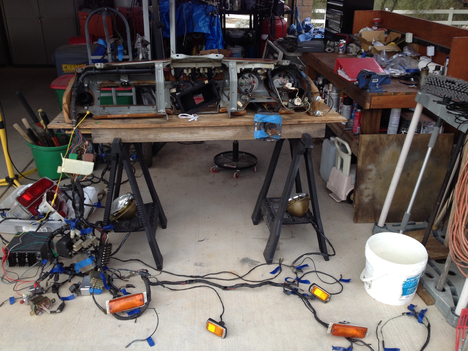

Making slow progress as I have a lot of other jobs I am working on right now as well. Here she sits.

I have to give you 20 points just for taking on a project this size. Not many of us could do it...
Congratulations and (so far) well done
Please keep us up to date on it. Amazing.
Also, gotta love that work space you got there!
You are privileged!
Congratulations and (so far) well done Also, gotta love that work space you got there!
You are privileged!
Thanks a lot. This is going to be a huge experience for me. I'm 21 years old and the most I have done in the past was buy a couple of crashed snowmobiles and fixed and resold them for some profit. Worked a couple of years in an auto shop and I'm hoping that experience will help me along. I now work as a warehouse manager and customer service coordinator. Lucky enough that the boss is giving me a corner to work on the car.
I'm hoping it's ready sometime in the spring but I'm not sure if that's realistic haha.
Congratulations on the progress, that's great! I too am jealous of the space you've got available. Keep it up.
