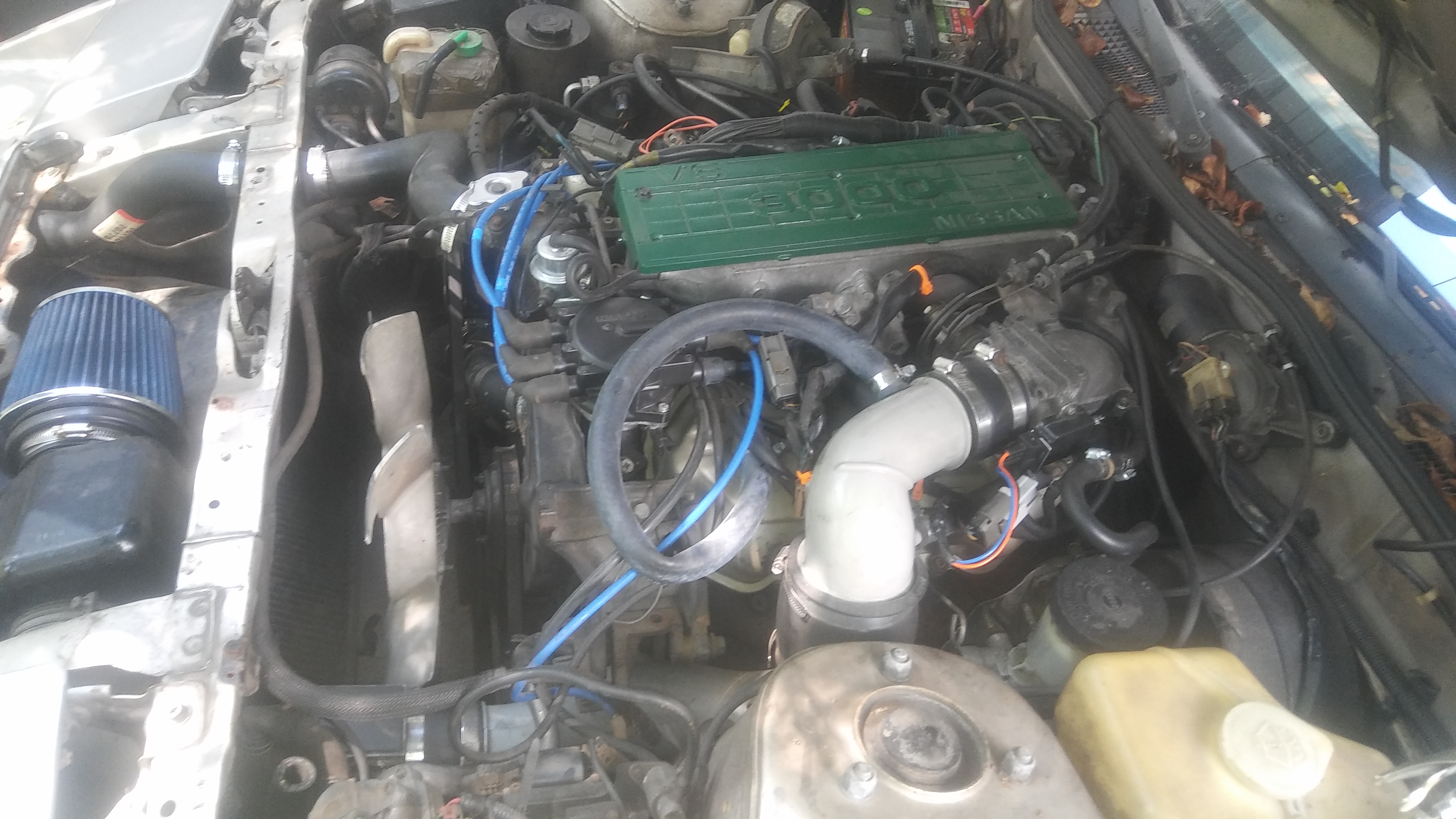

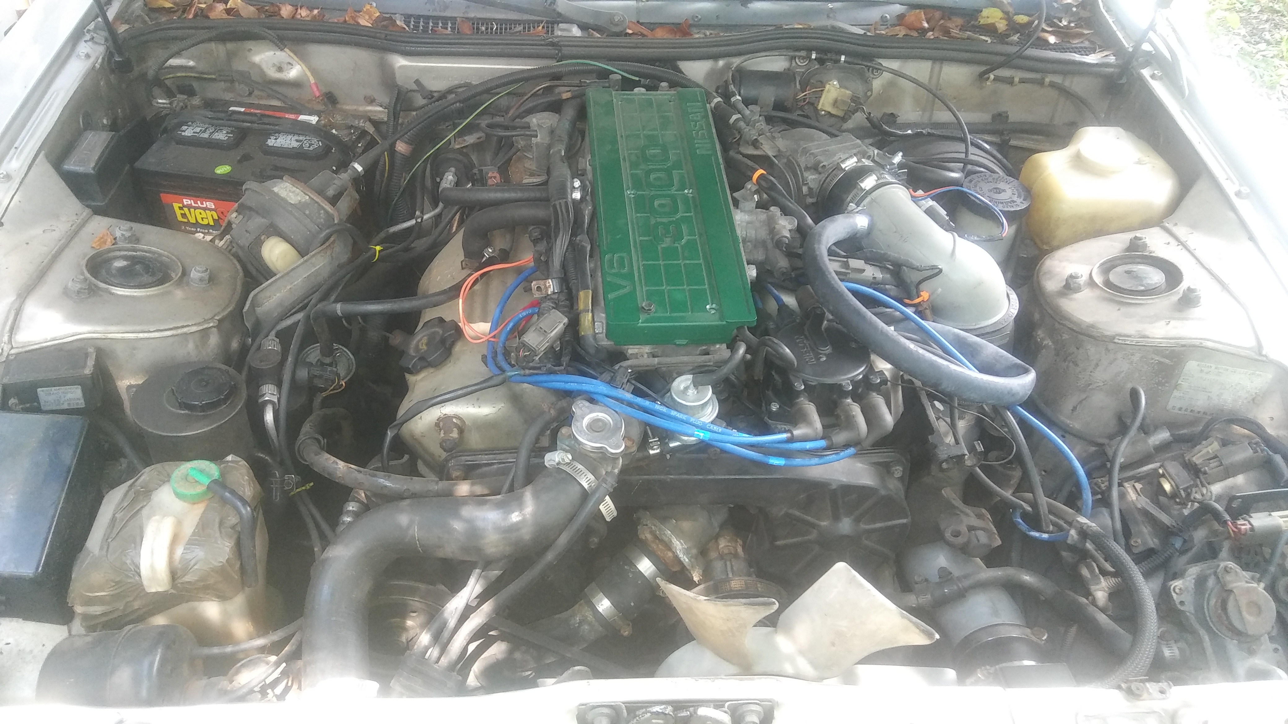

I've had this car for about a month. I can tell the previous owner was trying to troubleshoot this problem and gave up. new distributor, new plugs, new wires, all plastic connectors are new. Tested maf, tested and adjusted tps. It appears the previous owner removed a/c compressor and heater core. Car runs and drives, won't idle by itself until warmed up. Checked timing.. Seems to be on point. Very confused. Read about power transistor unit. Can't seem to locate it anywhere though. Any insight or advice would be appreciated. I noticed that plugs are ngk and oem plugs are auto lite copper resistors. Could the pre gapped ngk plugs be my issue?
plugs are not your problem. Who told you oem plugs were auto lite. disregard any information you got from that source because head up syndrome. Did you test the maf with a vom per the fsm? are you sure the intake system doesn't have a mouse nest in it. check the fuel pressure with a gage inserted twixt the fuel filter and the fpr. open the cover on the ecu and be sure no fried components therein. check (or even better replace the engine temp sensor (ALSO referred to as the coolant temp sensor. Probably not the o2 sensor but you could disconnect it and see what happens. put a vacuum gage on the system. if you got big leaks it confuses the ecu and it can't give you the correct fuel. are all you connections tight and corrosion free.? Get your battery load tested. Be sure you have clean, tight corrosion free terminals on both ends of your battery cables. Be sure the ground (negative) cable goes to a bolt into the frame before going to the starter. grounding through the starter is not a reliable connection. Z's don't like low voltage. causes the electronics to act funny. it is possible to have enough amps to crank but not enough voltage to run the electronics. If you have one size fit all cheapo clamp on terminals they are a problem waiting to happen. Usually on a rainy night around Oh Dark Thirty. previous owner obviously thought the Z was a 49 ford which had no electronics but did what his daddy did and replaced everything without doing any diagnostics. You could do the diagnostic tests on the ecu outlined in the fsm. takes two people to do properly one counting lights and the other driving safely while watching what is ahead. I caution you to take the readings you get as a big maybe because I have almost never gotten the answer to the problem after doing the test.
my guess massive vacuum leak or the fuel pressure is way low because you got fire and air or it wouldn't drive right. When you say no power under low how fast can you go? The N/A 300 is not very fast to start with. Any kid in a honda with a big pipe can blow your doors off.
