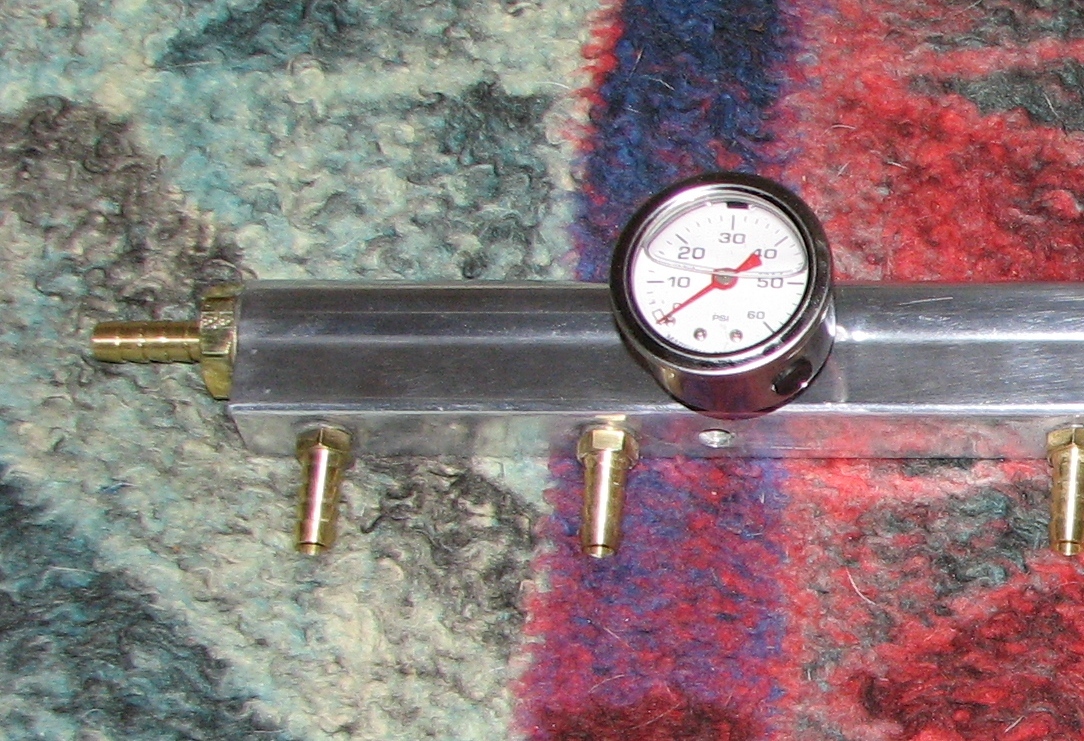

Fuel pressure gauge. It's broke. Dunno why. Probaly gonna have to fix it at some point.

I didn't notice a change, but that's a good point, if that gauge is supposed to be that way, then it may very well not be broken!

that front end def not 85. do you have four or five lug wheels. the 85 n/a came with four lug wheels. the oil in the gage is for vibration damping so actually may be a good quality gage. you must have some fuel pressure or it wouldn't run.
