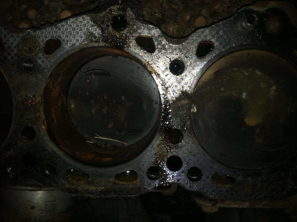

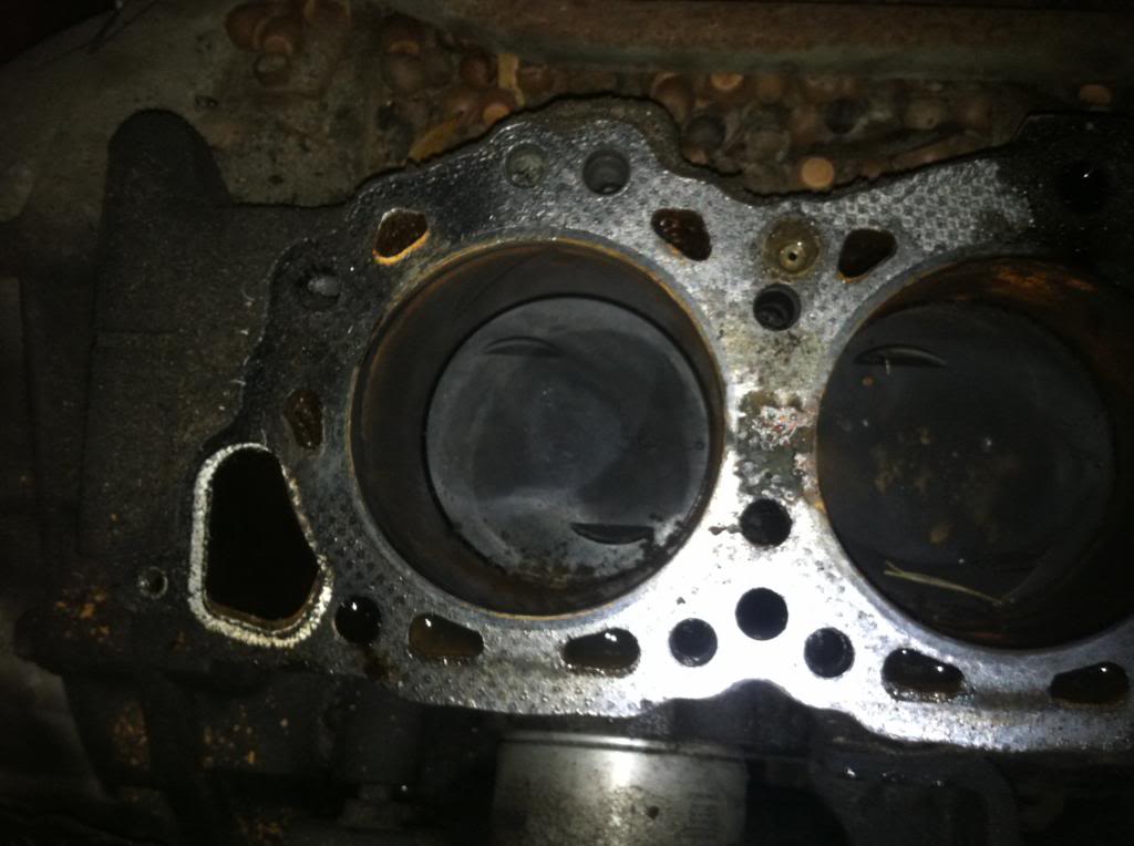

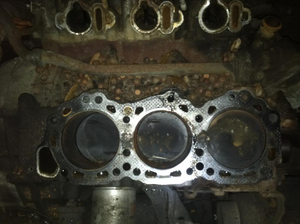

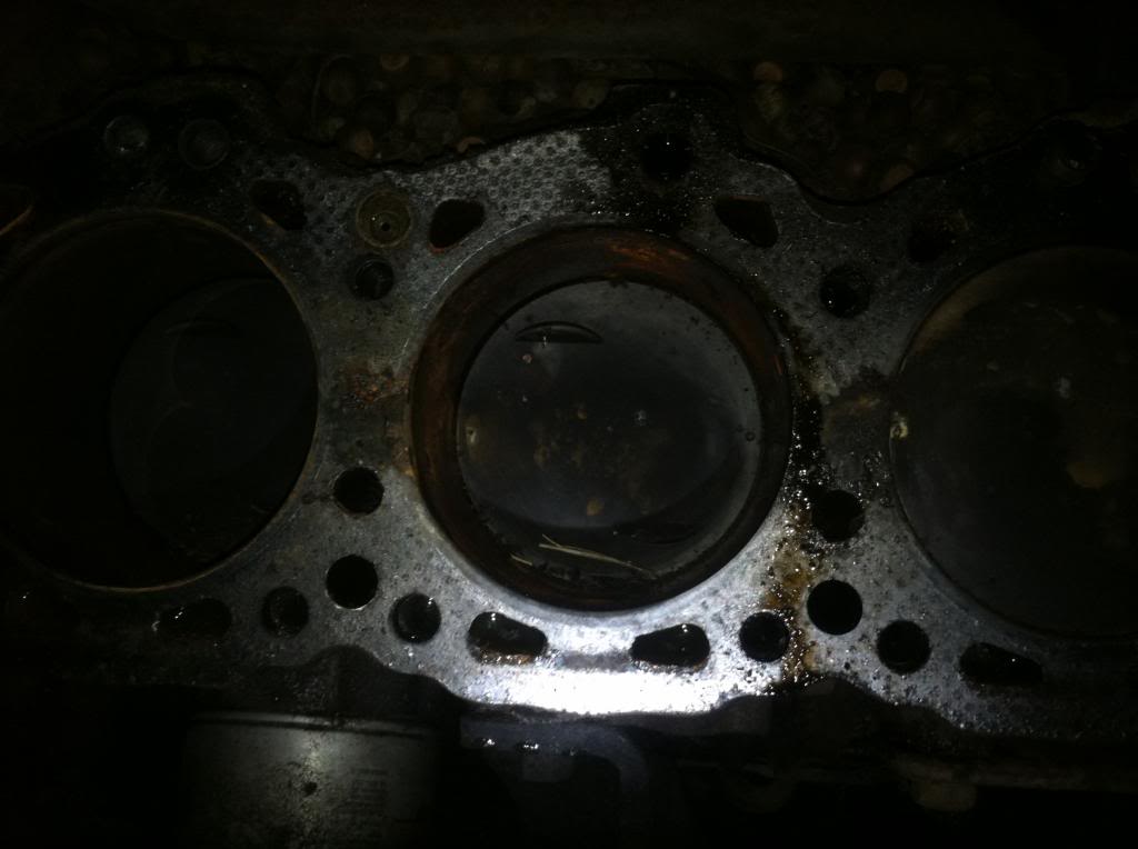

so i got the passenger side head off and its doesnt look good so far. The head melted a hole from the coolant line to cyl#1. there is a little rust in cyl#3 on the inside walls. The 5th looks the best and they dont like too bad other than the rust.

i will take some pictures of the head tomorrow.

Alot of acorns... Looks like you have some fun work ahead of you. That rust has been on the wall for some time might look into getting that blocked freshend up.

are those dings in the piston top from hitting the valves? Probably had some valves hung up and then turned over the engine. Not at all good.

The pistons have notches for the valves not to slap the piston

With coolant leaking from the jacket to the exhaust, enough to rust the cylinder walls, coolant likely bled into the crankcase. Starting the motor under these conditions has probably scored the crank journals and bearings. The engine may still run, but it's running on borrowed time. I think you need to jerk the motor and consider a rebuild. Check for evidence of coolant in the oil.

Yes there is a lot of water in the oil. Im set on doing a swap. i found a car near me running good for 550. i just have to save up to buy it. lol thanks all of you. I didnt get a chance to take pictures of the head but it is shot. and that only one side. time to hack it all up
