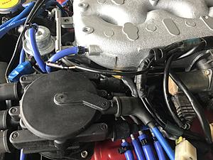

Good Day everyone,
I am working 1984 turbo Z, I notice I had wire just hanging out it located on the right drive side, group of wire for fuel injector, and ground. I can not find where this wire connect too. If anyone got 1984 or 1985 Please let me know. attach is the photo. Thank big time !!!!!!

Injector cooling fan
Looks like the connector for the injector cooling fan sensor, located on the lower intake between #2 and #4 injector.
