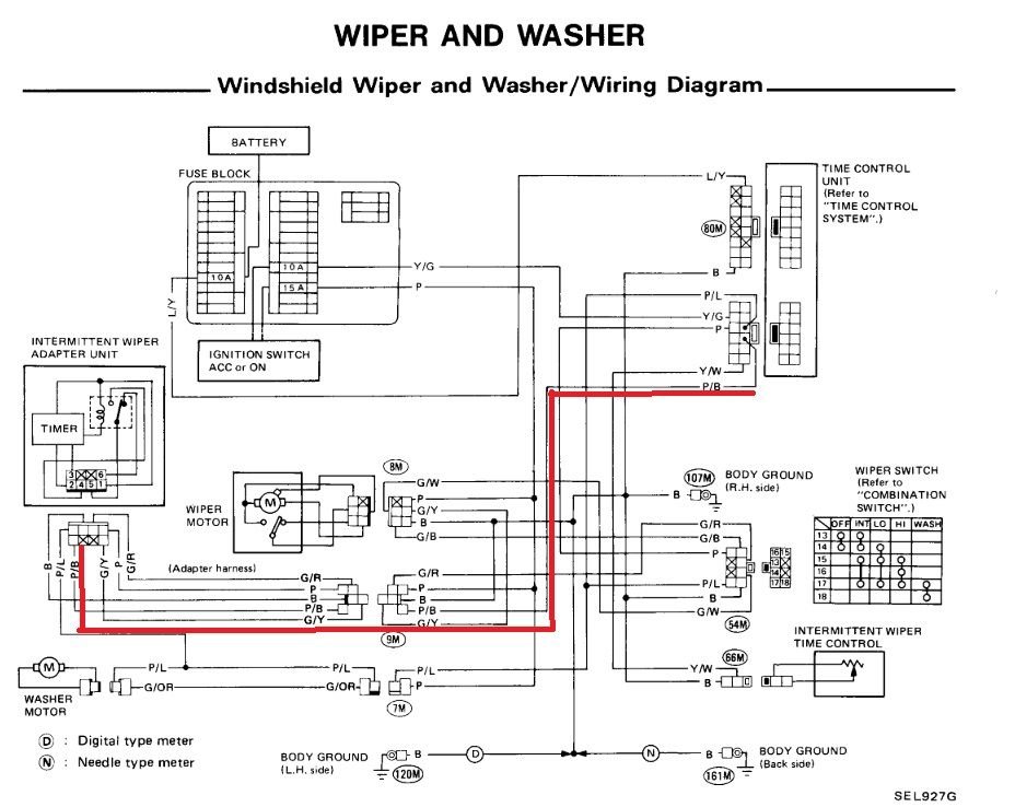

Small question, maybe someone done that. Can I remove the TCU (time control unit) from the system? I won't be able to control the intermittent mode wiper work interval, but at least it will work just somehow intermittent. I think the TCU is broken, I already connected the dash lights around it. I don't want to change it at the moment, as I will have to look, order and wait for it for some time and will have to disassemble half of the car to change it.
Correct me, if I'm wrong. I see only one wire, coming from TCU to intermittent adapter, pink-black. I can suppose, that if we will emulate there some voltage or resistance there, it will be the interval setting.
