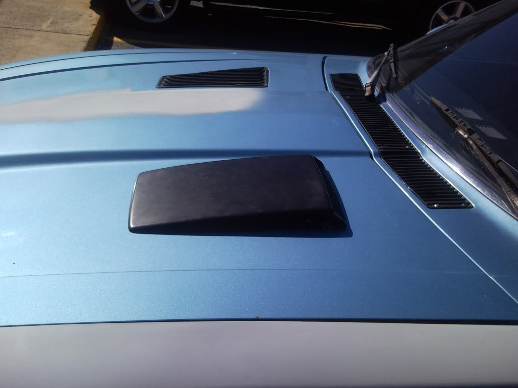

what if i put the hood scoop like this?:Name:  Hoodscoop2.jpg
what do you think would be the effects as compared to facing forward?
yes i stole the pix from another thread sorry if it offends anyone.

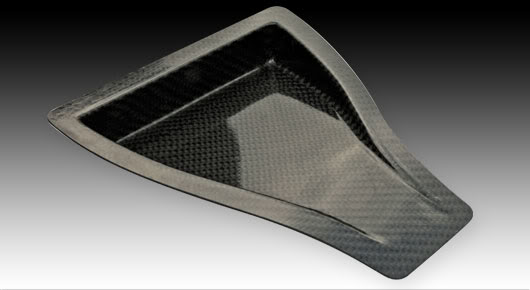

BTW: The 280ZX turbo scoop is a NACA duct.
280ZX turbo hood scoop:
NACA duct:
I believe that's called being PWNED!
Attached Thumbnails hood scoop or vent?-82_zx_hood_scoop.jpg   hood scoop or vent?-naca-duct.jpg
