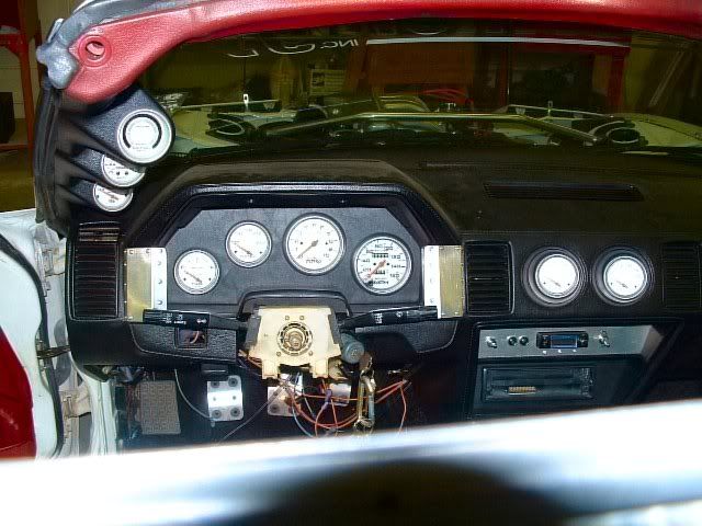

Click this link to view one of my setups since for some strange reason the IMAGE CODE IS OFF in the APPEARANCE catagory. Duh-huh!!

Checked my notes today... The fuel guage will not work with the factory sending unit. I bought the Autometer universal sender and made it fit the tank and bought the correct guage to match. Speedo. I bought a Nissan speedo cable and an Autometer mph, and just hooked them together. The guage uses a thread on cable, but the Nissan one is a clip on. Just slide it on and put a hose clamp on there just to make sure it does not come off. Oil pressure will require placement of new sender as well as water temp. That about covers it.
As far as wiring.... leave the harness that you have in. Find a diagram. Pull the correct wires to wire guages.... Idiot lights are optional!
