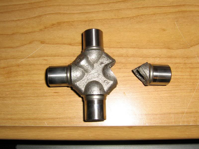

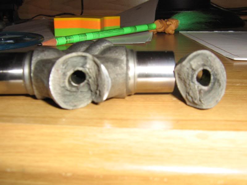

always check everything, to have it fly out is amazing, good thing it didnt lodge and send you spinning. for the driveshaft you can have new joints put in, you dont need a complete shaft. to properly check a u-joint you must remove the shaft from the vehicle and test it range, then vise it and see if it has play. there should be none. as far as the diff, pick up a haynes manual, it will be your bible for all things for your car. some whine is normal, but turning up the radio should take care of that heres one of my half shaft u-joints enjoy
