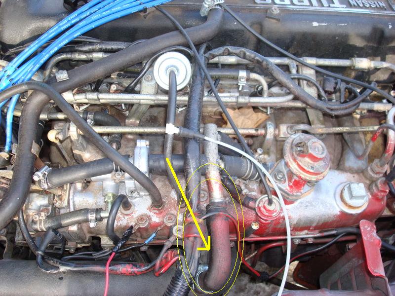

This??? (see yellow arrow)
It's for the air regulator / AAC. If you don't have it, you've prolly got idle probs.

yes that... my car does NOT have nor EVER had that. but i DO have an AAC valve and i do NOT have idle problems. i'm just curious cause i got another j-pipe off ebay and it has that nipple.

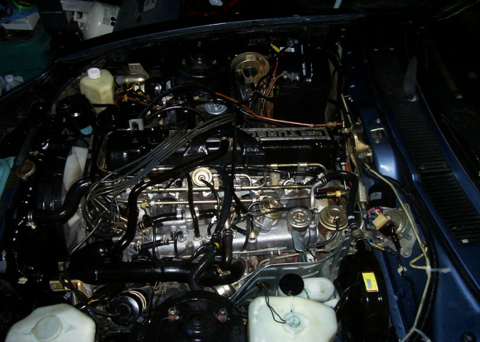

Post a pic of your engine bay...
Old Jan 18, 2008 | 09:04 PM
DriftZ83's Avatar
Joined: Jan 2008
Posts: 66
From: Big O!
duh.. i'm retarded!! i guess i've always looked past that... i've NEVER noticed that on mine before and i was work'n on it tonight! lol sorry
Old Jan 18, 2008 | 09:07 PM
And that's the end of that chapter.
PS... clean engine bay!
