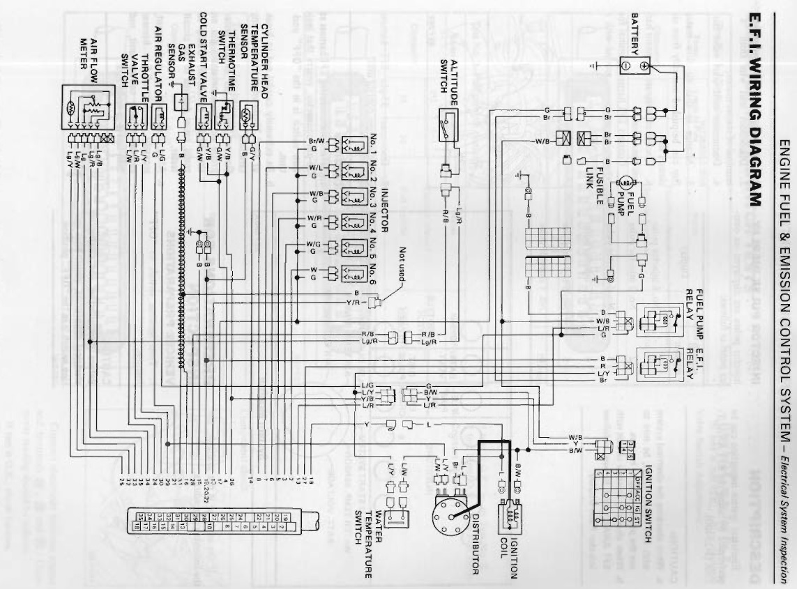

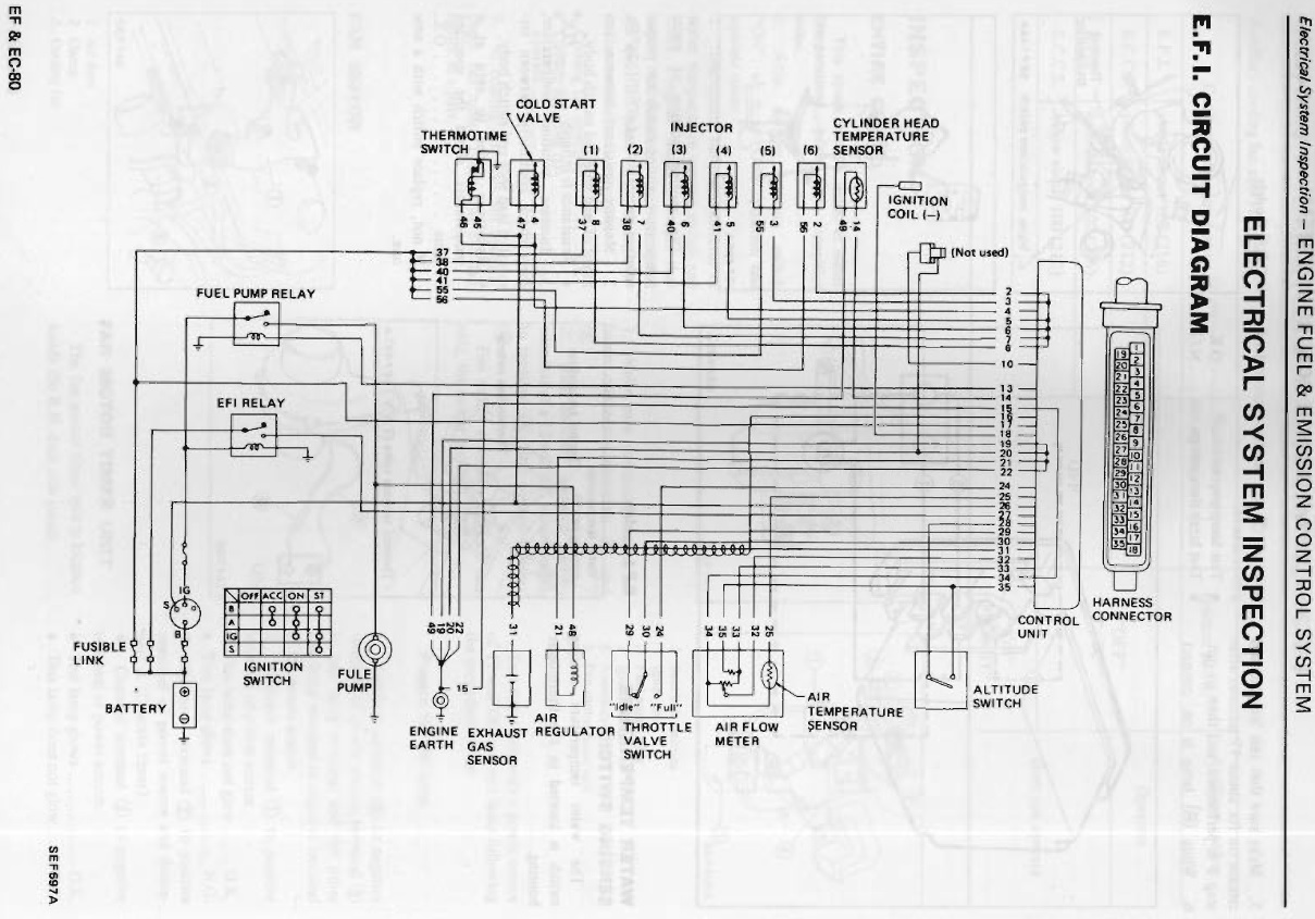

I'm quite confused... Are you / is your mechanic using the FSM wiring diagrams? It seems that you are not.
83 N/A EFI:
#34: To AFM
#17: Direct battery power thru fusible link *NOT GROUND
#5: Ecu ground signal to injector 4.
Please make sure you've downloaded the FSM here: XenonZcar.com S130 Factory Service manuals
