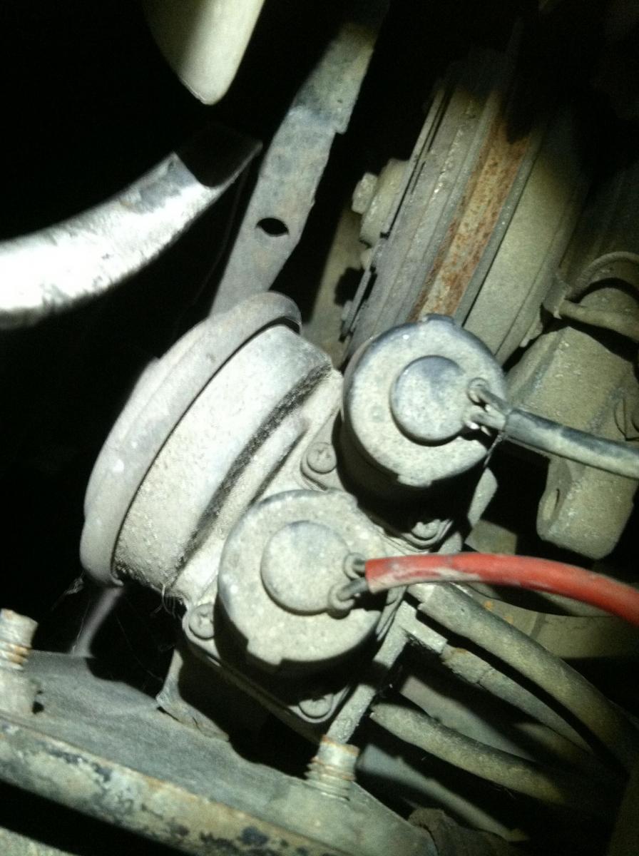

what is this electrical device callsed???, it sits underneath the air flow sensor
Attached Thumbnails Trouble accelerating past 3k rpm...-img_0635-small.jpg   Trouble accelerating past 3k rpm...-img_0526small.jpg

vac tank vac pump. keeps vacuum up when under boost to make the climate control operate. here is some general advice that will make you happier with the car

Nope it's the Vacuum Control Module (page EF & EC-69 in the '83 FSM - XenonS130)
