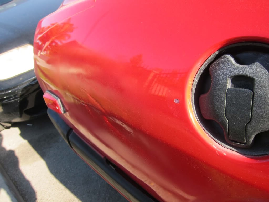

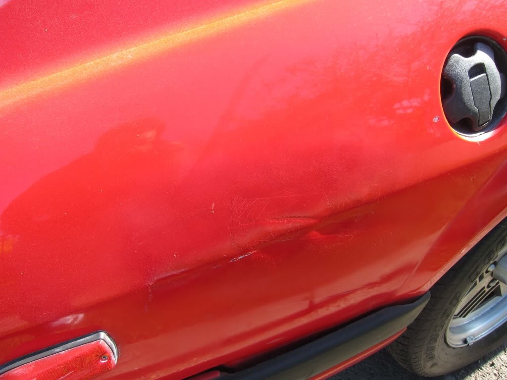

3. The car has been repainted many years ago. Seems fairly rust free with the exception of some bubbles right above the windshield and the rear passenger quarter panel has a weird repair I can't identify (picture included). Is this rust? Or just a poor repair of a dent?

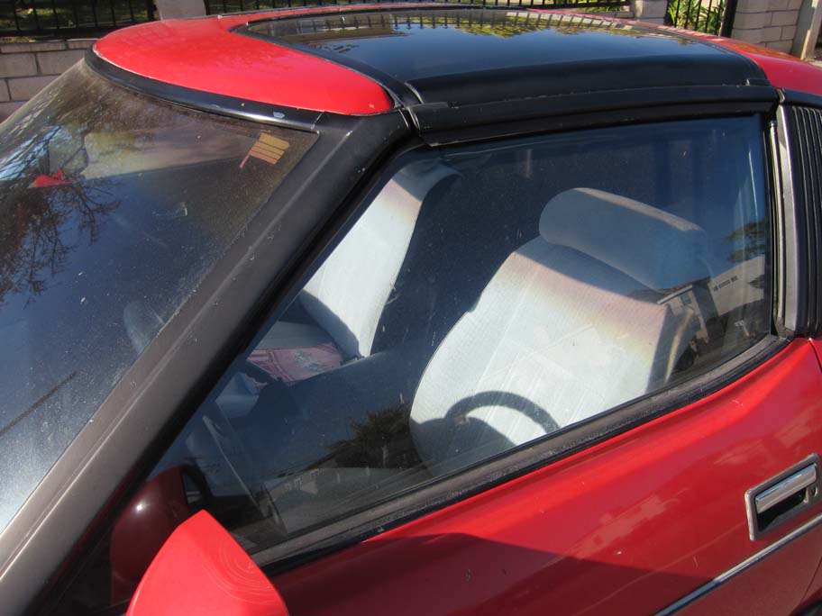

Rust around the windshield is normal but a pain to deal with...

$3500 is stupid high, maybe if it was mint but not for that car. I'd probably give him a grand for it assuming it runs decent-ish and it's not all rotted out. It looks okay from the pictures, body looks decent from what we can see. I wouldn't worry about that weird repair being rust, looks like there was a dent that scratched through the paint and he just masked off a rectangular area around it and spray painted over it.
