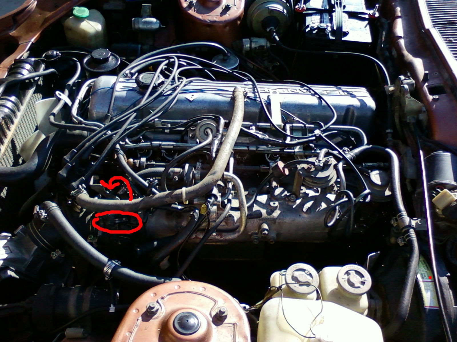

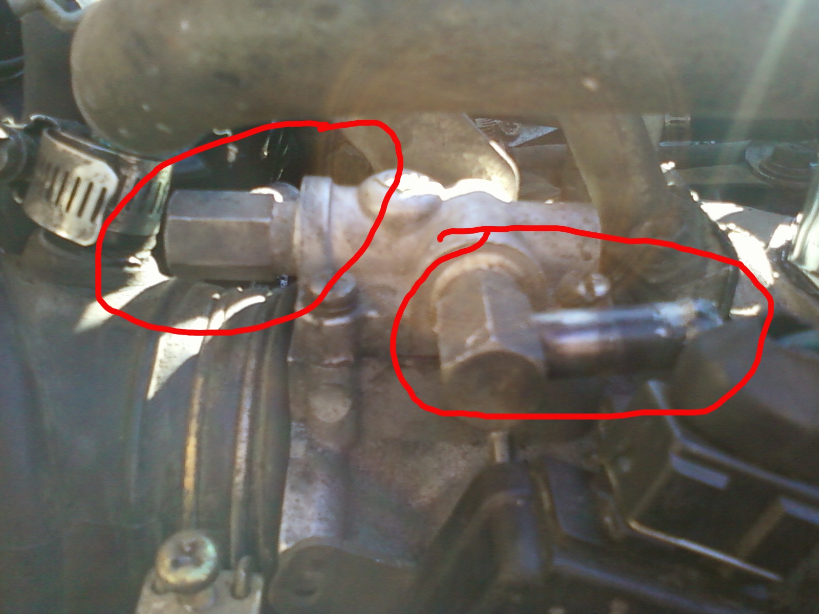

Hi all, been lurking for a while, first post maybe covered somewhere else, sorry if it is. Bought an '81 280zx 2+2 for my dad's birthday, poor thing looks like it was scrapped together from a junk yard, finding all kinds of fun stuff that isn't hooked up, blocked off, ect. ect. so i'm fixing the mistakes of someone else. right, got almost everything plumbed together the way i think, for CA smog req. but on top of the throttle body are two ports,.. i can't figure out where these are s'post to go for the life of me, they are a little rusty/corroded so i'm assuming they had coolant going through them at some time. i may be completely wrong. anyone have a guess?

pictures of the port, valve, thing,...
Attached Thumbnails throttle body help-enginebay.jpg   throttle body help-unknowenport.jpg

Those are the coolant ports. IN from thermostat housing, and OUT back to water pump inlet.

thanks much, confused now, because the line's I'm assuming these go to, appear to be connected to something similar beneath the IAC.. is it ok to leave them un-plumbed?

#1 comes from the thermo housing, 2 goes back to the water line on the pass side of the car. its beneathe the idle air control valve.... got everything hooked up, car runs nicly, but is starting to over heat. probably why the po didn't have a thermo in it...
