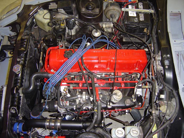

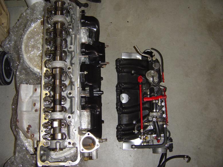

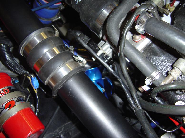

yep... I re-routed the coolant from the air regulator directly back to the thermostat housing. No need to intercool the air, then heat it back up!

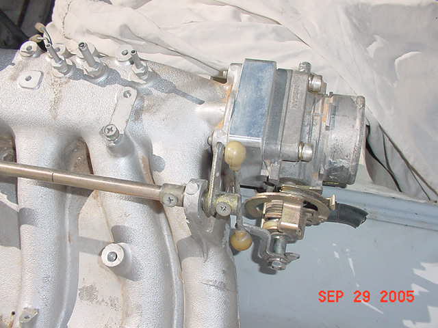

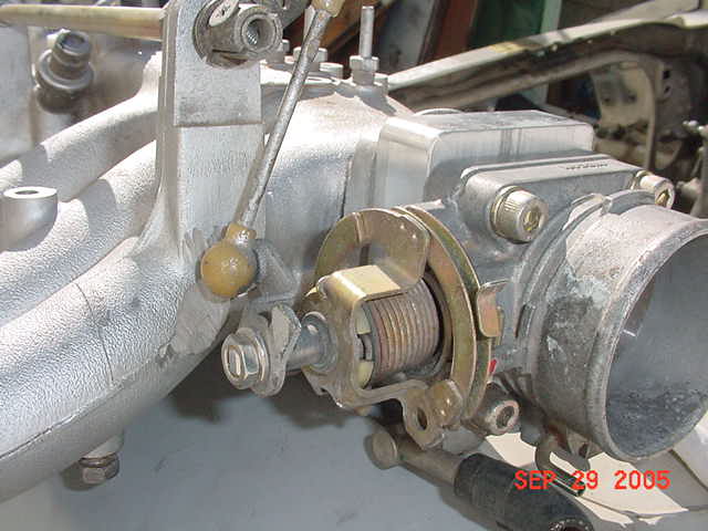

Again I was lazy but this is how mine ended up at the end... You can see where I grinded the manifold for clearance..
