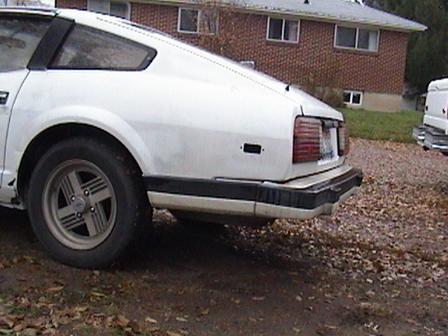

I didn't know if I should start a new thread or not, but I was looking at the rear of my car. It still has the rear panels on it mind you, but I took this pic from Nismopick's cardomain.
Now the area in green that I've kinda hihglighted seems like there's something there that I can just push my finger through. By Nismopick's picture here it looks like nothing ever existed in that spot unless it was cut out or something. I can push my finger through what feels like a super thing layer of something and rach through and touch my finger to the panel behind it, I go up a little higher and it's all oxidized , but that all feels really sturyd. Can anyone elaborate on this? I know you guys all say like rusted frame rails and stuff aren't such a big deal. Rust in the area or around the area I've highlighted. Is this a big problem? I'm feeling like wgc_3 at times, and beginning to wonder if I'm getting into something that's not worth it? I'll try and get some pics but my rails, and pans seem like they're in very good shape with just very minor surface rust that I could cleanup.

I think this is the pic?
And you are talking about the green part? That was all rusted out & I had to fab up several pieces to meet the quarter panel. That was back in 98 (before I had a digi-cam) so I don't have many pics of body work. I will try to take some pics from the underside today.

ahh that would explain it. Yeah that's all rusted out on my car too. Unfortunately I really have not a clue or the tools to do that kind of bodywork. It still seems like parts of it are solid and it's still matched up, but I'm wondering is this something that's gonna be a big pain or something that really would make the car end up costing me more or make it not orth fixing rather than finding one with less rust? Or are these parts being rusted out not as big a deal as I'm thinking? Also whent he quarter panel was removed, did it have to be cut out, or can it actually be removed?
Old Nov 11, 2006 | 11:56 AM
280zx quarter panels are a pain, so if you don't have auto body repair experience, don't do it. You need a spot weld drill, pneumatic hammer w/ chisel, body hammers & dollies, torch, welder, duck billed clamps, etc etc etc... Unless you are going to restore the whole car back to OEM or better, it's not worth it. The $500+ cost per panel isn't so pretty either. You could fab your own patch panels, or take it to a body shop... but taking it to a shop will be super pricey too. My advice, scrape off the loose rust, metal treat it & paint it w/ some good sealing paint.

well all that aside, how serious is it with the quarter panels rusting like that? It looks almost like there was never much metal there to begin with and hencey why it rusted through so easily.

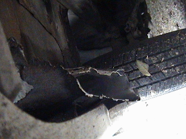

yeah my whole piece, under the bumper ext. were rusted away so i took a cut off tool to it, and i think it looks much better...but now i have a whole back there.... oh nismopick you wanna weld them in bro...that'd be nice of you....i'll have pix later raining outside.

that's actually not too bad, it would just depend if you supplied the metal and such. oh and in these pix's they show the cut off back lower qtr. panel, and hole resulting...maybe i can get some money for that welding job...nismo.

hey if someone wants to help me weld in patch work, I'd be more than willing to pay for it By the way if that lower part is rusted and it's not touching the quarter panel, is that really going to matter much?

I'm talking more about the piece underneath. Like in the picture I was showing the quarter panel? I believe is removed. The piece behind that is what's rusted out. The actual quarter panel itself is all there and in relatively good condtion. I'm wondering though does anyone think that a shop could patch it up or repair it and keep the cost under $3k? That's kind of a high shot, but I do love the car and literally if that's all I need repaired like I think. Then it'd be worth it. Otherwise If someone is actually willing to I'd drive my car up to them and pay for materials and their service in helping me repair my car. Plus I could prolly learn a thing or two about body work.
Old Nov 12, 2006 | 10:45 AM
For under $3k yeah... A body shop WILLING to do the job would prolly charge $700 - $800 to do it. I say "willing" because a lot of body shops aren't willing to fab up custom panels on a rusty car. Their job is "Auto Collision Repair."

did you look at my pix. i have neither the qtr. panel nor the wheel well extension. look hard, rust happens, just replace the panels cause you probably won't find one much better. for the same price range. i'd just wait on fixing rust, until you find a welder man....or drive out to nismopick...
