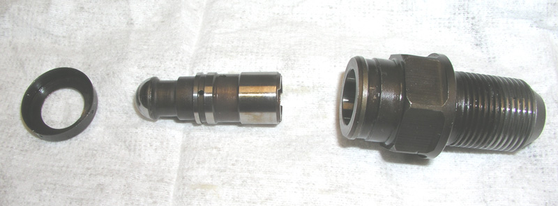

Originally Posted by duowing
So basically skip the ATF/Seafoam idea, put some Royal Purple in and just change it like normal every 3000 miles for a while and I should be good? I may do that.
I would still run some ATF through. I remember seeing that thread on Hybridz about cleaning the lifters and I think to really get them cleaned, you'll need to take them apart. I doubt there's any oil or cleaning agent that will remove as much gunk as doing it by hand.
I think this is a pic from that HBZ thread...

Yeah I found that thread on HybridZ by search ticking hydraulic lifters. I'll run some ATF through before I change my oil then switch over to synthetic and see how that goes.
