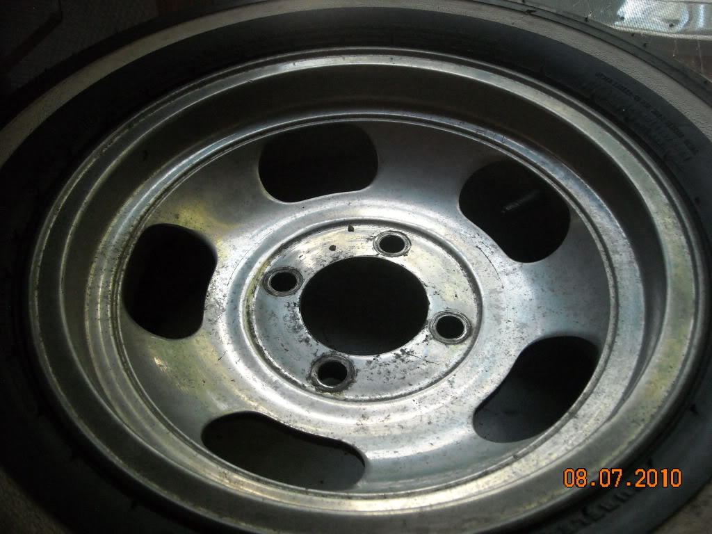

These are the wheels that will be on the Z, as soon as I get lug nuts that fit the Zs threads instead of the Mustangs. The stock Z wheels will be put on my Grenada to wheel around with. And may eventually go to the scrapyard with it. I dunno yet. I dont really like them.

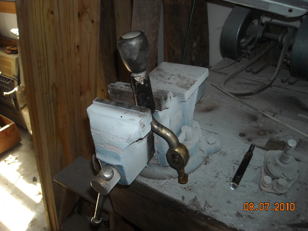

Here is my homemade Short-Throw Shifter. I cut down a mid-80's or early-90's Nissan PU shifter, and JB welded my original shifter ball. I think there may be some issues with how far forward/backward it can go, but I'm not for sure. I think that was more that my tranny was screwed up than the shifter not fitting. It makes the throws VERY short, and fits comfortably in the car. So i'm happy atm

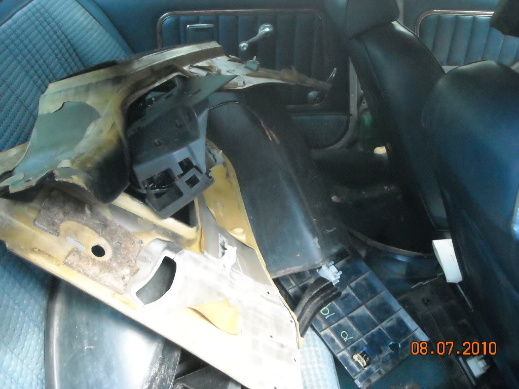

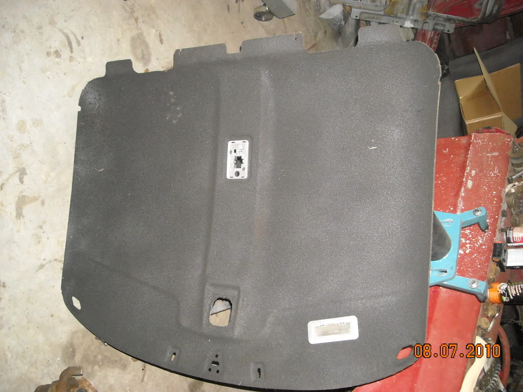

Here is my headliner, currently coated with 3M rubberized udnercoating, so its black.. though I found a great way somewhere on how to recover it, so i think im gonna do that.

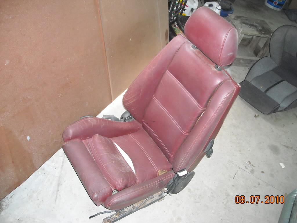

My red leather seats out of a 1991 BMW 325i convertible. They are in pretty bad shape, but still comfortable and still supportive. I cant WAIT to have them professionally redone! This is thepassengers.

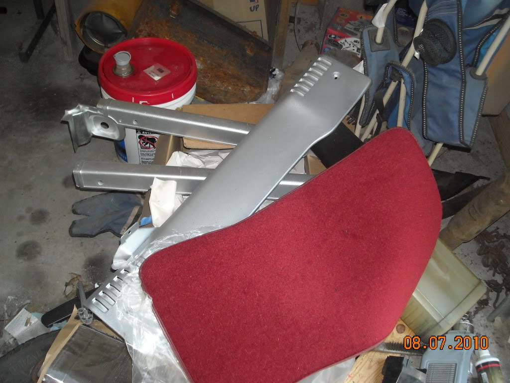

bought this set of red floor mats form Black Dragon. They look sweet, inside my black interior.

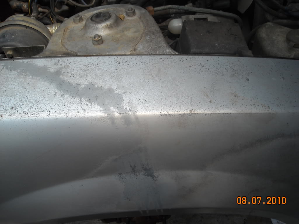

This is the second color in the two-tone scheme. Inferno red, a Dodge/Chrysler color. Its AWESOME and possibly the best spray-paint job I've ever done... but still textured... so when the car gets repainted, so does the mirror! pro!
This is where I spilled battery acid on the fender.

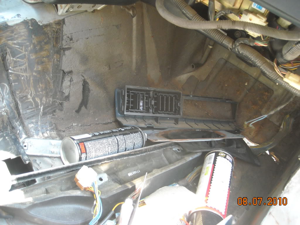

This is my passenger side floor. It needs ALL of its silver alid down, because I still ahvent bothered to fix its gaping hole that you can kinda see. Gonna hit it w/ bondo and sheetmetal.

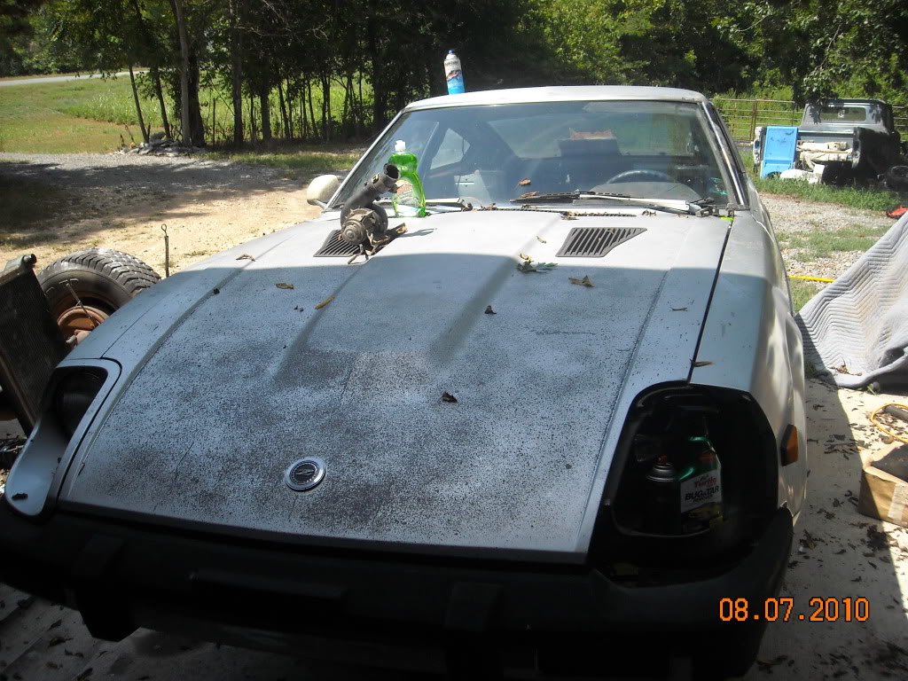

And here's a head on-ish from my Z... its missing a sugar scoop cuz its in primer right now. Its gonna be red. ALso, that thing on the hood? It has something to do with blowing air onto the intake manifold, I think. Therefore, I am gonna hook it up to the air inlet on the hood, easily disconnectable though so I can still open the hood.

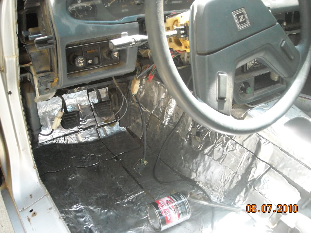

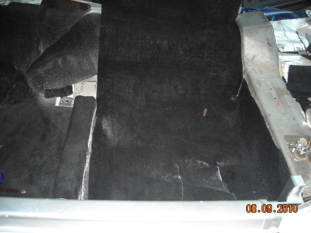

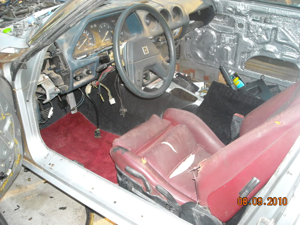

okay, looks like I'm double posting again.. jeez... Firstly, I have discovered I am rocking an N47. Is that good?
Using this...
I went form this...
to this...
to this in a few hours time.
Save some trim, the driver side is now put back together. Transmission, you better hurry up!

I know you've already got your carpet in but for future reference you can actually make your own single piece for each side. In behind the seats is a pain but doable. I use the old carpet as a template then it goes inside the foot well and I measure and poke a few reference holes in the back where the carpet folds together by the gas pedel, etc. Then you cut the triagle section out so that when you put it in the car it lays down and buts up to itself. Once you are happy with the fit you use contact cement on the back where the seams are and a strip of carpet about three inches wide with contact cement on the back of it the same length as your joint. Butt the joints together and lay the strip on the back of it and it will hold the joint together - now you've got your own molded carpet!

...oh yea and for the dash - no big deal on not grabing the black dash. Get a black dash cap from MSA. It's not unlikely that the dash you were going to pull was cracked or will crack in the future so you're saving yourself from doing the work twice. Pulling the dash is some work the first time but it's not as challenging as I thought it would be....

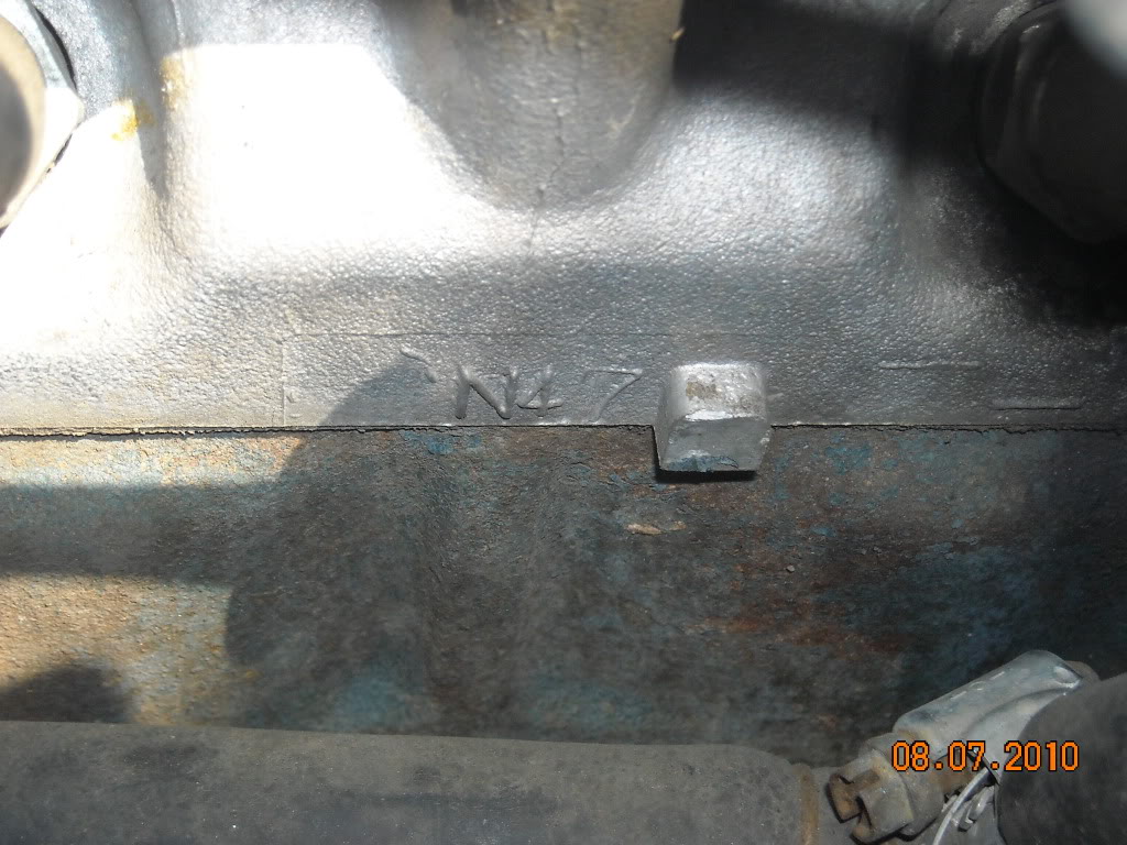

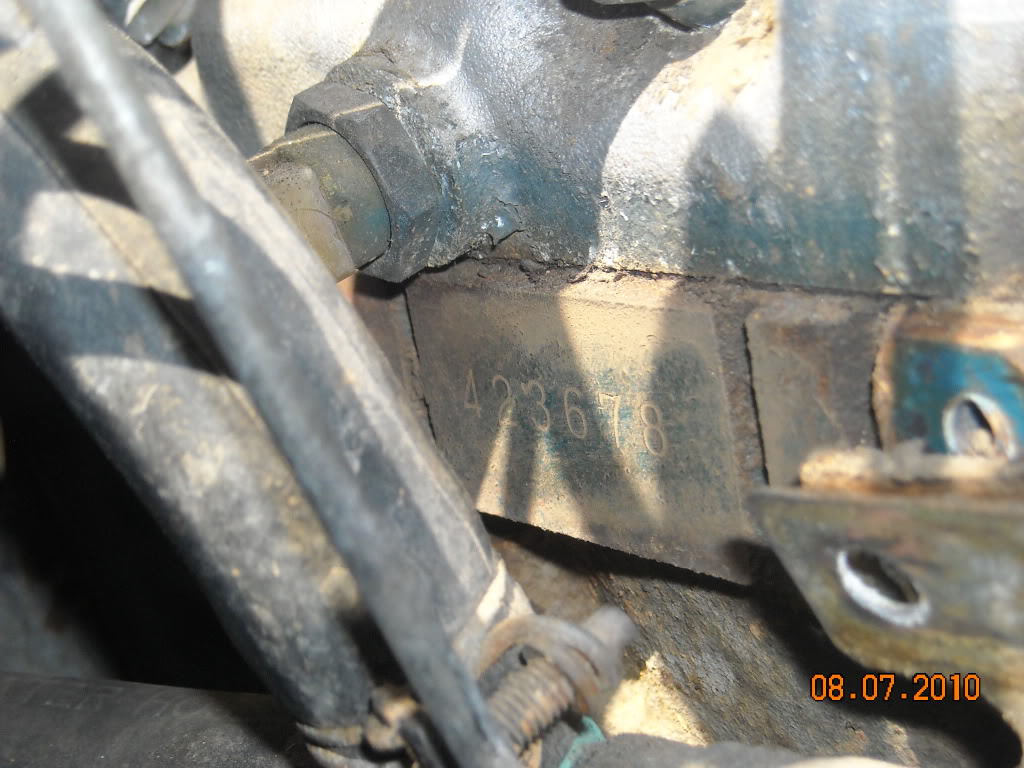

Oh, and I think ive got the wrong idea. The N47 was cast, ive got a picture around here soemwhere, but the term "N47 Block" gets zero hits...
I feel very noobish right now. Is N47 a block or a head, and if so, which would I have? Here are the pics, one of the block number and another of the N47.
The part to the left of the 6 digits says L28
Actually, I think I have it. N42 is a block, and the heads it came with are both N42 and N47, presumably depending on how late in the run of N42s it was made. And since my car, i believe, was made in August of 79, that would give it the N42 block with N47 heads... i think.

Well its a little strange but Nissan had both a N42 block AND a N42 head. You probably have the N42/N47 combo....

N47 is not the block, the block casting number is on the left side of the block. N47 is the head.

So, what is the common consensus concerning the N47 head, and the N42 block? My goal, as some of you know by now, is a Stroker motor similar to the build hinted at by this guy here, and the mreo i read the more info i find, and the more I cant freakin wait!

N42 blocks are better for strokers, N42 heads are also the best for all out NA horsepower, but only if you know someone who could weld the chambers up similar to how P90's look, but P90's and P79's will work just as fine.
