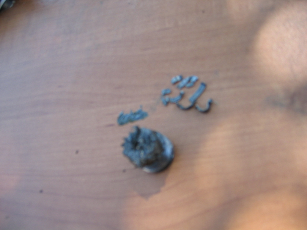

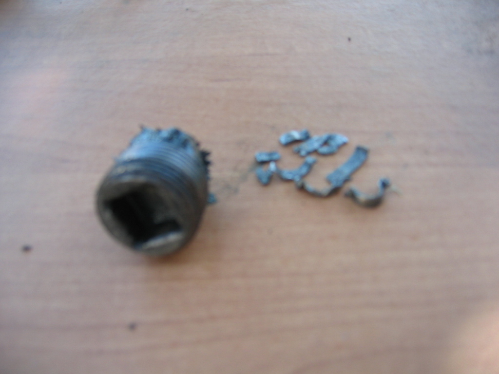

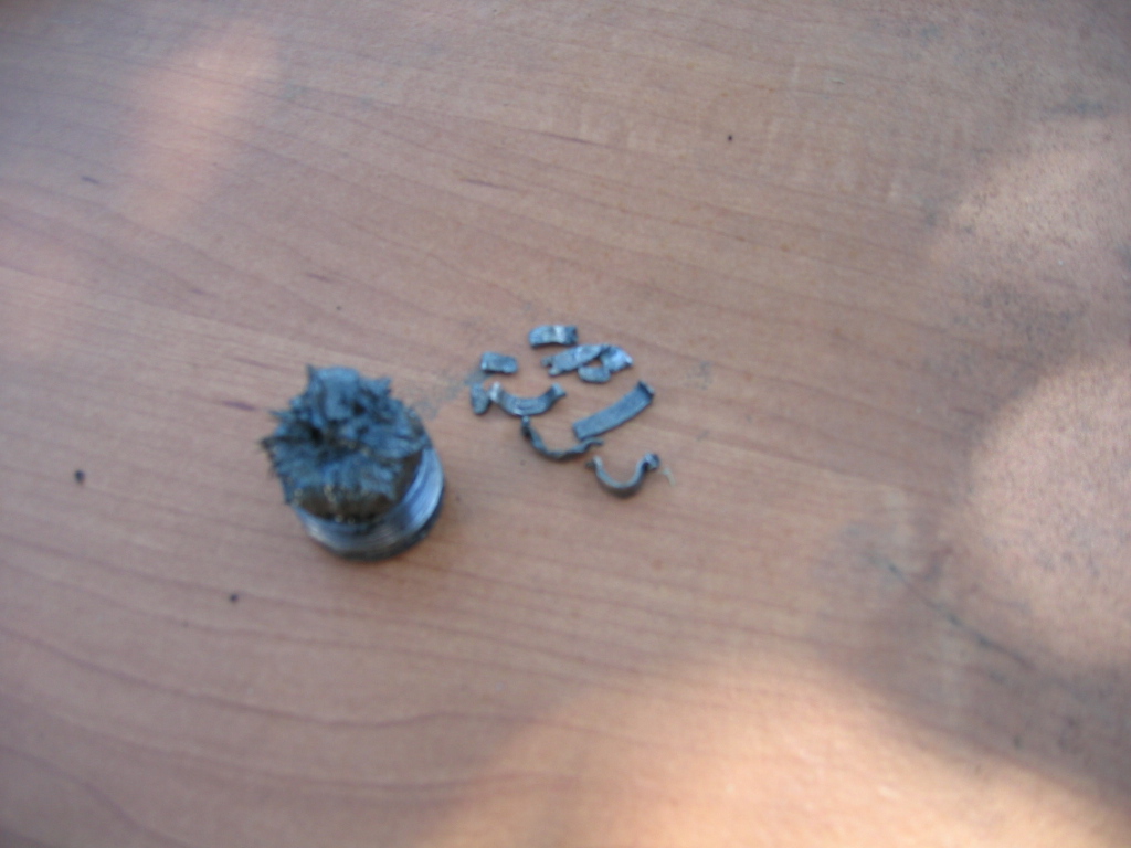

I'm starting a new thread of my previous MT thread because that one got too lengthy.
So, I finally removed the drain cap from the '82 MT and guess what....the pictures speak for themselves.
All those pieces of metal were stuck on top of the drain cap (well, they were all muddy with that old transmission fluid).
Am I correct to believe that this MT is foobar? I stuck my finger in the drainage opening and I was able to pull another piece of metal, so I'm guessing it's a no-go with this MT?
What are your thoughts?

One or more of the bearings is toasted. Yes you can have someone go through it and replace the bearings or try and find another jy tranny and get the same thing. You can also take on the job yourself.
Old Feb 17, 2007 | 05:28 PM
those are parts from one of the main bearings, it could suggest major wear on the other parts as well. its rebuildable, but basically pooched for a directed drop in.
