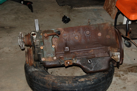

Recently picked up a new OLD Turbo motor out of a 82' at the local junkyard. The motor came complete with everything including transmision, all with only about 80k miles. I was hoping the turbo would be in good shape but it has about 5 feet of shaft play.

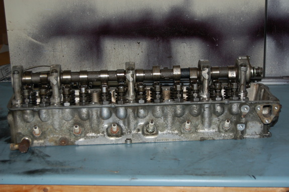

I attached some pictures below, it took me about 5 cans of PB penatrating fluid just to get that far. It may be pretty dirty on the outside but like my motor, the cylinder walls are in excellent shape, they still have all the cross hatching all the way up the cylinder. And the head is in good shape too.
The reason I started this thread was to get some suggestions. I definately want to do something with this motor but not sure how crazy I should go, its going to be a long project.
I was originally thinking of doing a 3.0/3.1L motor but its getting hard to find a LD28 crank for cheap. Or myabe just throw some forged pistons in it and call it good. As for the head either way I want to invest most of the money here. Theres a guy over at HybridZ that does some awesome head work, Ill probably talk to him. That and a different cam too.
Is there anything else I am missing? I can put together a dirtbike motor no problem but not sure if this is something I can handle? But after reading the FSM it seems pretty straight foward.
Also seeing as as Iv never built a car motor before, what should I have the machine shop do when the time comes. I was planning on having them clean and balance everything, but not sure what else should be done???

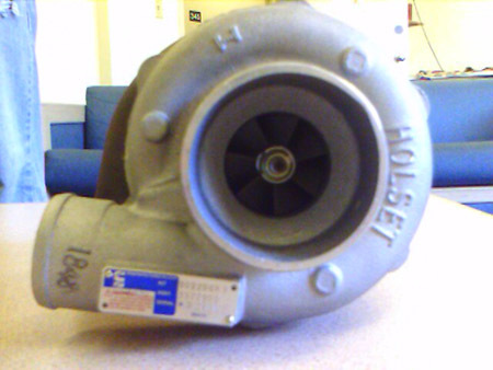

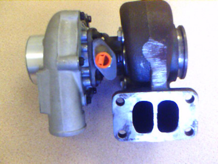

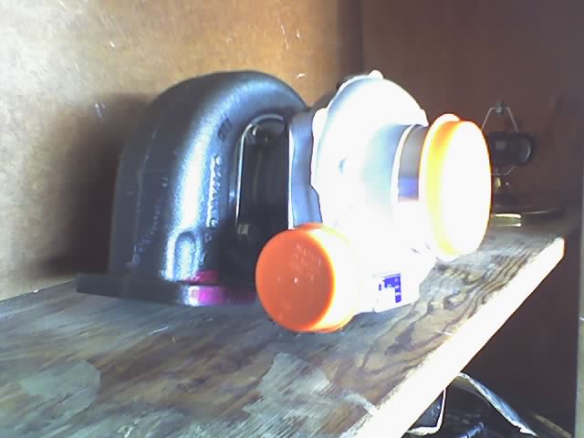

And last but not least I also just bought a new Holset turbo, I attached some pics of that too
Thanks in advance for any help or suggestions
