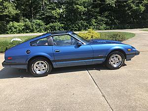

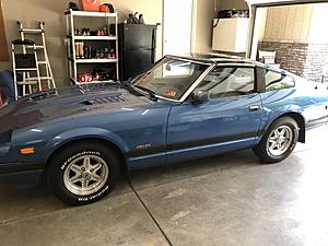

Hello,
I purchased an all original 280ZX yesterday from the original owner's brother. The owner passed away late last year and left the vehicle to his brother. The brother was ten years old back then and remembers going with him to pick the car up new. It had 14,995 miles when I picked it up in West Virginia and now had 15,420 back home in Indiana. I averaged nearly 30 MPG coming home.
The car is essentially new throughout. The younger brother was telling me that nobody was allowed to drive the car and it truly was his baby. On the way home I noticed the cruise, hazzards, and Voice Warning system did not operate. Also, when pushing the button for the self diagnostic the low water indication illuminated with the display staying red after. Fixing the water indication was easy - just add 50/50 coolant to the reservoir tank. After that it went through the check and gave the "OK" display. There appears to be no coolant leaks or any fluid leaks for that matter.
The Cruise system was easy to fix as well. I noticed the clutch had some slop and figured the clutch switch was not closing. I read some good information here and then pulled out the Haynes Manual the owner gave me. I first made sure the adjuster was 6 3/32" in adjustment. I then noticed there was way too much play in the pedal before engagement of the clutch. The push rod lock nut had worked loose and the rod was out of adjustment. I set all dimensions according to the manual and verified switch actuation. Took it out for a drive and the cruise worked perfectly.
The Voice Warning System was a simple fix. I simply plugged it back in
I assume that the former owner did not like the system. It amazes me that a plastic record player will still operate after 36 years!
The Hazzard switch appears to be the culprit for the system failure. The turn signals work, and when the hazzard switch is activated it shuts off the turn signal like it should. If you very carefully position the switch just right the hazzards will work. Any suggestions where to get a replacement switch? Also, the rear hatch shocks are original and need replaced. Need to source a pair of them.

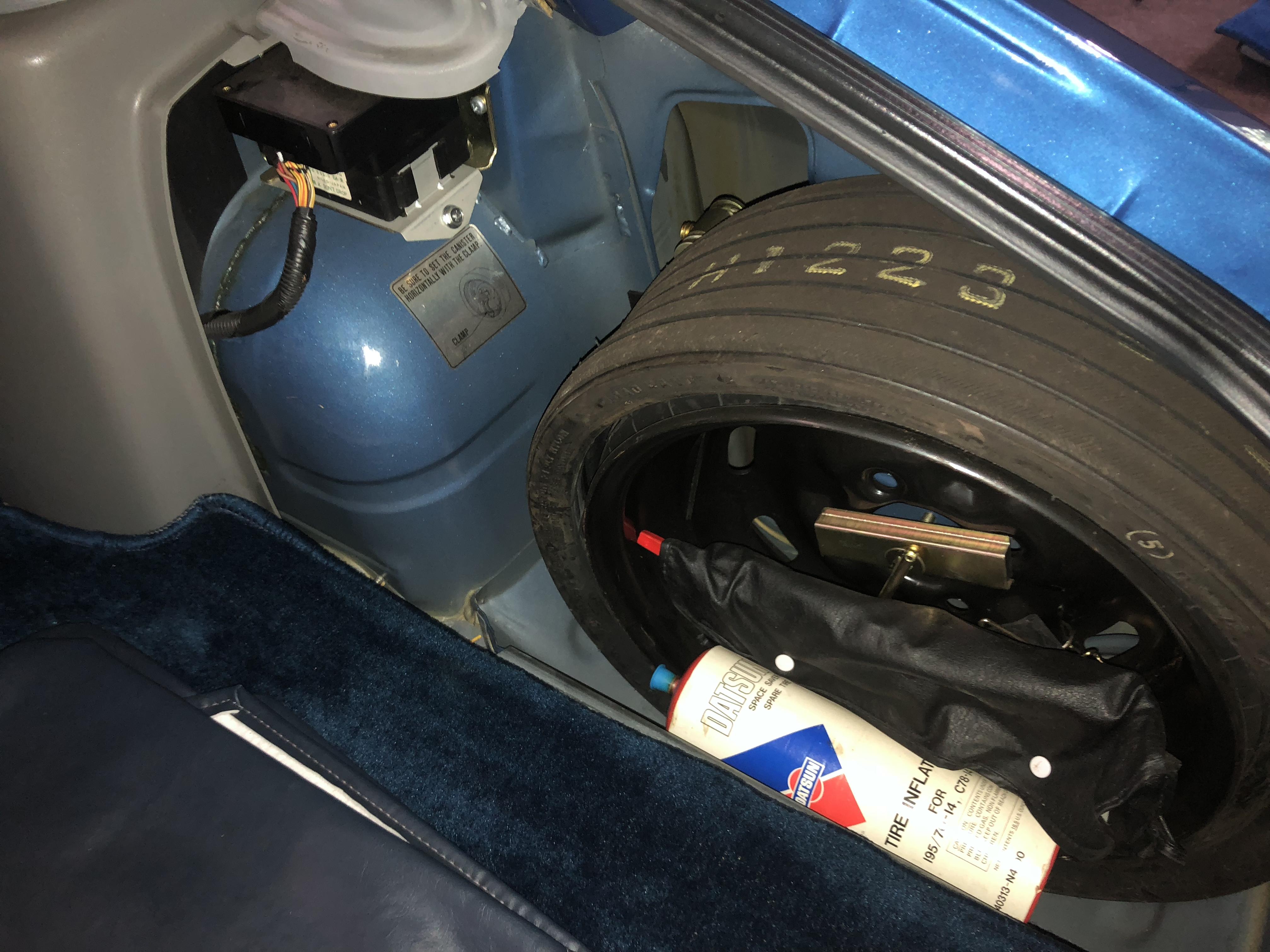

Other than those small items the car is perfect. The A/C is ice cold, all lights work, body is perfect, interior is perfect, and the underside of the car looks like it came from the factory. Even the power antenna works correctly in full extension and intermediate position. Also, the spare tire, jack, and even the tire fill can is right where it should be.
It is amazing someone could keep a car this nice over the years.

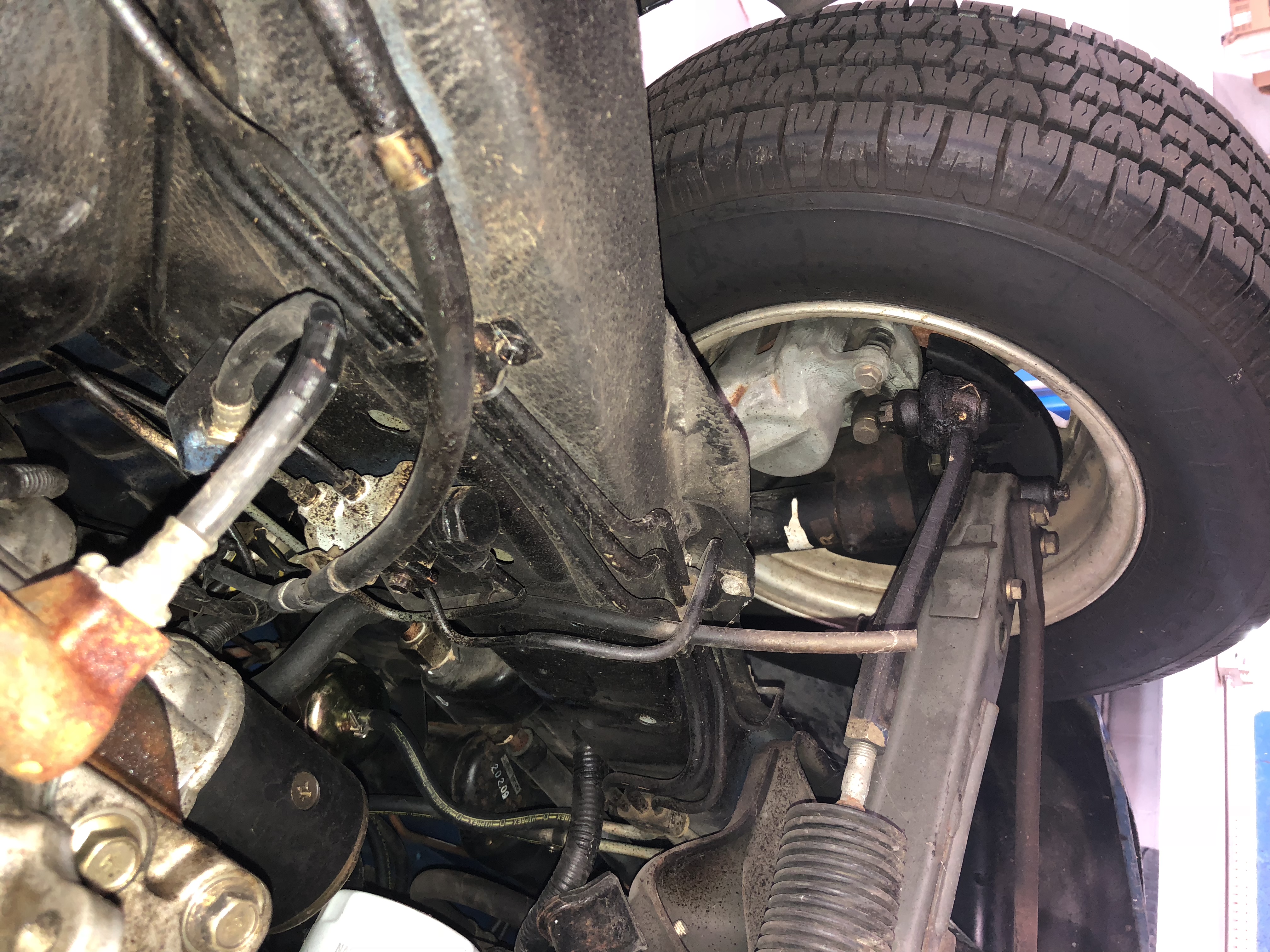

Some more information. Found the coolant leak that was causing the low coolant message. Radiator drain plug was leaking, so in my infinite wisdom I cranked it about a quarter turn and broke it off in my hand, lol. Have a new one coming today. Also, the radiator hoses are original, so I ordered new ones. I thought about replacing the hoses that run parallel to the block and into the heater core, but it appears that the hoses going to the core actually go through the firewall and I don't want to remove the dash to replace the hoses. Am I correct on the heater hose change out?

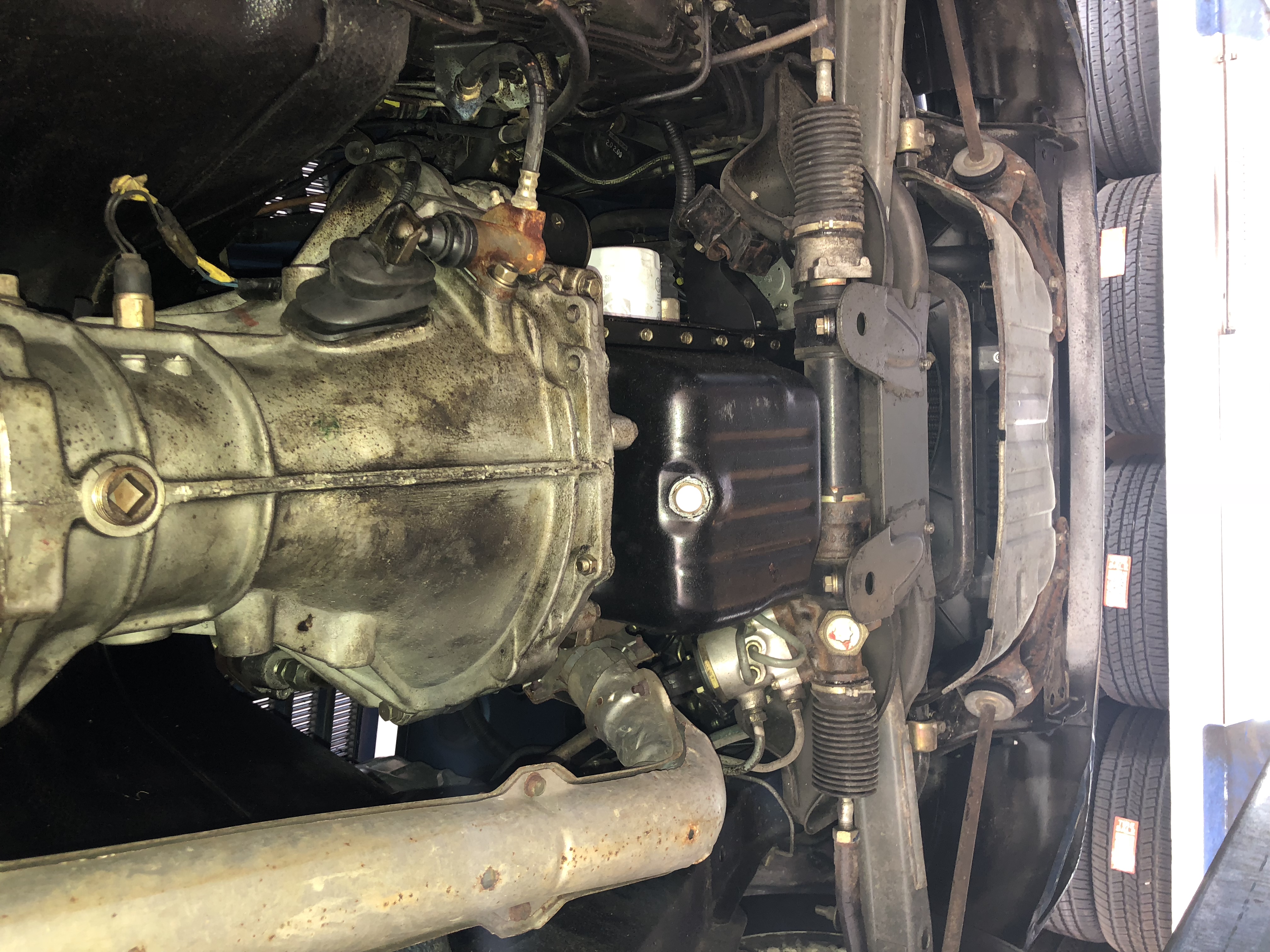

Other than that, I am going to change the transmission oil with Red Line MT-90 and differential with Red Line 75W-90. I also decided to turn all 4 rotors and re pack the wheel bearings. I also found the clutch hose under the right side behind the front wheel was a little chaffed, so I have a new one coming as well. Lastly, the original muffler had a small hole in it, so a new one is coming as well.
