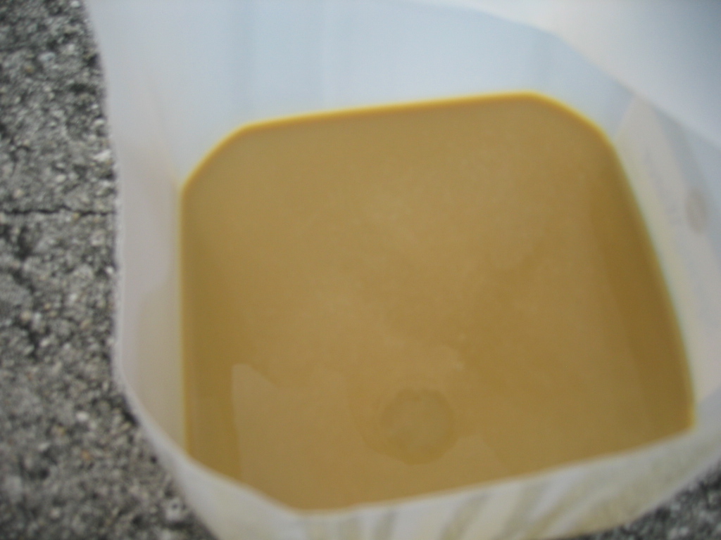

Now, I also have an issue with the way the oil looks. I was able to get the engine started for less than a minute (more like 30 seconds) and when I pulled the oil dip stick I found something odd with the way the oil looked.
If any of you don't mind following this link, I took a picture of the oil dip stick and then I poured some of it on my fingers, and the oil looks weird. Now, I don't know if this is normal on rebuilt engines/heads.

Old May 7, 2007 | 10:42 AM
need... to... focus... camera... better... Is it foamy?
Did you take a look at the ones with the oil on my hand? Yes, it's foamy.

From: Concord, NC
man that sure looks like coolant mixed with oil...I hope I am wrong.
Oh man, don't say that...
Well, I checked the radiator and I didn't see a loss of coolant fluid, but I don't know.

That really isn't looking too good to me, but then again I dunno. I found something like that inside the radiator of my van when it almost overheated, but it was just like a little bit that was floating on top, and the oil on the dipstick looked fine. 200+ miles later, the van is still running fine not smoking or anything. So just do this now, Do a compression check and see what happens.

looks like coolant to me too.

Yeah, I think you guys are right
I removed some oil from the engine and this is what came out...
Well, at least I can go back to the guys that put the engine together and have them take a look at what they did.
Such a bummer...

You had peanut butter in your crank case?!?!?!?!?!?!?!?!?!?!?!?!?!?!?!?!?!?!?!?!

Well, I got my engine to start yesterday. It ran for 20-25 seconds; I cranked it four times.
On the first attempt (after priming it), I checked the oil and it was foamy and yellowish.
So, yes...I have to go back to the shop that put my engine together and have them take a look at what's going on. I'm sure something they didn't do right is causing the coolant to leak in the engine.

You have the death mayonaise my friend. time to call the BBB if the shop gives you any trouble. BAR too.

So, I found what the problem was...the four coolant seals on the head were not properly tighten, so they were leaking coolant to the head.
According to the shop that built my engine, I should not have any issues because I didn't run the engine for too long (which is the case).
I tighten those seals, changed the oil and oil filter twice...turned the engine back on and it ran for a bit longer this time (close to a minute), and I looked at the oil dip stick and it was nice and clean.
I shut off the engine because my oil pressure gauge still not working, and I've been checking the level of the coolant.
Now, I'd like to get your opinion..will this mix of coolant/oil damage any of the interior components of my engine; should I send it back to those guys? The guys at the shop were cool about it and they guaranteed me that the engine will be fine. They did give me the option to take it back to them.
When I had this freak mixture..I started the engine 4 times, but in these four times the engine never ran more than 30 seconds.
