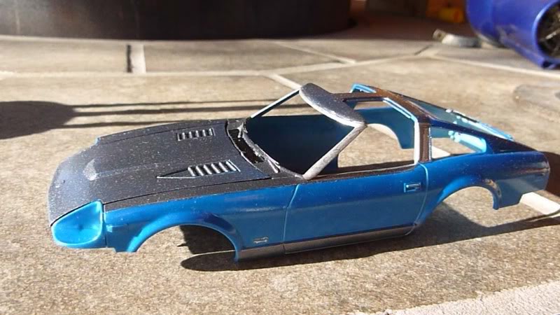

Old Apr 2, 2012 | 09:02 PM
  #46
evandubya's Avatar
Primer Grey FTW!
Joined: Jul 2010
Posts: 587
From: hawthorne, nv

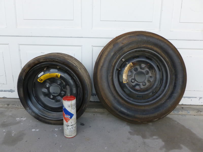

The above model is how I'm going to be painting my car soon. I've finished most of the interior, I'll post pics when it's finished.
I was told if you inflated the spare it blew up the same size as a regular tire, it worked! There is a fold in the tire and then it balloons out he other way. Most of you probably knew this, but it impressed me enough to post it anyway. I was terrified the thirty year old tire was going to blow up in my face, the uninflated (not a word, Google it) one has a huge crack in it.
Old Apr 3, 2012 | 04:48 PM
  #47
Trex's Avatar
Joined: Nov 2011
Posts: 72
From: Reno, NV
I actually didn't know this O.O next time I blow a tire I'll have to try to use my ancient tire inflator to inflate my ancient spare. Sounds like fun!
Old Apr 3, 2012 | 05:37 PM
  #48
evandubya's Avatar
Primer Grey FTW!
Joined: Jul 2010
Posts: 587
From: hawthorne, nv
I didn't use the Datsun can, just an air compressor. The spare in my '79 has 2 valve stems, does anyone know why?? The BOV is an Ebay special.

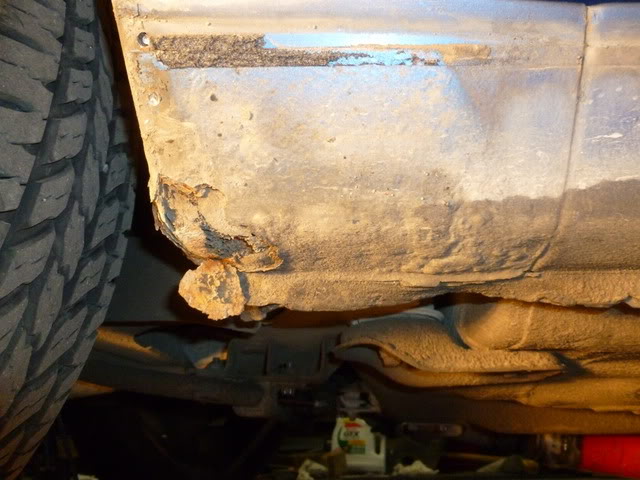

update, the turbo has made noise when it was cold. So I took it apart, the little thrust bearing was plugged with carbon. PO must have turned it off hot a lot. Left CV axle is going out so that's being rebuilt. Paint prep is going ok, got the lousy trim pieces off the sides now I have to fill up the holes. Huge rust spot under the aluminum trim at the bottom will cut that out soon.
Other than that can't find much body work to do, YAY!!!!!!!!

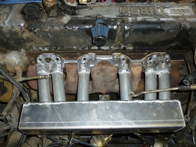

I got my new intake mostly welded up, with my new TIG welder. If there is any interest I might make a few to sell.
Got the band rust spot cut out, didn't have any metal to put in its place so I got some today. Everything is coming along well!!
